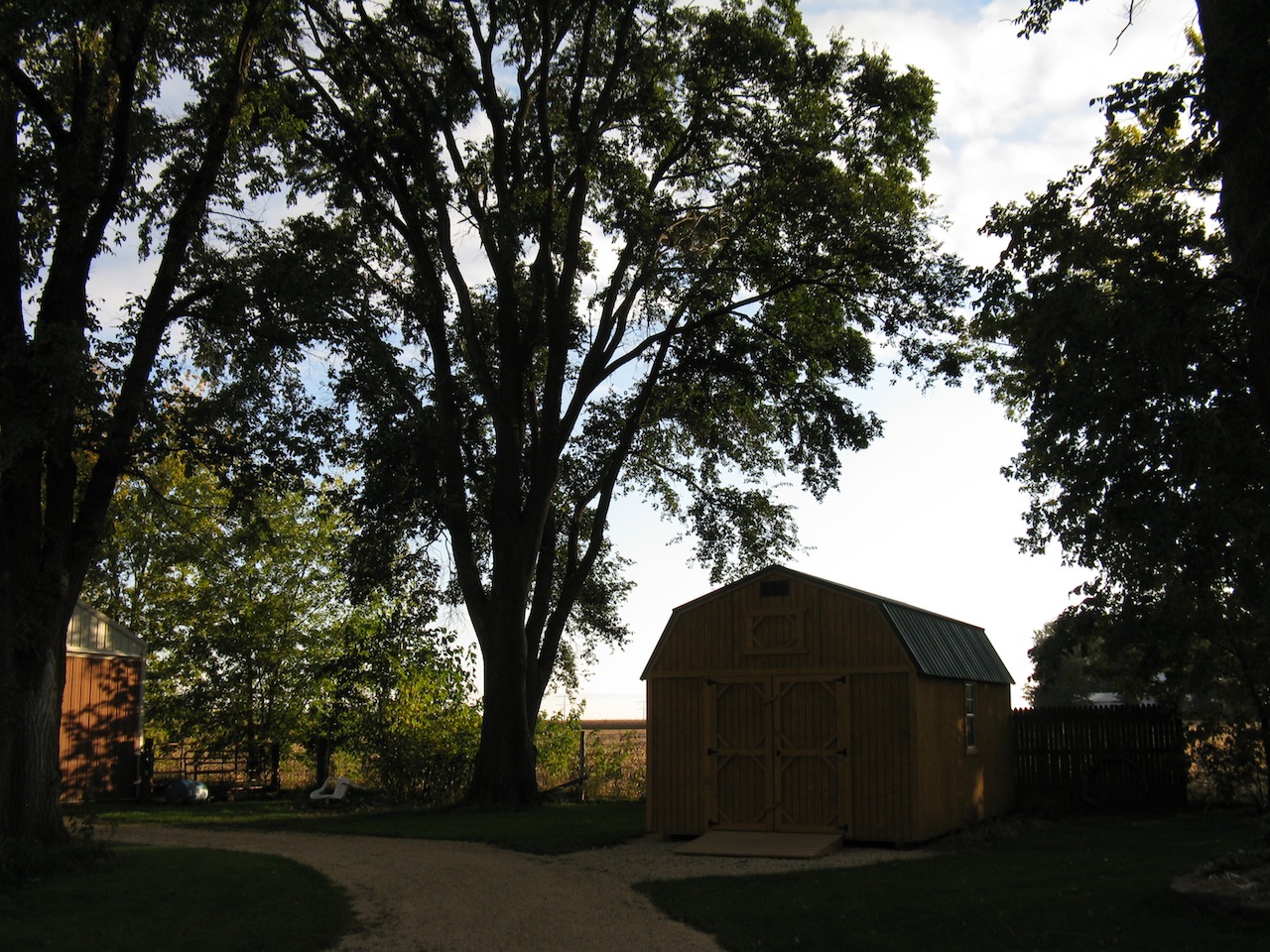

Tree that we will hopefully be taking down on Saturday provided the wind is from the right direction. Picture doesn't show it but the base is all hollow so I want to fall on my time frame and not have mother nature drop it on one of my buildings. Measures approx 40" in Diameter at the base and is one of 5 trees this size on my place and my son's have several more this size. Trying to convince them the "old man" shouldn't be looking at buying saws this big, this is younguns work :)

Beware of hollow bases, susceptable to barber-chairing as there's no core to hold the tree together as it leans and it can split right right up the trunk and break off over your head. Very dangerous. After making your wedge, instead of making your cut straight in from the back, use a bore cut to leave some fibers attached at the back so the tree doesn't tip while you make your back cut to the hinge. Don't cut the hinge. After you leave a hinge, then cut the little tail (strip) you left when you made the bore cut. Only then will it start to fall as you run like ****.
And/or put a chain around the trunk above where your making your cut.

I agree I am not fond of cutting hollow rotten trees. To darn many unknowns besides the barber chair like, Bee hives, mad raccoons, really irritated squirrels, etc..
