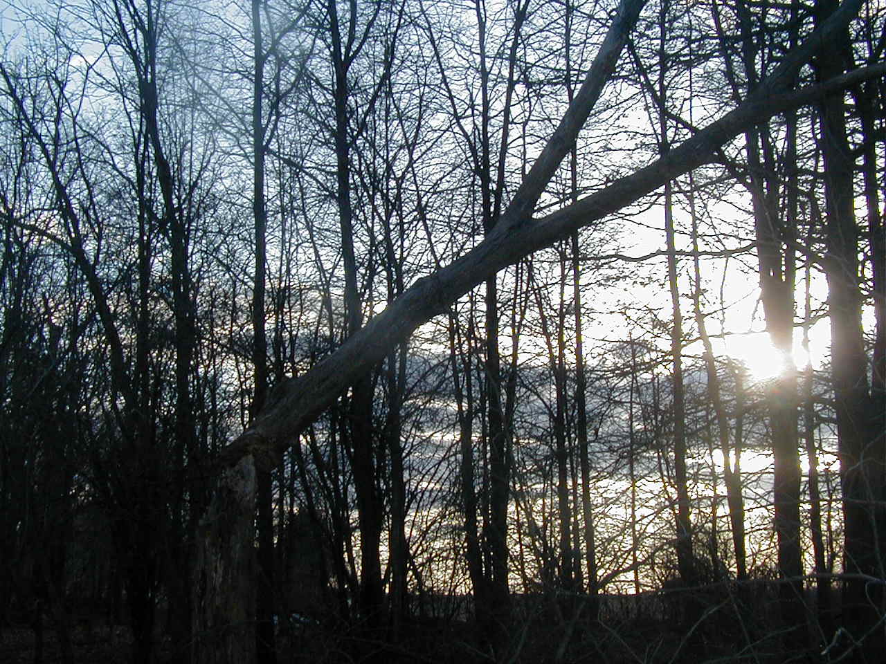

I have this hung tree in my yard. It has been there for some time ,even though it looks precarious. I think cutting the stump would be too dangerous and I have tried pulling it off with the tractor but so far no luck. Any idea?

Agreed, the tree could jack knife towards you when you cut the stump at ground level.
Have you thought of preventing that by keeping tension on it with the tractor while holding the saw on the other end of the stump ?

Can't really tell if tree free from stump,if so how about fasten long chain near base of tree to 5or10 ton come along...work from safe distance.

I have had trees in the same shape.
If you cut it at the bottom(it will snap back at you) but probably won't fall because it is hung in the other tree. I have cut them like that, and when i started cutting the tree it split and jumped backwards real quick, and on another one it went sideways.(they are real dangerous like this and have a lot of pressure on them) I have had as many as 3 at a time on each other.
I know it would be hard, but if you could try and get a strap up towards the top and use a red devil or tractor and try to pull it that way without cutting it, but have plenty of slack so it won't fall on you.

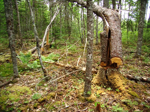

Found a picture of one the hung trees. there were about four more in this bunch. After notching and waiting for a few days they fell down. I could not access the area with the tractor with the trees hung up.:D

JimmyJ the good Lord has just been watching over you if you haven't had any barber chair on you yet. The tree is tensioned the way it is now. It is hard to see from that photo if all of the tension is at the top of the tree where it is hung up forcing the tension to go in an arc under the tree. Or if the root ball is holding most of the weight and the tension is on the topside of a the tree. Plunge cutting might work to decrease the barber chair scenario. What I have done in the past is wrapped a strong cable around the base below the cut. Then taken the cable above where you are going to cut. And then used cable clamps to make a very short leash on the tree. If it tries to spring up or any direction the short leash on the cable should stop it.
Another method we use is sling shot a line over the tree as high as you can. Then pull a large rope or cable up and over. Bring the end back around to make a loop. Attach your rope or cable end to people or a tractor and see if you can pull it out of the branches. Just don't wrap the rope around your wrist if you use people to pull it.. Rope burn hurts like heck! :eek:
Looking closer at the picture it looks like it is resting on the stump maybe with a little hinge wood left. If you can get your cable up next to the break. Wrap the cable around that and pull with the tractor from a good distance. That should remove it's resting point and maybe let the butt come down. Chances are the top will still be hung.

Based on the avitar this guy has a bunch more experience than me, but my first move would be as he's instructed. I'd get a rope or cable around as high as I can and then pull sideways out of the branches, I've done this a number of times and seems by far the safest. I've not had one so stuck that I could not get out.
Another thought might be cutting down the tree it is hung in?
End of day, safety first, these lumber guys will tell you that there is a bunch of stuff that can go wrong with trees, this is like high tension stuff, best leave the tricky stuff to the pros.
