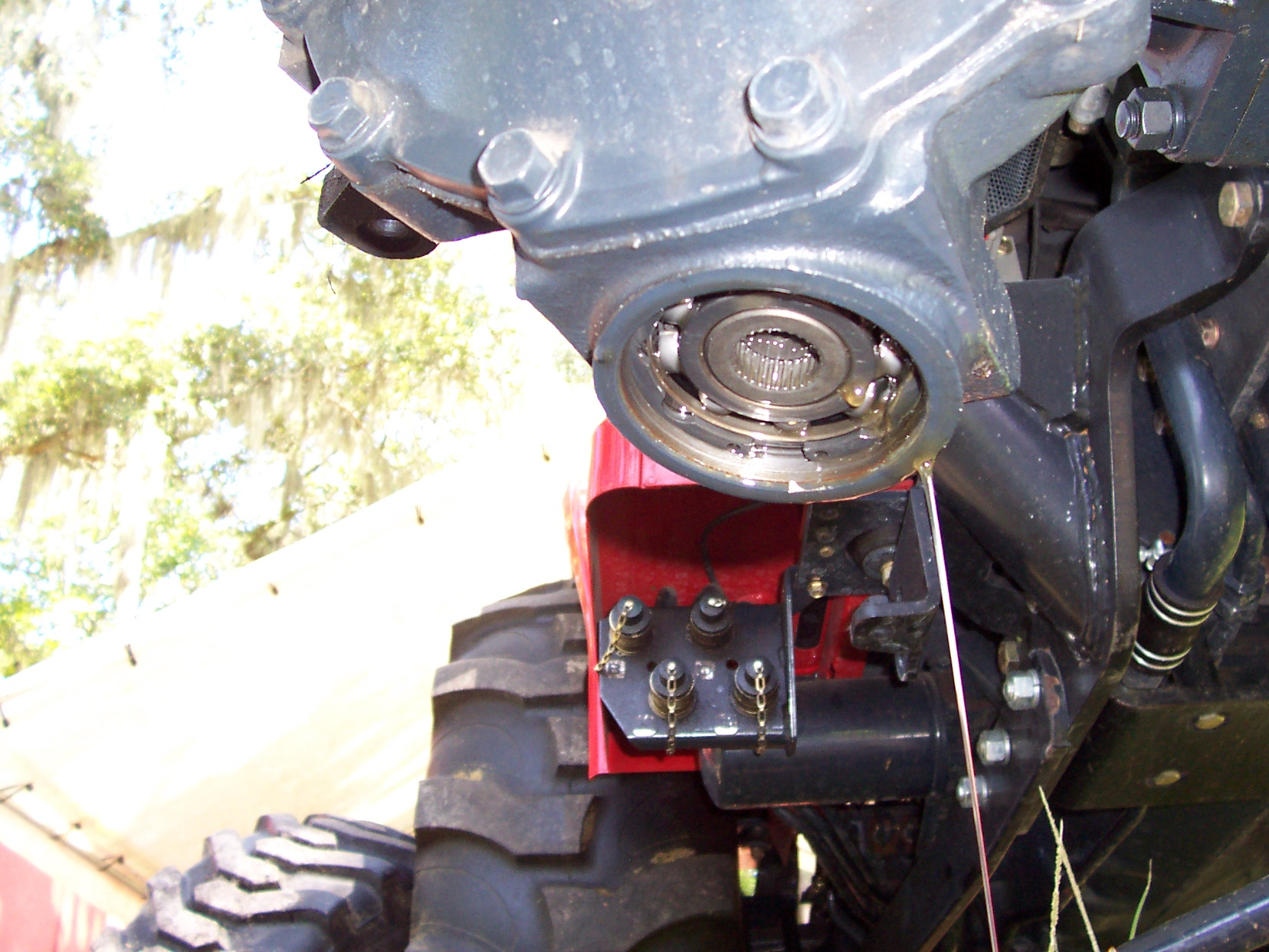

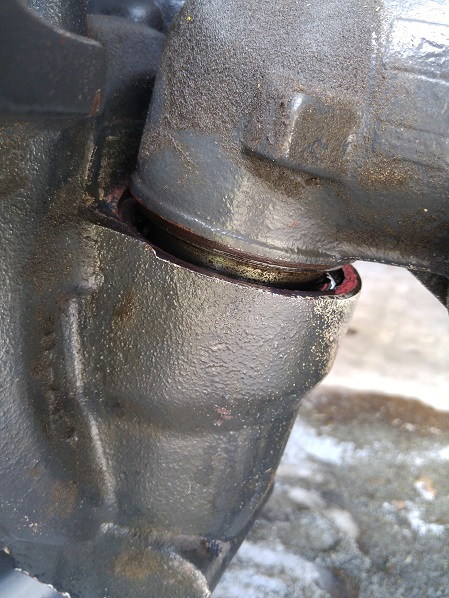

Just replaced front axle seals on my MF 1428V. Or at least I attempted to...went smoothly following the instructions in this post. However I cant get the axle hub to fully seat at the top gasket seal where it sits inside the axle. See pics attached. I ordered correct parts from the dealer. It seemed like a very tight fit before mounting. I inserted this gasket into the hub assembly first..and I have the beveled edge of the gasket up like it should be. Is there a trick to getting this inserted?...tried all the tricks, well lubed...bearings arent getting hung up...I even put the tire back on in hopes that the weight of the tractor would help push it in and seat it all the way. I did notice the new gasket looks different than the leaky one I removed, were they remanfactured recently?
Anybody else have this issue with similar tractor?

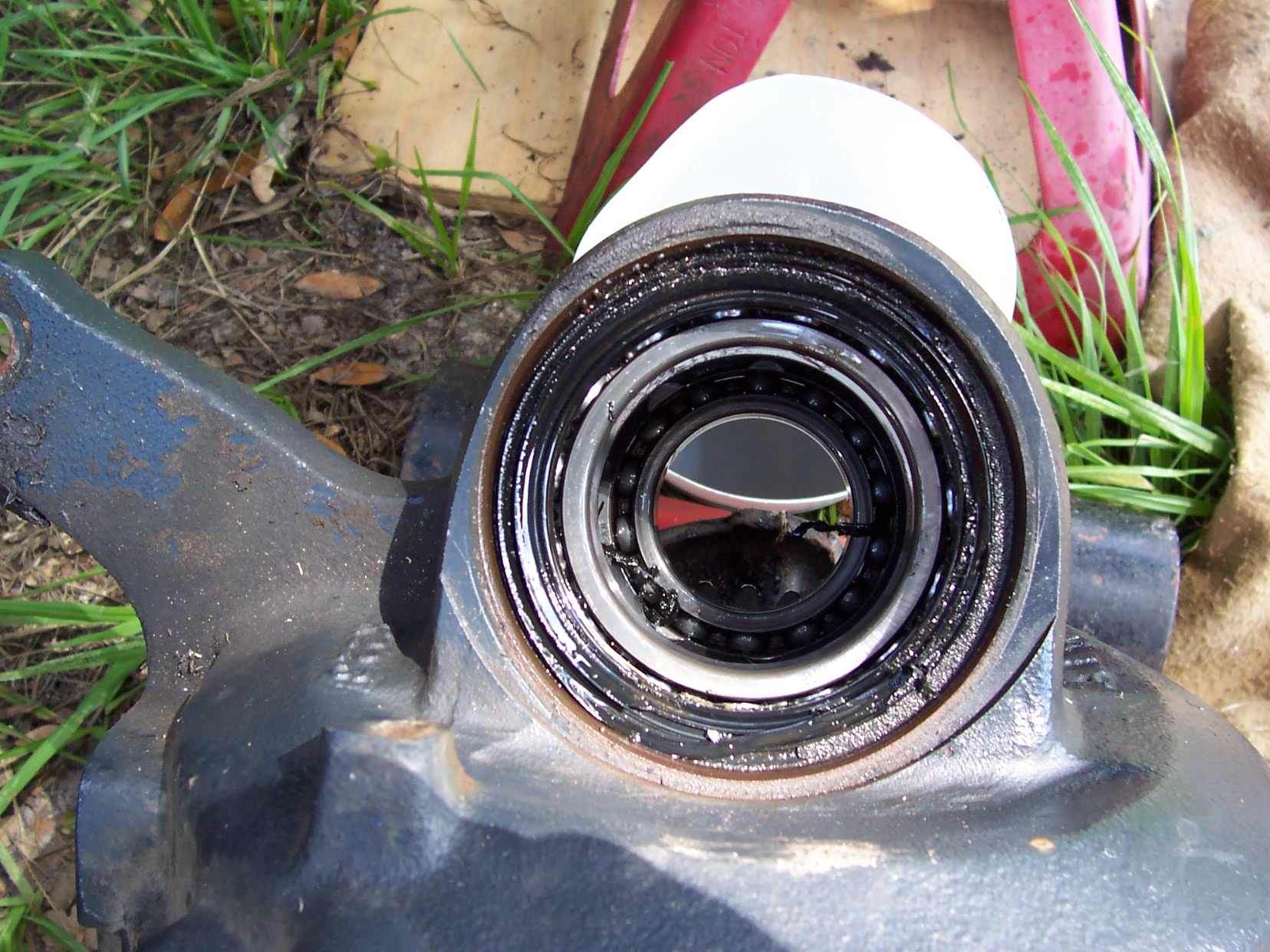

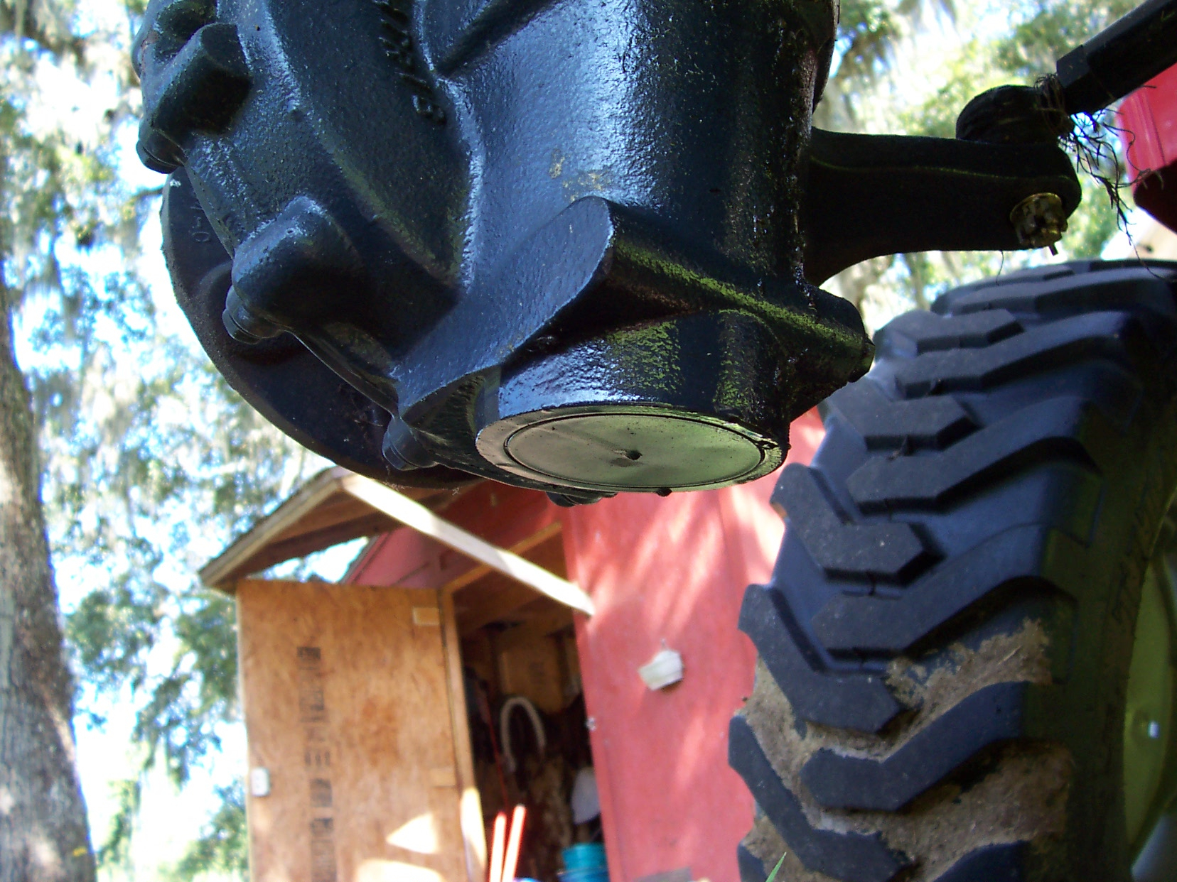

I was asked by a member to see if I could find the photos that aren't showing up in my 1st post... 13 years later, I found them on a CD (lol who says CDs in computers are dead). Photos posted, part 1

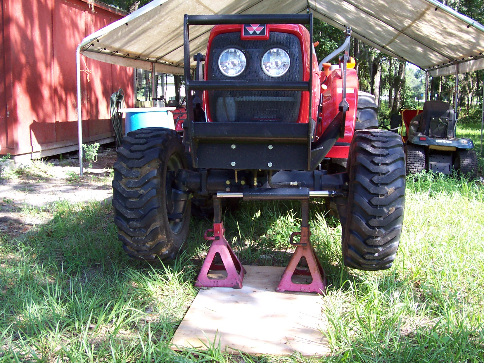

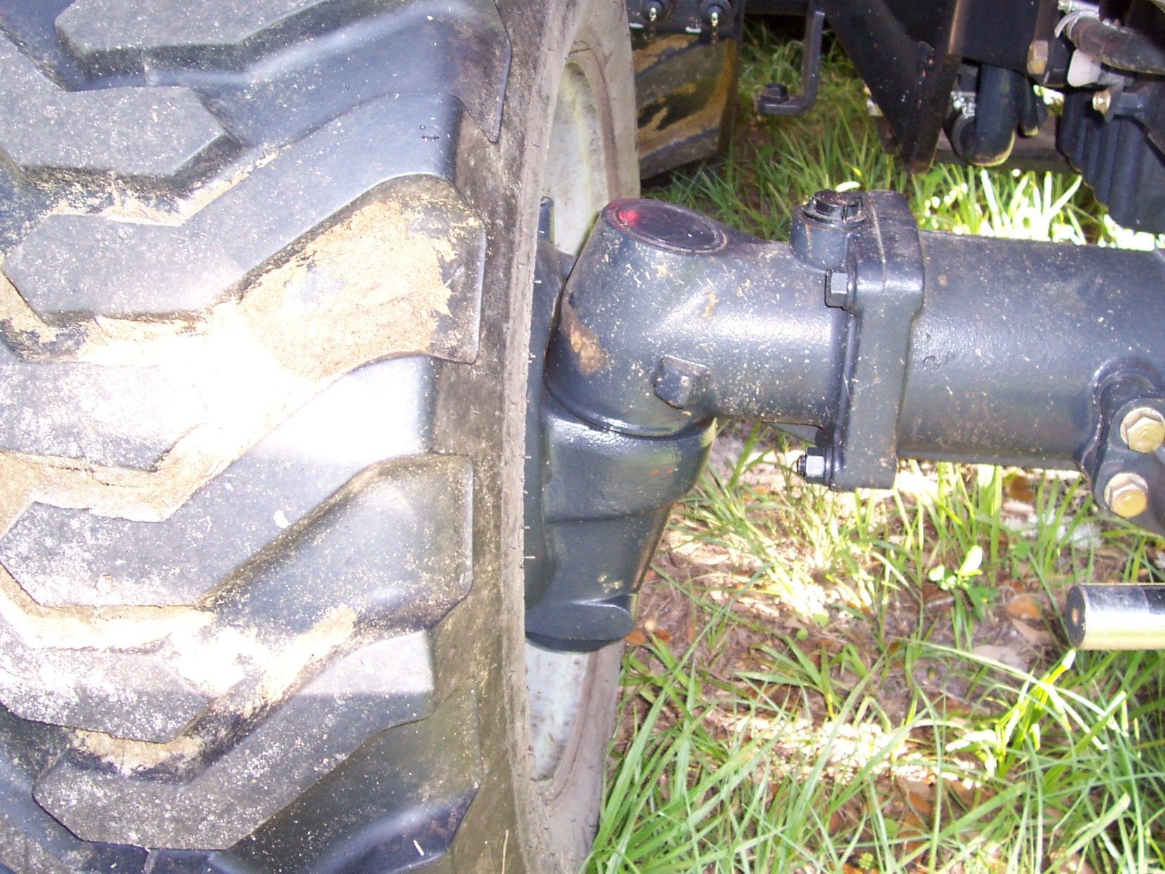

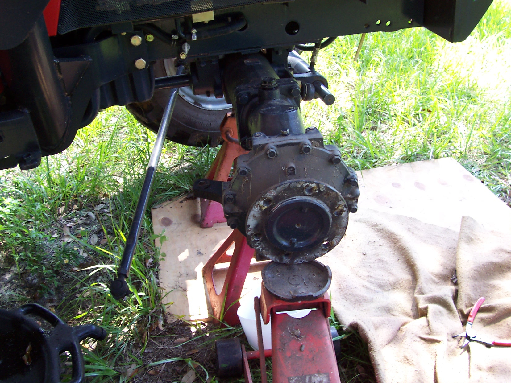

I had a leaking seal on my pass side front hub to axle and I did the job today. I thought I would post some photos to maybe help others with this job. Looking for info on the net to help me out (I never did this job before) wasn't easy, there is nothing about the 1533.
So to the photos, if you have any questions please ask. I "think" I added the words needed to explain each photo.
Parts needed.
Lower cap seal #3758152M1
Hub to axle seal #6240892M91
2gal of Hydraulic fluid
Cotter pin (for tie rod nut)
Hammer, screw driver, 9/16 wrench, 5/8 wrench, pliers, Snap ring pliers (9" or longer, any shorter will not do), impact gun (if your lazy like me for taking off the wheel) with 24mm socket. The tape is there to give a size measurement, its open to 18".

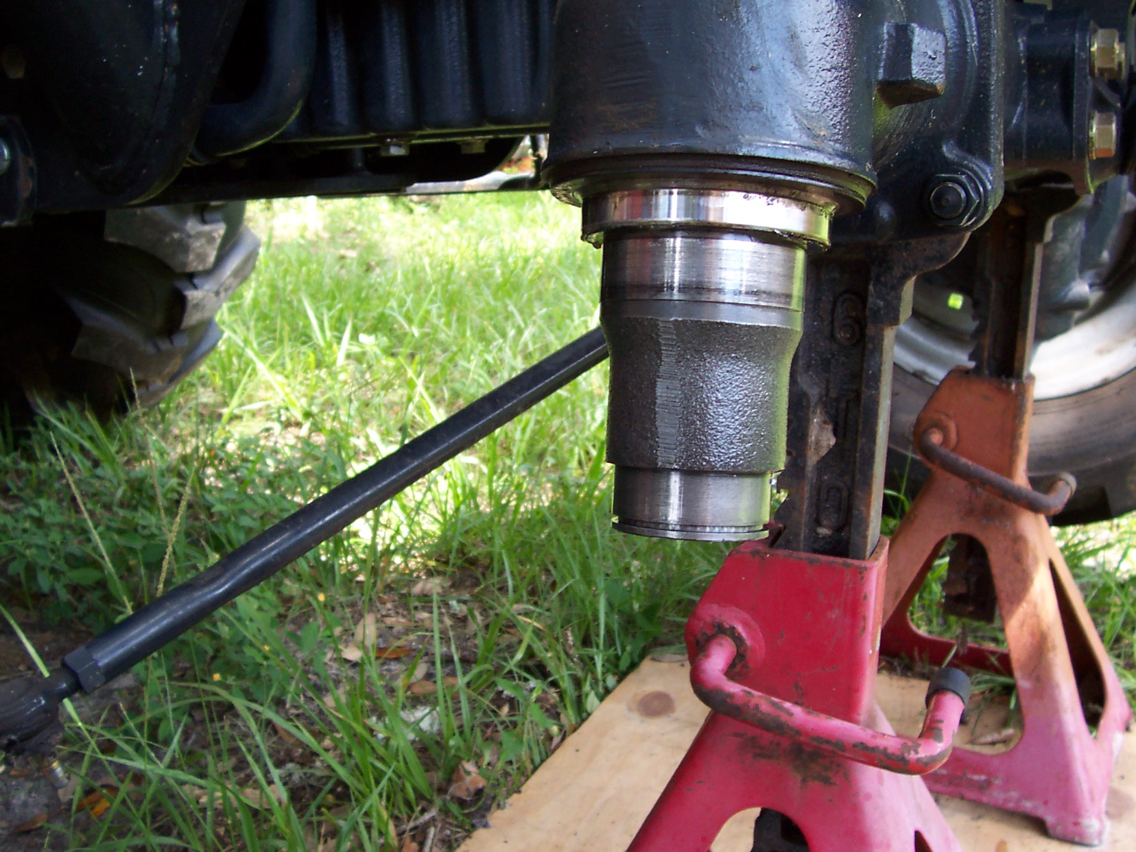

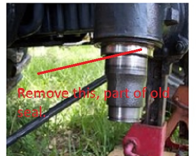

I have a question about the 4266334M91 upper seal.
1) did the original seal also include a speedy sleeve as part of the seal assembly?
this is the part(thin metal piece that seal wears into) that stays on the upper part of the axle when you pull it apart.
This is indicated in one of the pictures.
I am thinking that the original seal changed up to a new style seal and that the sleeve is no longer used.
Can anyone verify this thought.
I say this as there is no part number for the sleeve in the parts diagram.
Normally when a manufacture changes up a part number they put a "C" beside the part number indicating a change?
The post is awesome as are the pictures, just need to verify the seal change and story on the sleeve.

The 'speedy sleeve' is part of the seal. If you look up 5 post I show a photo of the sleeve. I should have posted to make sure you remove it before installing the new seal (I added those photos because some how they went missing from my earlier post). I added a photo to this post just in case you can't see it above. So in short, no, its not new.
EDIT... Just incase I am not understanding 100%. The new seal did have the inner sleeve. It should already be installed in the new seal. Its been a long time, but 'if' I remember correctly, the seal is a 2 piece type, as in, if you hold the inner seal (in this case the sleeve) with your fingers, the outer seal should rotate. Again, its been a long time so forgive me if I am wrong on this.
So with all said, if you are saying the new seal no longer includes this inner sleeve, then it must have changed? I still would remove the sleeve if still on the spindle.

You are absolutely correct Mr Steve, the seal does come with the sleeve all ready installed. Because of the pre installed lube and dark colored I was missing that fact. I used a magnet and it stuck to the top and bottom of the sleeve edge, so indeed metal.
Leaving the old sleeve on the upper housing is going to cause a big problem and needs to be removed.
