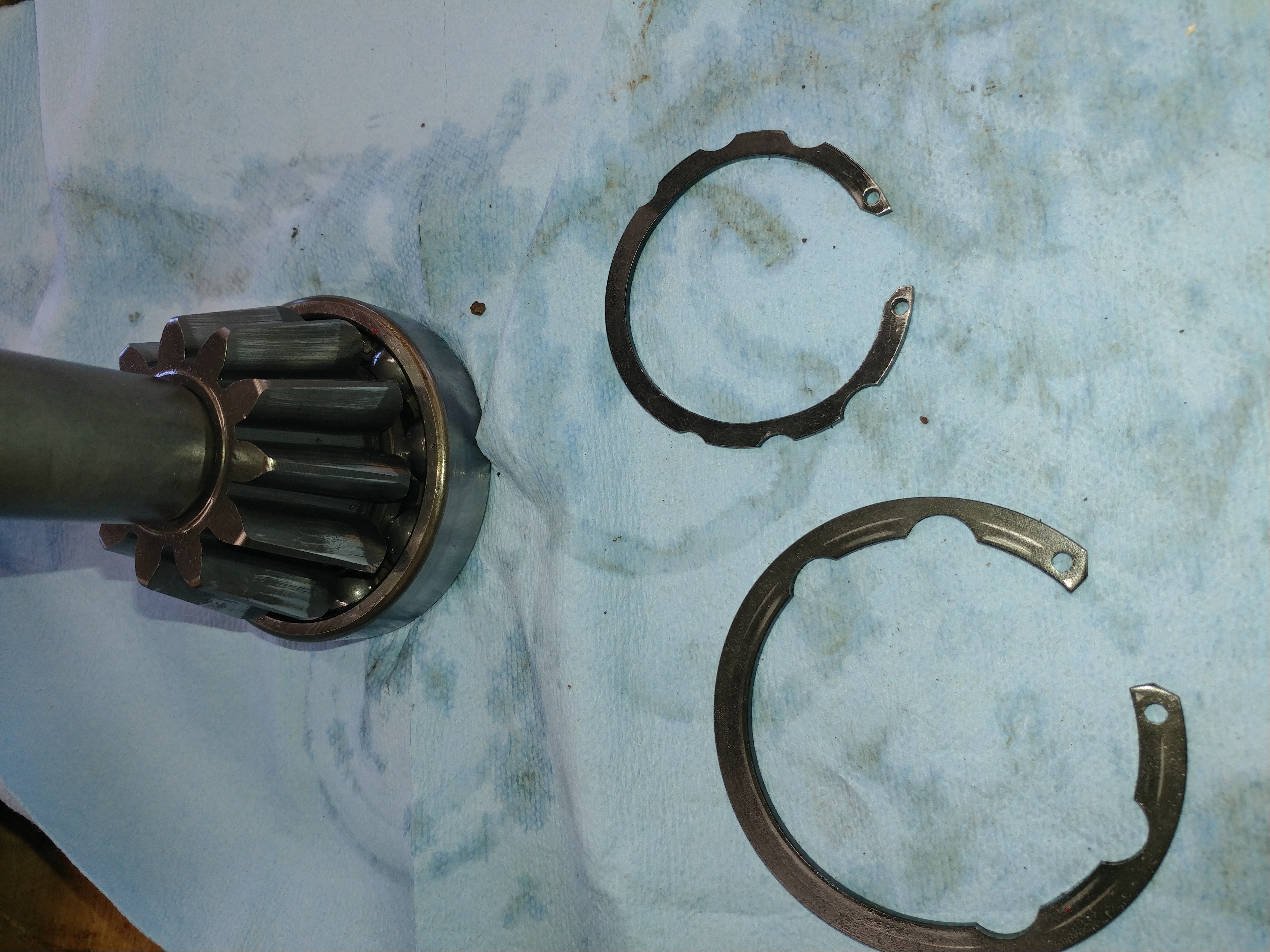

Unfortunately it's a no go, after trying the other side with the same results I must be missing something.. Used the BFH (rubber shot one) and pounded away with zero movement. I have noticed that the outer bearing surface moved freely but the inter stays put. Thought about applying heat to it, but don't wish to either damage the bearing or set fire to the inner workings. any other ideas would be appreciated. Attached pictures to show removed split rings. 20190703_141350.jpg20190703_141549.jpg

Unfortunately it's a no go, after trying the other side with the same results I must be missing something.. Used the BFH (rubber shot one) and pounded away with zero movement. I have noticed that the outer bearing surface moved freely but the inter stays put. Thought about applying heat to it, but don't wish to either damage the bearing or set fire to the inner workings. any other ideas would be appreciated. Attached pictures to show removed split rings. View attachment 611440View attachment 611462
I reduced this photo, look at yours at full size to see what I am seeing...
Did you remove the lock ring with pliers/screwdriver something other then lock ring pliers? The reason I ask, there looks like there is a purr on the drop axle. If this is the case, the bearing inner race could be stuck on that purr and that is why the hub wont drop.

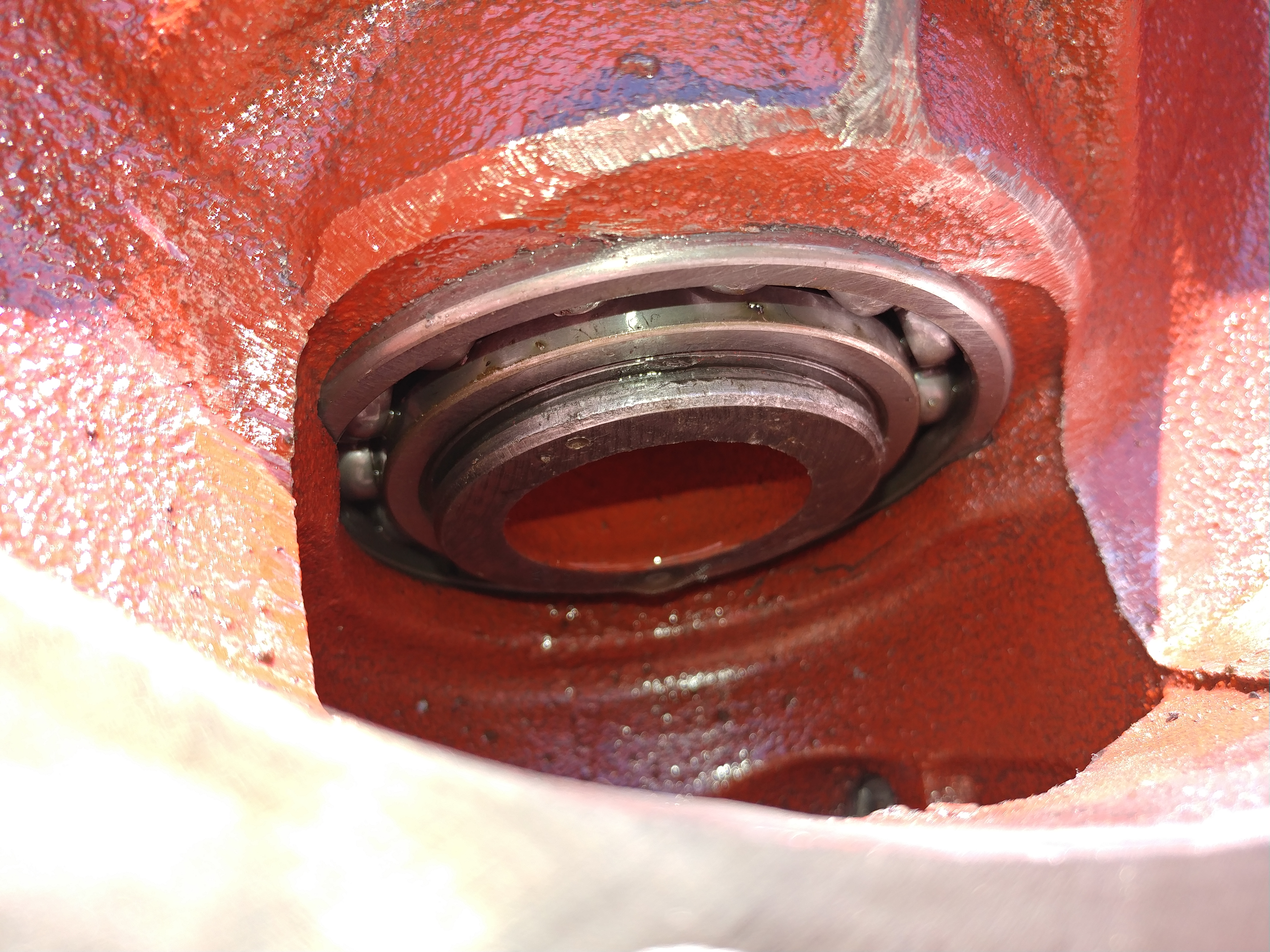

Hello again. Back at it. Not getting very far. I have spent hours trying to pick out the old seal. The new seal seems to be a one piece with a inter metal ring. I cannot make t spin. Seems to be much larger then the first one but I have hacked and cut it up in little pieces you couldn稚 tell. Still no original inter metal ring as far as I can tell.
I need to send pics somehow as I知 sure this has to be completely clean before the new one goes in. I notice everyone else has been able to take the drop spindle out but mine is still in there probably due to the split ring just hanging around the spindle. Lots of debris has fallen inside the bearings and now they grind.
