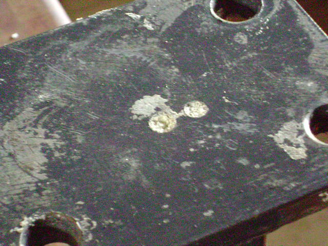

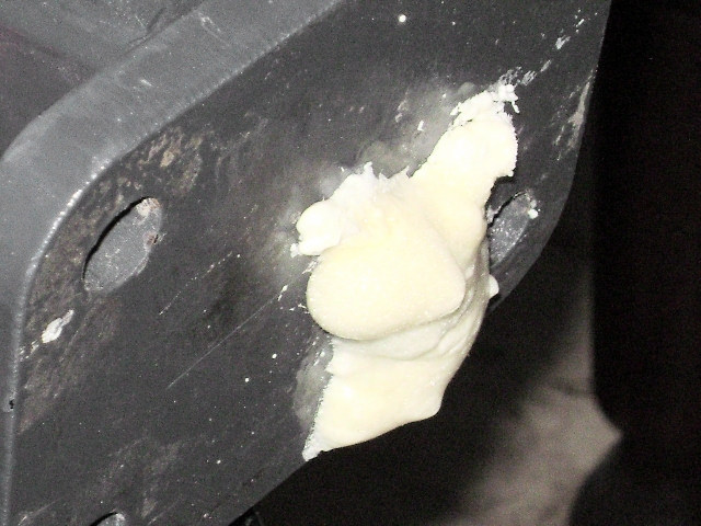

Well here I sit with a busted tractor fan and the dealer won't get another one in untill Monday so what to do?
Well yesterday I took the roll bar off of the tractor as that was the easy part and if I had to pull the tractor apart I might just as well start there. After I removed it an amazing thing happened, I had to move the BX to where I would be working on in and there was no noise coming from the transmission, no wine no nothing, all I heard was the engine. Now I always thought that it was just the transmission that was doing the wining and that there wasn't much that one could do about it but I had never removed the roll bar before.
As it turns out that roll bar is just like a big tunning fork and when your on the tractor your right in the middle of it. So what to do? Well the first thing that I did was to make some rubber pads out of an old inner tube three layers thick to sandwich between the roll bar base and the mounting pads on the transmission. Bolted the roll bar back on and it made a big difference but the wine wasn't gone as the vibration still worked it's way through the bolts and into the roll bar, back to the tunning fork thing.
Somehow I had to deaden the vibration in the bar itself, so what I did was drill a 3/8" hole in the pads on the bottom of the roll bar and one 1/4" hole hole in the center of the bar on the inside top.
I then injected urethane insulation foam with a long 3/8" plastic hose attached to the can into the holes in the mounting pads untill the foam came out of the 1/4" hole on top. I just kept injecting foam while backing the hose out untill I had filled the whole bar.
This morning I reinstalled the roll bar and fired up the tractor, The WINE is GONE, I mean like really Gone. The sounds of silence, or just the sound of that little diesel doing it's thing, It's kinda nice.
Now before the kubota safety police come knocking at my door because of drilling holes in the roll bar , save yerself the trip cuz I ain't letting yuh in. It's my tractor and I can do with it as I choose. Now I'm not advocating that anyone else does this but firstly the holes in the 1/2" thick base plate make No difference whatsoever and if a 1/4" hole in the roll bar top destroys the the structural integrity of the steel in some hitherto unknown manner then perhaps Kubota should look into using a better grade of steel.
So for any of you who just can't stand that incessant wine any more it's just a thought.

I dunno, depends on the beast me would be thinkin. But this is the stuff I used and I had lots left in the can, It's just something that I had on hand and it's a 30 ounce can. Think about it almost two pounds of foam is a lot of foam.
Now thinking about it silicone sealant would be even better But would cost a lot more
