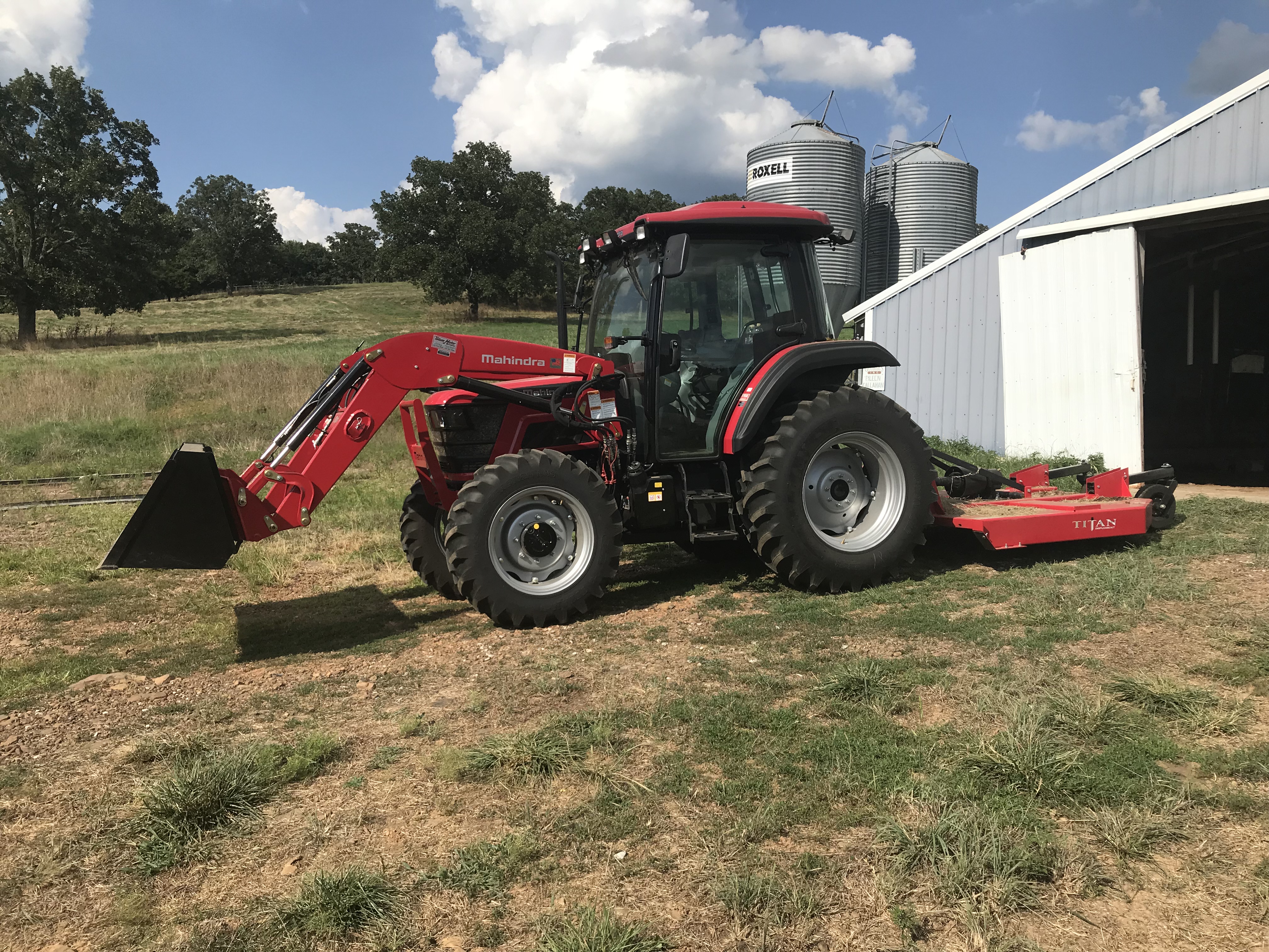

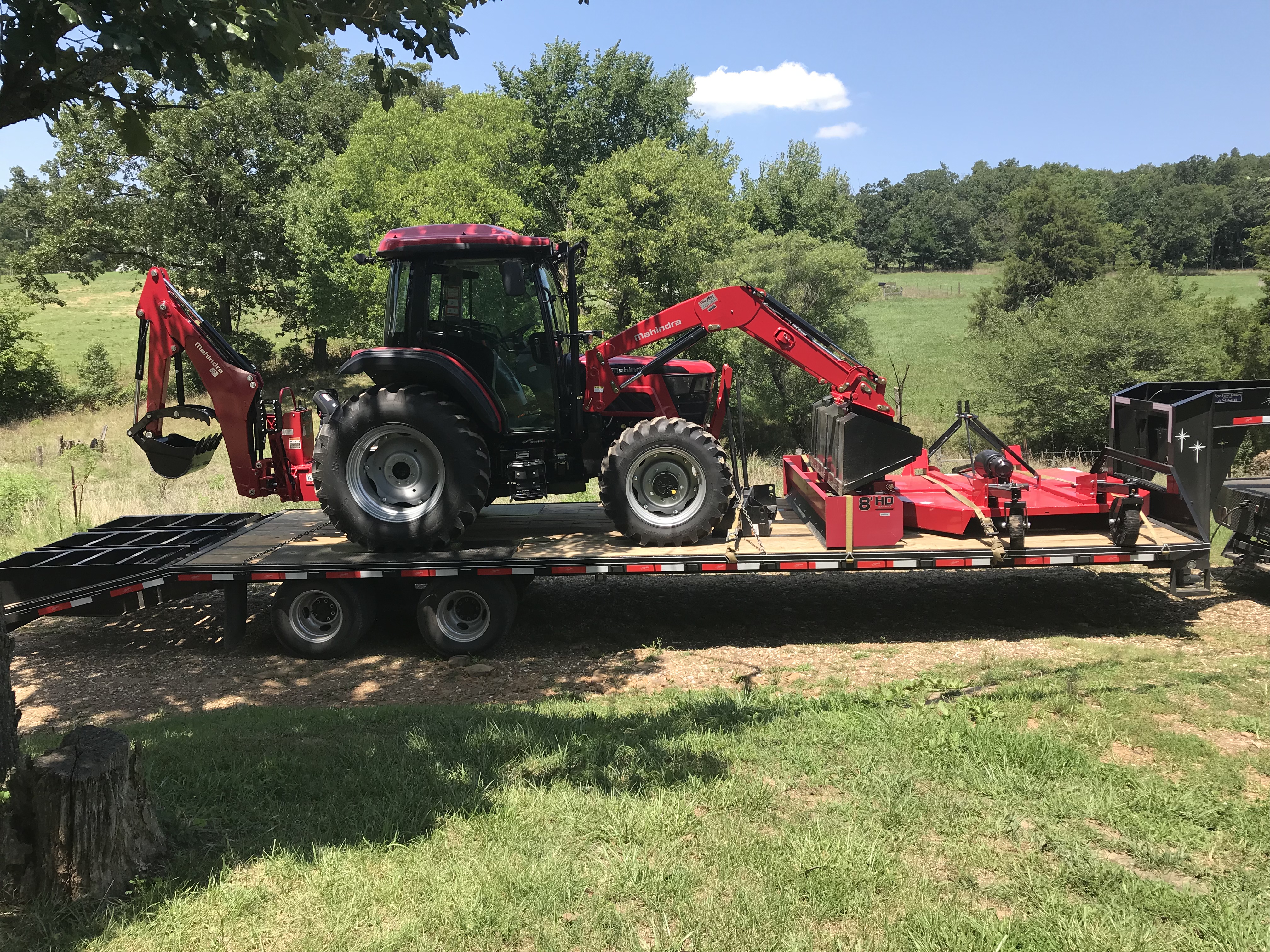

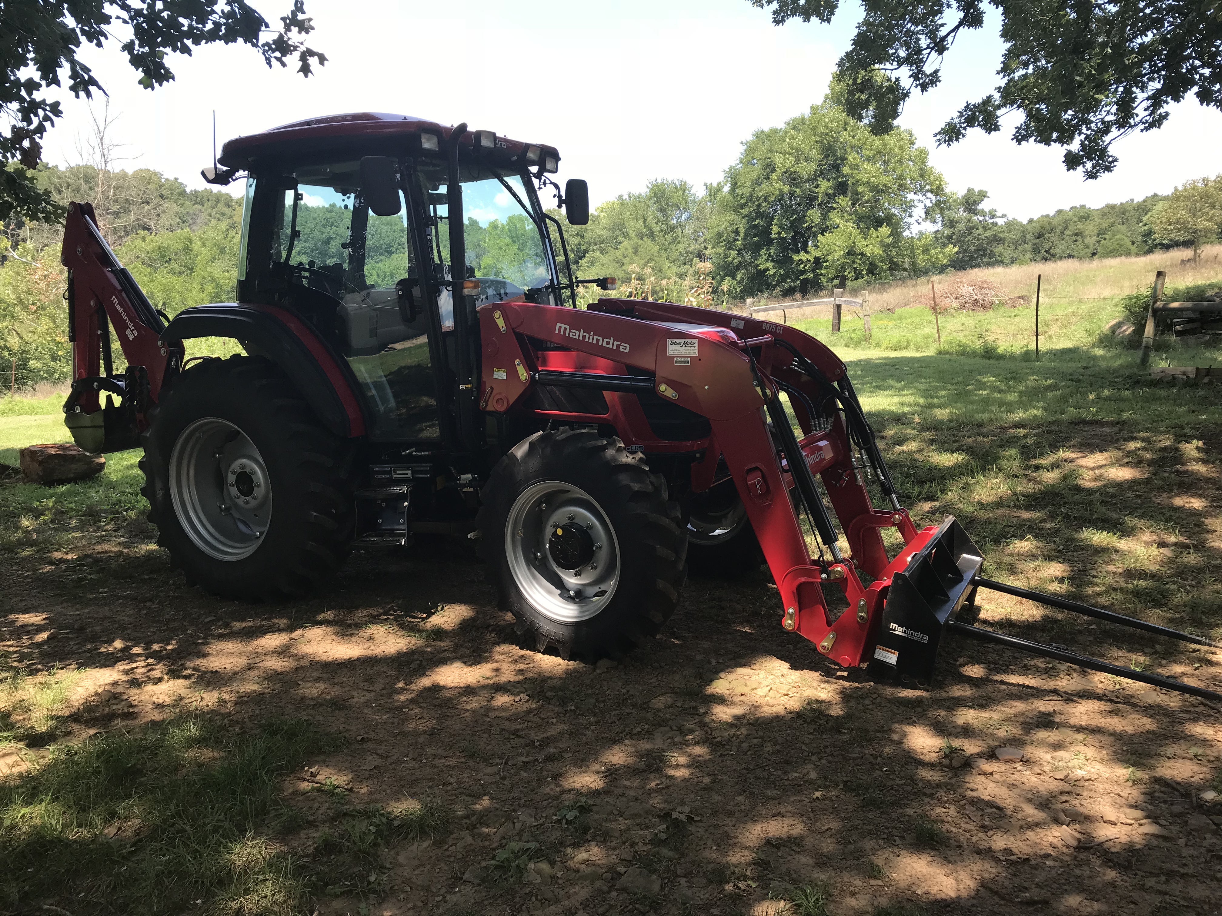

I took delivery of my tractor on Friday. As of right now I have just over 23 hoursnon it already and I’m in contact with the dealer because something isn’t right with the hydraulics. The loader will drift off pretty rapidly actually and the backhoe isn’t acting right and it also drifts off. The backhoe just acts like it has no power and the loader struggles to get the front tires just barely off the ground. The dealer wen out in his yard and tried another one and it popped the front tires off the ground with ease. So now we wait to see what they are going to do about it. So far they have been very prompt at talking with me and sending out a service truck to see what they can figure out but at this point they are trying to contact the engineers to see what they think the problem could be.

Well it sure looks pretty. With only 23 hours I would simply require him to replace it or undo the deal. DO NOT let him start the long process of, "I'm sure we can get this fixed up." without also including right from the start what the alternatives you will have if it isn't right by a certain date. And I'd make the date days or weeks, not months. This should be part of his pre-sale checkout.
On most tractors the hydraulics will throw you around hard enough to make using a seatbelt a real consideration. Particularly the hoe.

I have no idea how your loader and back hoe are plumbed as far as the hydraulics.
I do know that when I put our little 3 pt hoe on my tractor I use my rear remote with detents,
and when I latch that remote in the detent to run the hoe, my loader doesn't work, my 3 pt doesn't work
and my hydraulic top link which uses another of the rear remotes doesn't work.
To use my other hydraulics I have to center my remote for the hoe, operate my other users,then detent the hoe remote to use the hoe
and repeat as needed. If I rev the tractor up my other hydraulics will do a little but not much.
This is a feature that open center hydraulics do have.
Long story short in your application is one of your remotes active when you are having a problem?

The hoe is hooked up through a set of remotes on the back but the problem is there if the hoe is hooked up or not. I have tried just turning off the remote that the hoe is hooked to and I have took the hoe completely off the tractor.

Well the dealer called me around quitting time yesterday to tell me that they have found the problem and think they have fixed it but would know for sure this morning. When the 3rd function valve was installed (the way it was intended to be installed from the engineers) it created a bypass basically for all the hydraulic oil leaving the hydraulics weak and not functioning properly. As of last night they were pretty confident they had the problem fixed but wanted to leave it so they could make sure that it was 100% fixed. They said they would call me back today and let me know.
