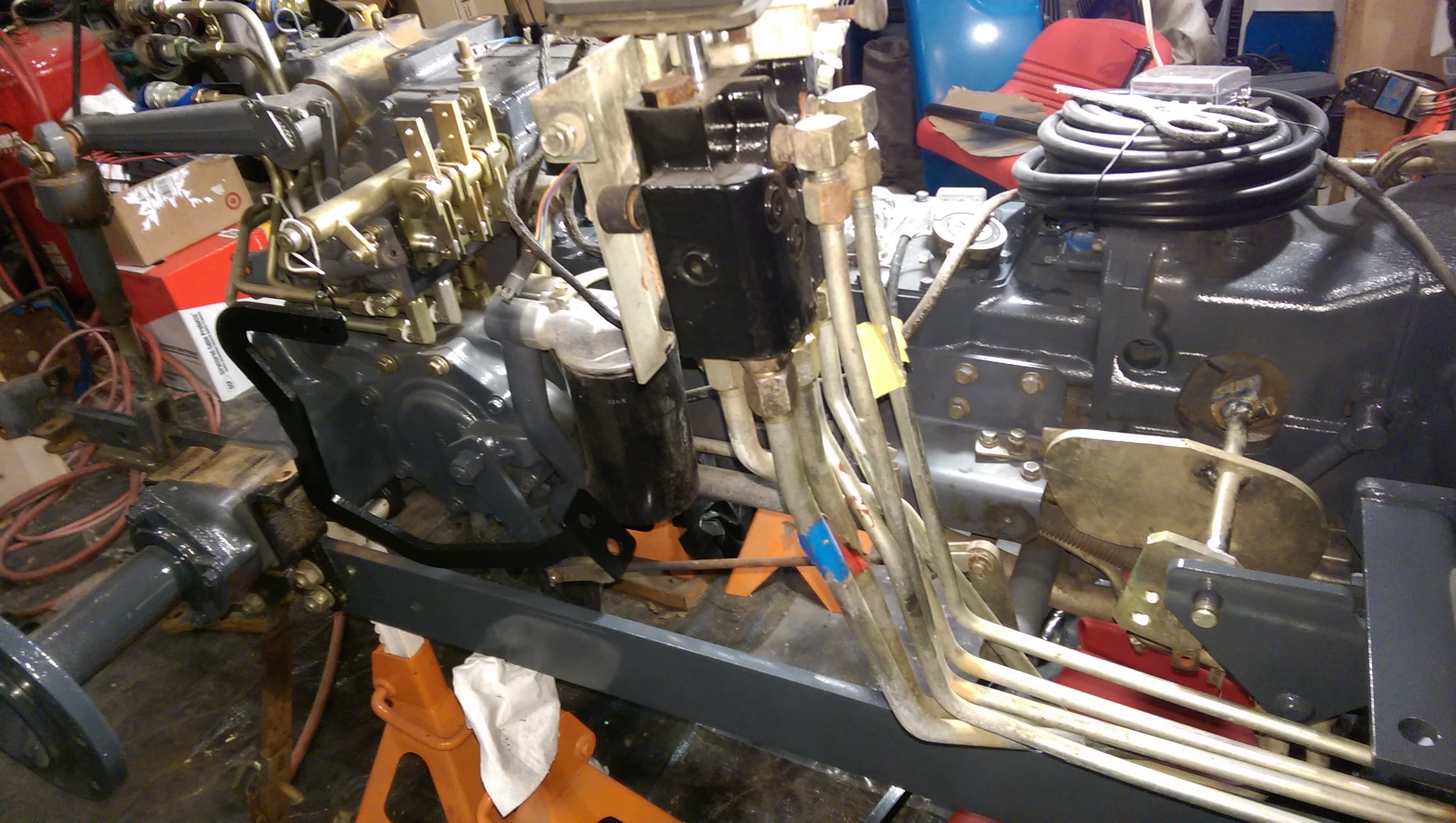

New Holland TC45D
Hydrostatic transmission stopped Add new hydraulic oil gave to me by new holland dealer drove it about 100 yards and just stopped moving loader still working HST forward peddle wants to stay down to the floor it will return if I push reverse peddle but reverse doesn’t work either

@RgP454 - I wondering if this is just a coincidence as far as adding Hydraulic fluid...
The first thing I would check is the Trans Pivot Assembly under the right side of the tractor it attaches the pedals to the trans... (it is in the picture below)... They sometimes break at the welds & will cause the condition you are describing...
Thank you I will check that out tomorrow
I zoomed in on the picture I see where it has been welded I will check that out tomorrow thanks again
That was the problem I got I weld back up all good creeping forward just a little but that job for another day Thank you so much for your help I really do appreciate your help thanks again
