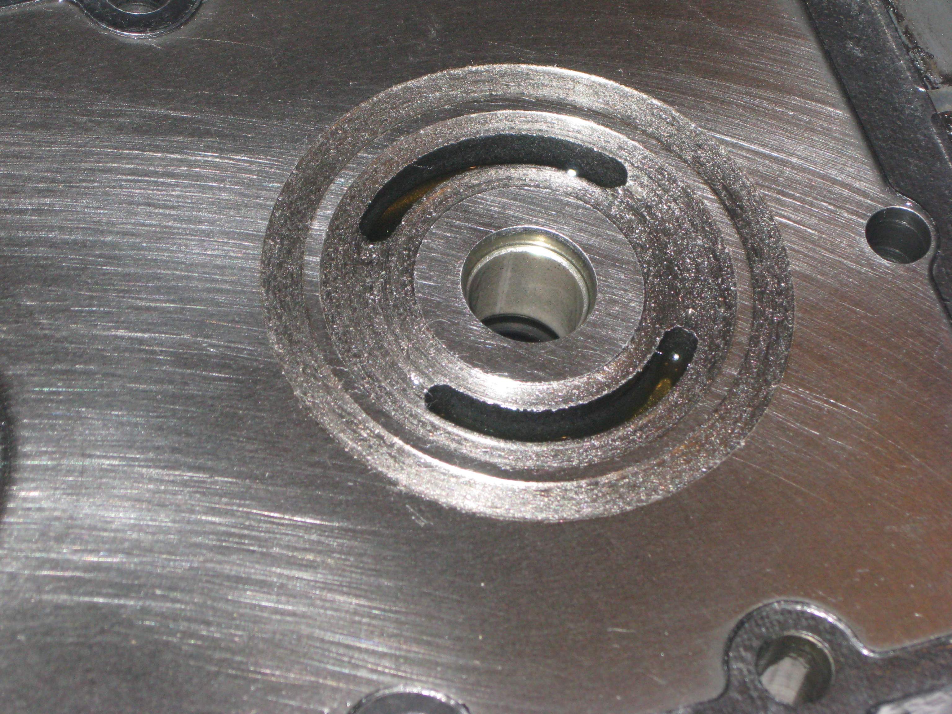

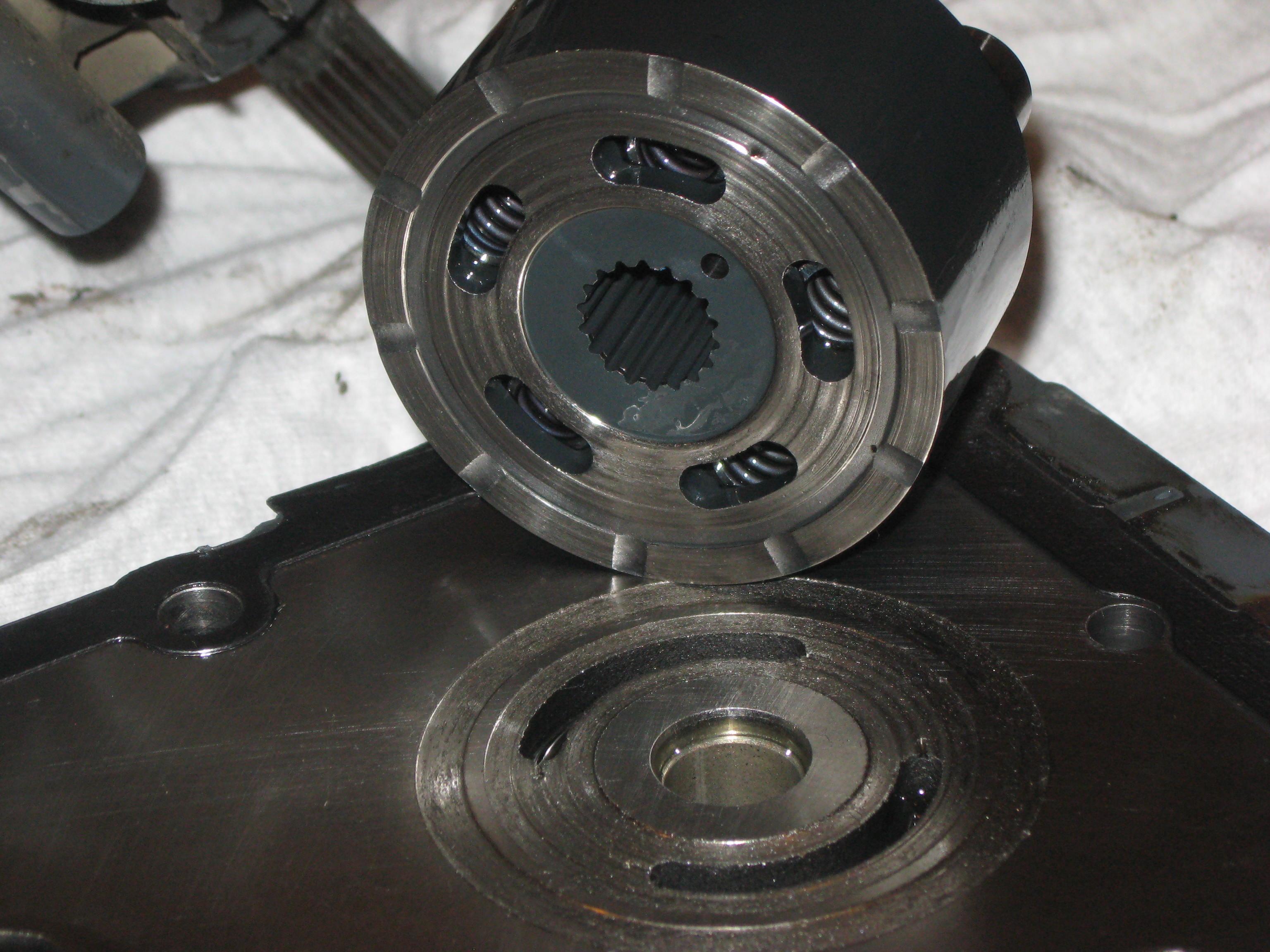

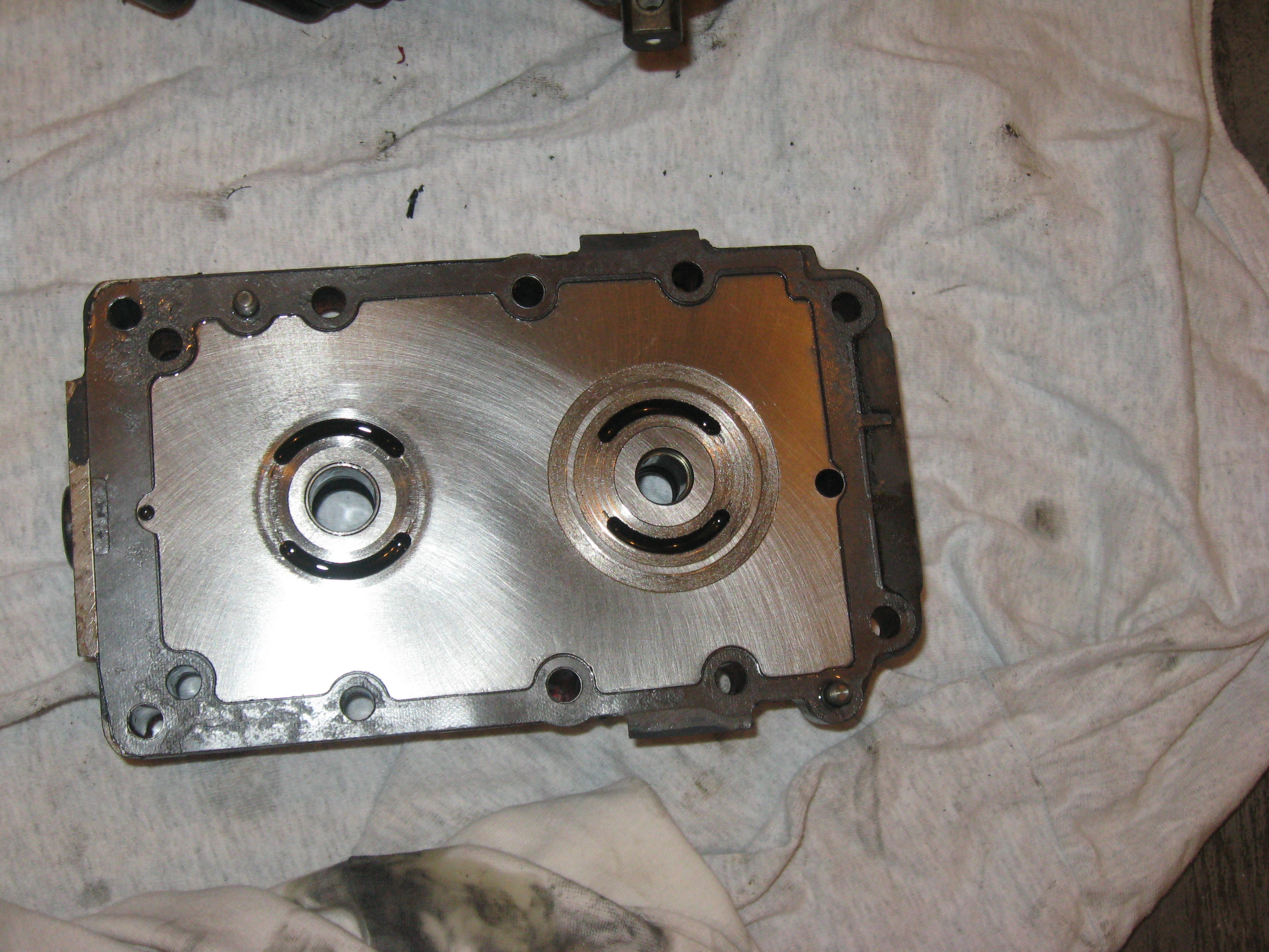

So I took my HST apart and found that the bottom of the cylinder block on the pump side scored the port block (not sure if that's what its called) pretty heavily and the cylinder block on the motor side scored it, but not nearly as bad. Otherwise, the inside of the HST looked fine. I've attached some photos but would love to know the cause.

How many hours are on your BX? Did it have the filter and fluid changed when recommended by Kubota? I had a service man tell me that the HST is much more sensitive to anything in the fluid than the hydraulic pump.
/ HST Problem Solved?
It has 480 hours and the fluid was changed at 3xx with a Kubota filter and their SUDT2. All fluid changes have been done per factory recommendations.
/ HST Problem Solved? #4
Wow, that doesn't look like 480 hours...very interesting. Did you cut open your filter and see if anything is abnormal?

I had my hst backing plate resurfaced and I replaced both pumps.

Not yet, but I will and post the results. When I took out the tranny screen and saw metal filings I figured something was up.
Just like having a flywheel resurfaced.:thumbsup::thumbsup: Great idea, I didn't think of that but I've already got a new HST on the way. I just need to figure out what caused it so it doesn't happen again. I'm thinking of replacing the priority flow valve per mattj's suggestion from another post.
Do the surfaces look pitted at all or just scored?
What did the slippers on the pistons look like?
Was there any scoring or marks on the swash plates? I.e. Slipper wear plates
Since these are "closed loop" usually when one component (pump) starts to wear it puts the trash into the rest of the components (motor).
Do you use this for plowing snow in the winter? FEL, blade, or blower? Does it sit in a cold building or heated building?
Do you use it mostly for mowing lawns or lots of FEL work.
Just trying to get a feel for use which may help narrow down some possible causes.
Roy
/ HST Problem Solved? #9
You should not have the port block (yes, that is the correct term) "resurfaced", just not a good idea. Just looking at the pictures, it looks as if the charge pressure for the system was low. But I admit that it is strange to see that type of damage on 1 side only. On the BX, the charge pressure is created by the main hydro pump (if I remember correctly) and a regulator valve the splits oil off to steering, pto, and hst. I would check the charge pressure after reassembling.
I checked the charge pressure before I took it apart and it was 100 psi, which is exactly what the WSM says it should be. Although, I didn't check it with the tractor under any substantial load. I did it with the tractor sitting still and the throttle maxed out....per the WSM. The regulator valve you're talking about is the flow priority valve, which I'm thinking of changing too.

When you get it back together check the charge pressure when driving up a steep hill or doing something that puts a load on the HST. On mine the charge looked fine at a stand still and at full throttle, but start to go up a hill and it dropped like a rock to below 20 psi. With the new flow priority it held fine at my spec of a bit above 50 psi even under the heaviest of loads. May want to check before you buy as the priority valve is around $160.
Also, you did the right move with replacing the whole HST. Its also cheaper as the pump assemblies you showed are around $700 each.

Not sure what the slippers on the pistons are. I did a pretty thorough look over of the internals and that is all that I noticed but I'll check again later this week.
Pistons are what actual pump the fluid in the cylinder bores. In looking at the exploded parts I see that these do not have slippers on them but probably just have a rounded head. Look very similar to what is used in Hydrogear units. Was this head scored or pitted in any way?
The prior (original) owner did use it every winter for snow blowing. He also had it dealer serviced (I have all the receipts) during his ownership. The tractor does sit in an unheated garage, but mine is very well insulated and does not typically go below 30 degrees.
I use it mostly for mowing and I have the Kubota leaf system, which I use extensively in the fall. The problem started happening when I was moving crushed stone (6 ton) and leveling out a small area with the FEL.
If for some reason the charge flow / pressure is limited you would get more chance of scoring when doing FEL work due to higher loads on the HST Vs mowing lawn. The higher the load/pressure in the HST the greater the leakage flow that the charge system must make up.

Looks like you are getting some help on this. I would have to say that if it's not dirty fluid then it's a lack of fluid that cause the problem. Along with what others have said I would also check the temp of the fluid after it's been used hard after you get it fixed. Maybe even check all the oil lines and passages to make sure nothing is restricted.
/ HST Problem Solved? #17
Normally I would think of wear in this area as contamination but yours looks more like lack of lubrication. Charge pressure under load has already been discussed - you should monitor that. As for temperature, your hydro works best from 10 cSt to 16 cSt. UDT is 9.3 cSt at 100 degrees Celcius. Once the oil at the working faces gets hotter than that wear goes up at a very high rate. Check your system to make sure oil cooling is doing its job, and if you can, monitor your temp periodically when you are really working it. I use a I-R thermometer that is accurate enough for monitoring something like this.
