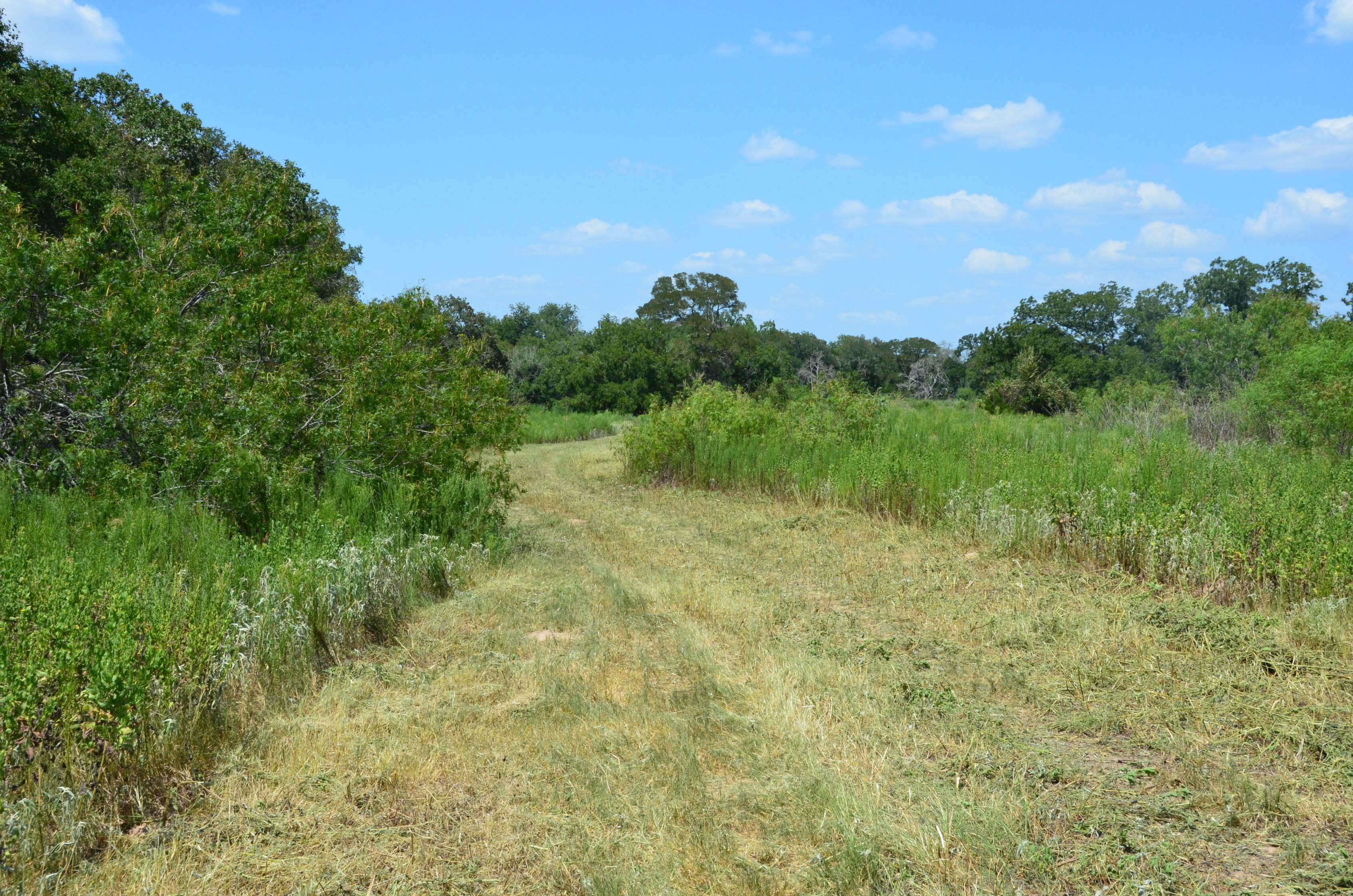

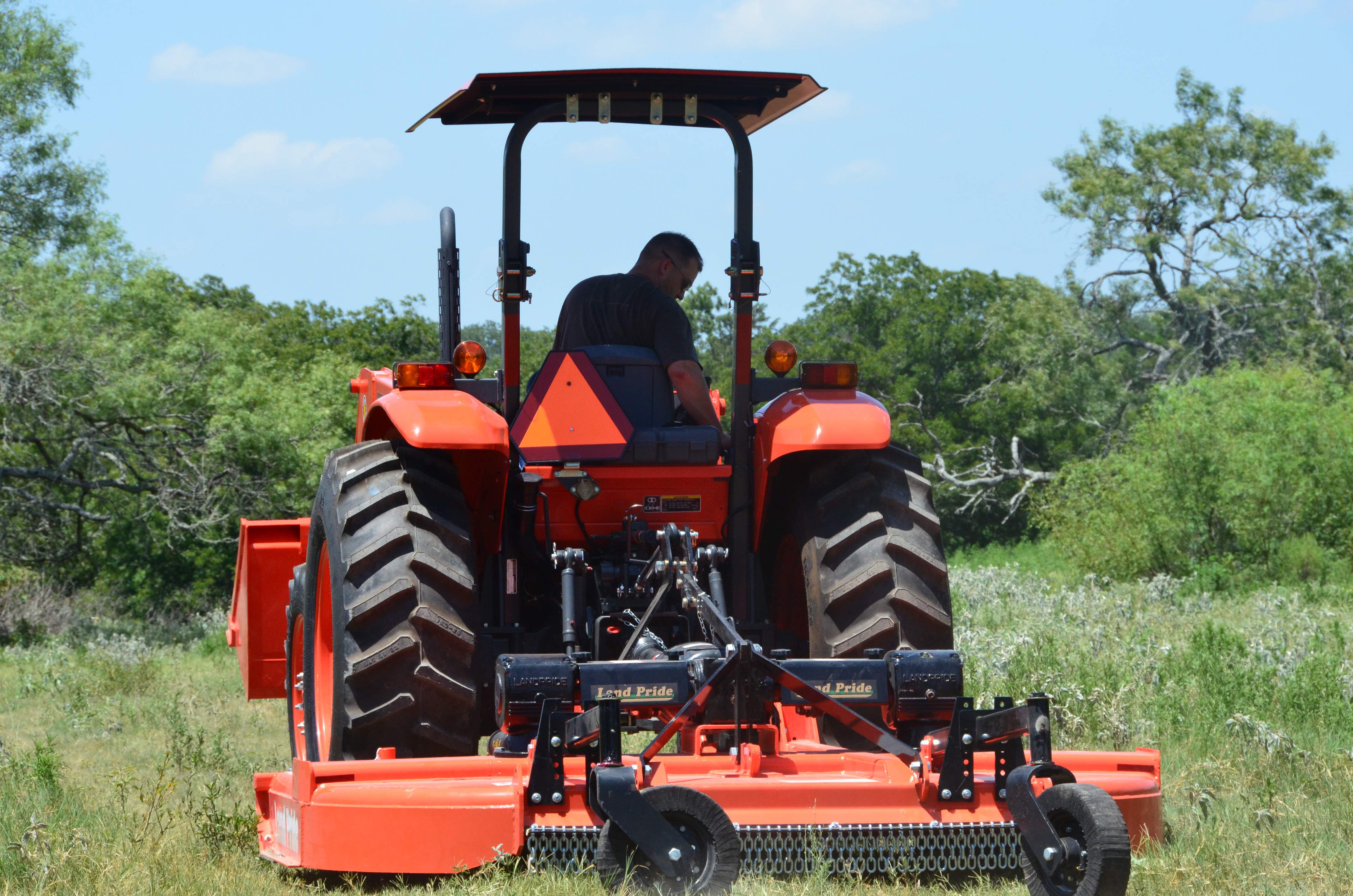

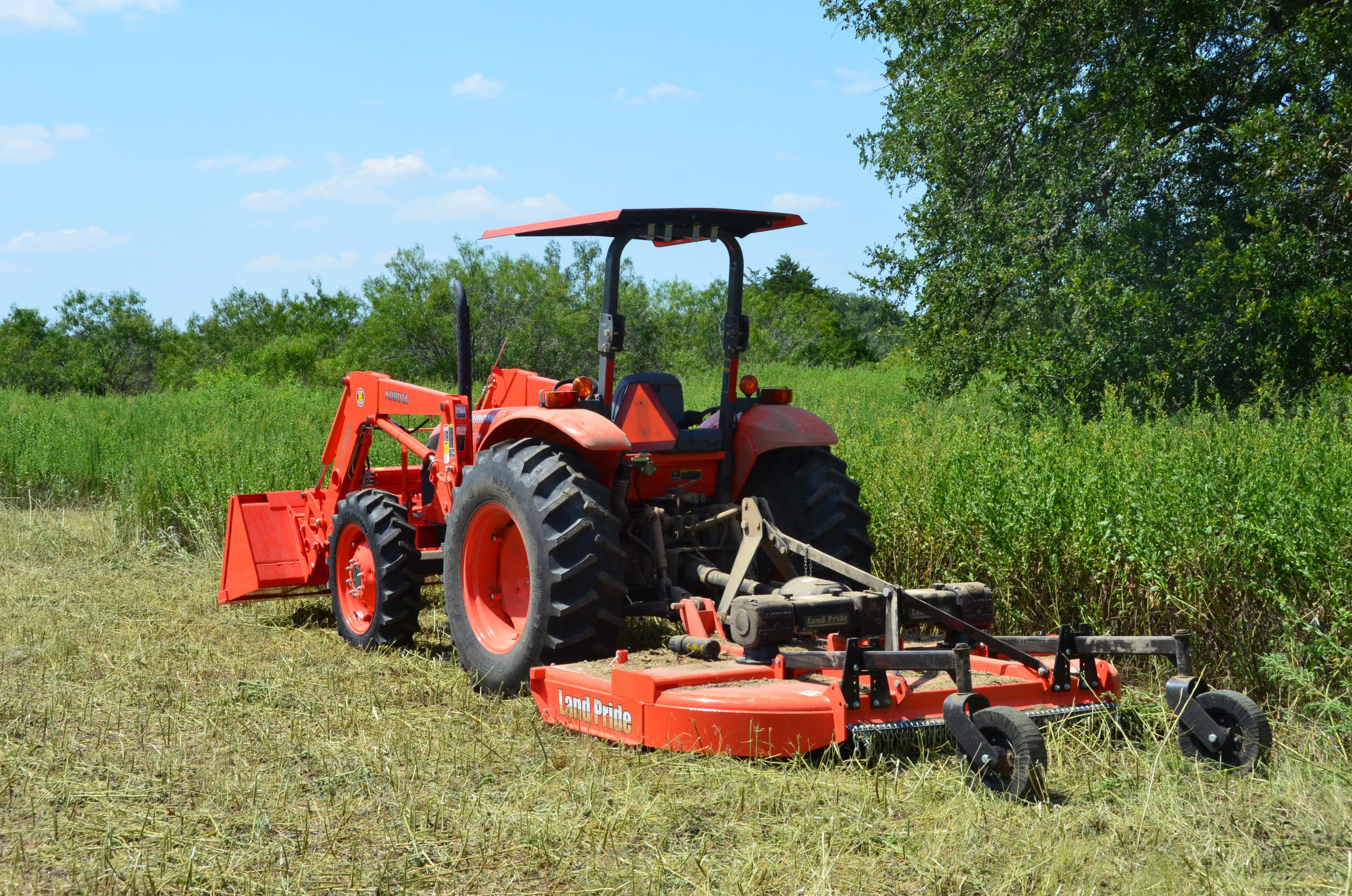

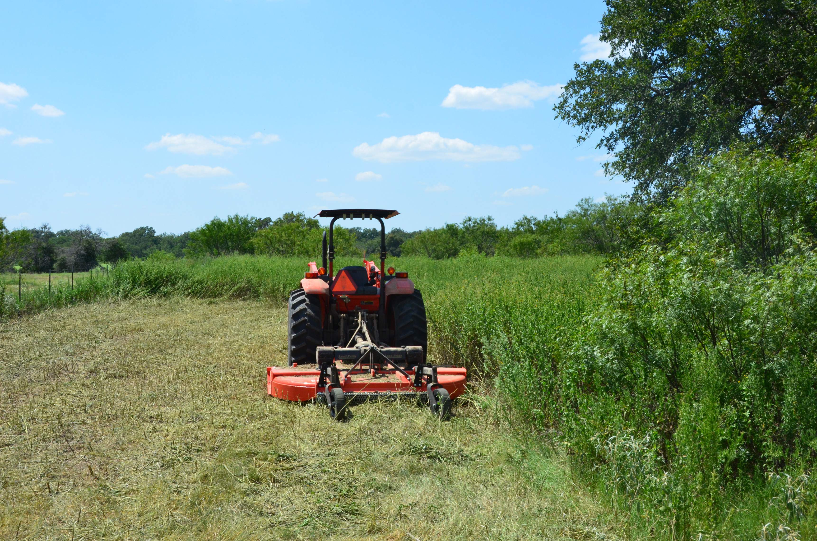

Had a tremendous amount of fun today, and all went well. I see now what folks are talking about with the weight and HP. However, based on what I did today, I can't imagine ever needing / wanting to cut faster than what I can do in high first. It cut just fine there, and the "ride" was actually much more comfortable at low 4th. Here are some pics:

Congrats,JBowie:thumbsup:Looks good...

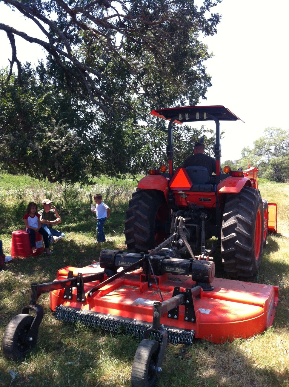

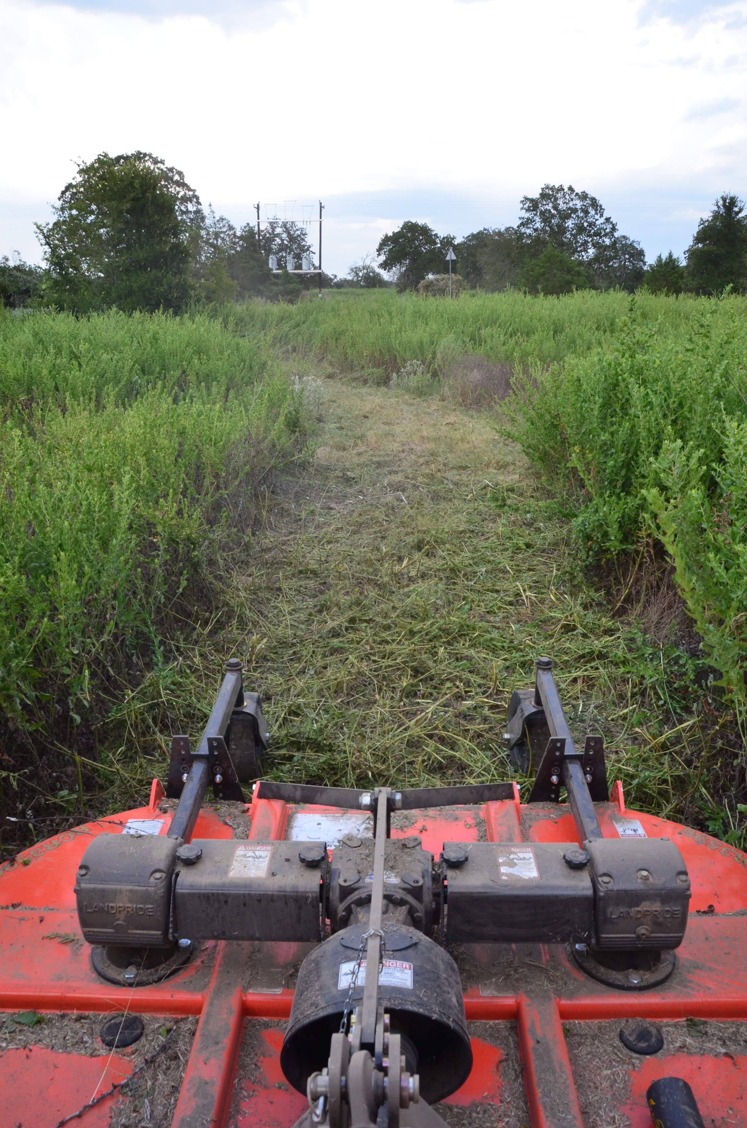

I had to close this out with one more pic. Great tractor and shredder combo:
