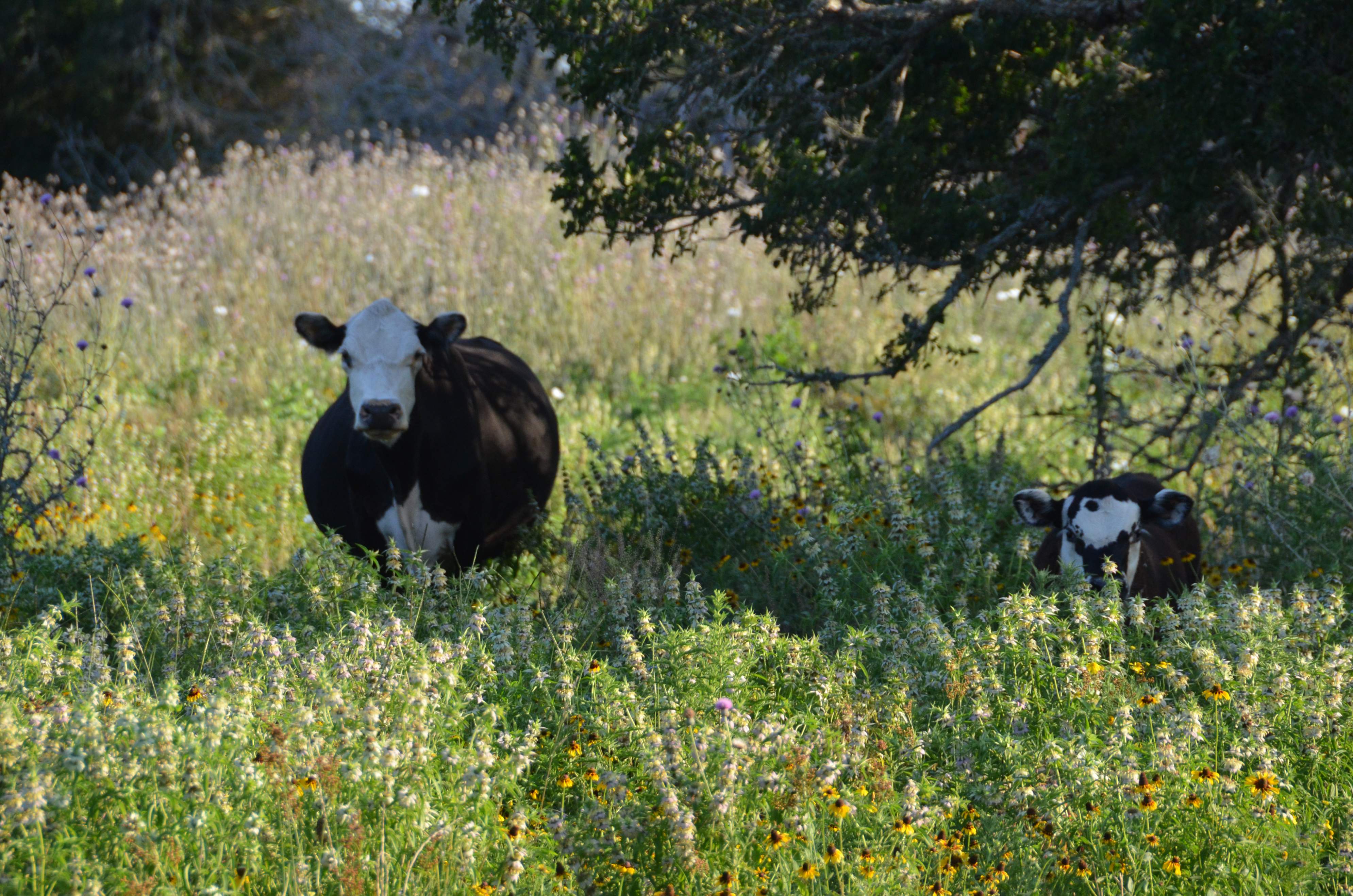

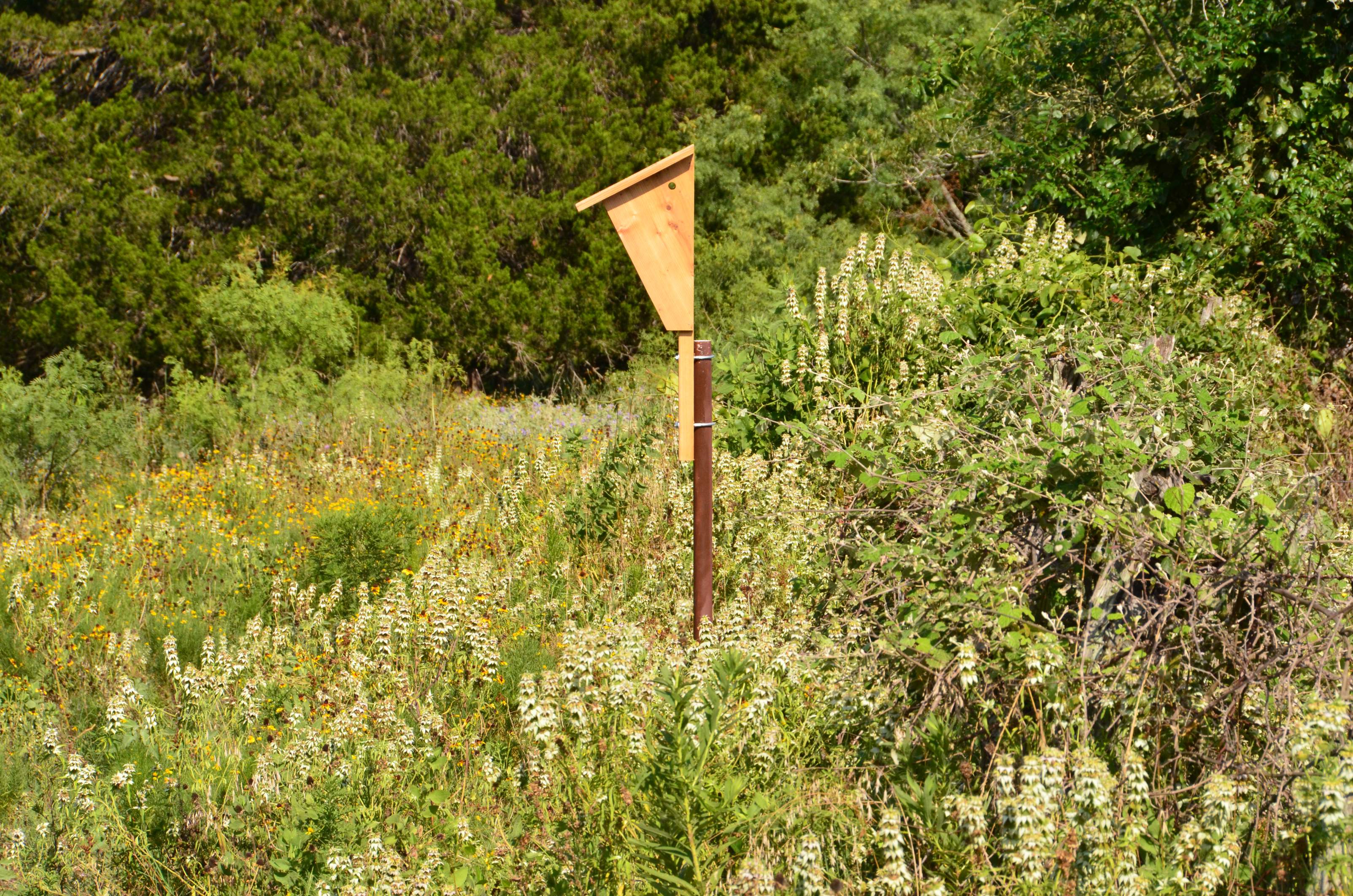

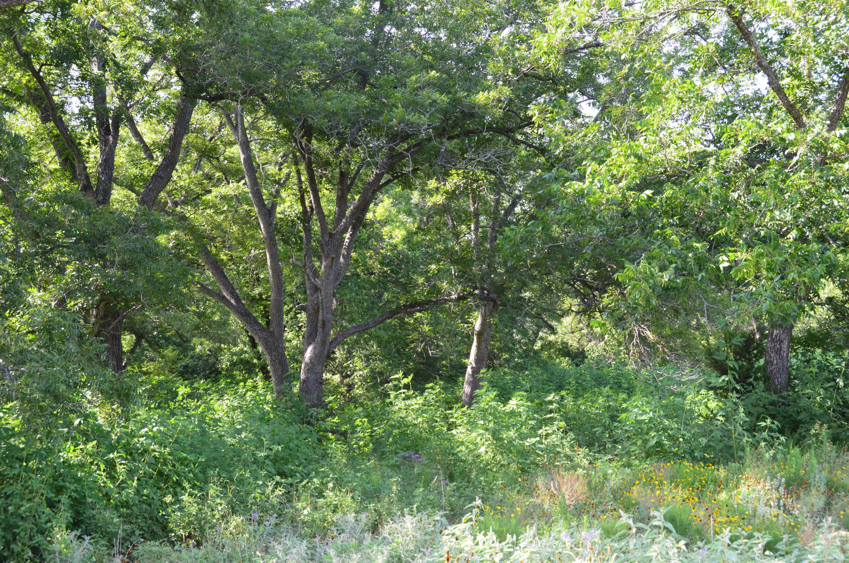

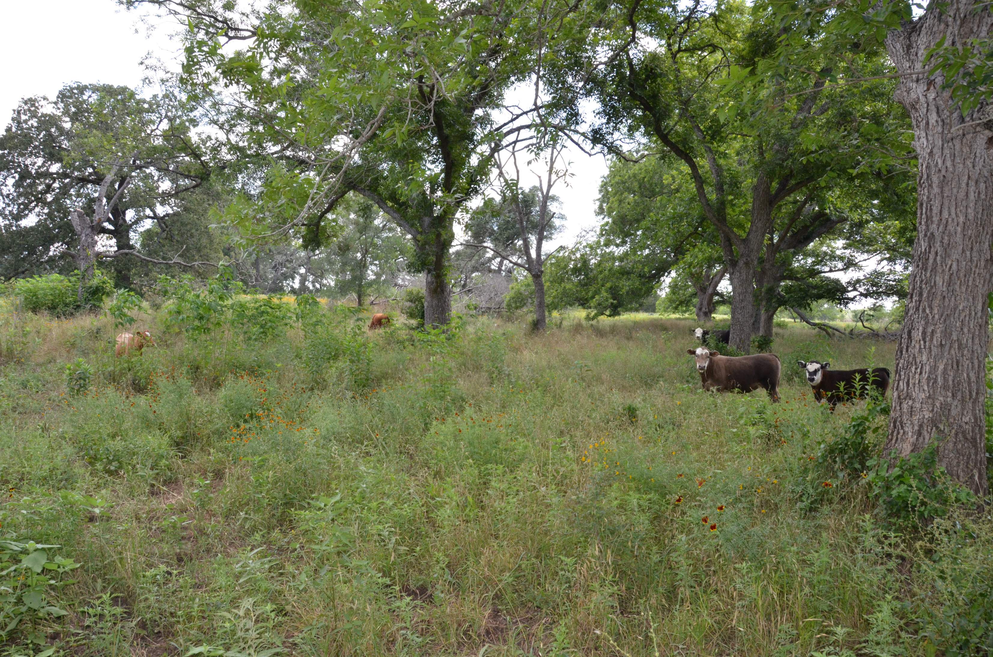

Although I don't seem to have any of the more open areas, here are some pics of the type and size of brush I'll need to cut, at least the first time:

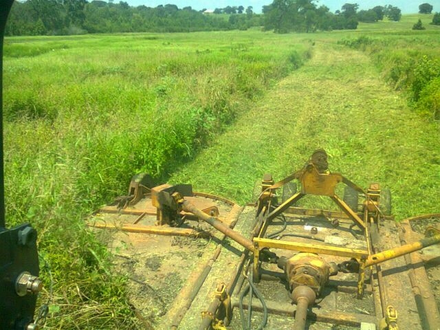

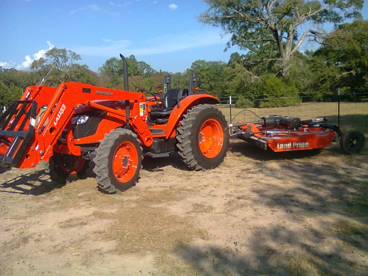

tractor3.JPG to mow yard (8ft)

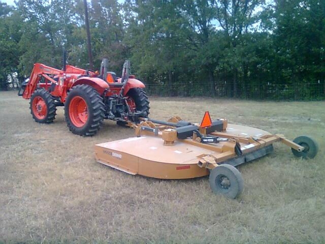

5040 and ds1440.JPG few hrs to kill (12ft)
mowing bottum1.JPG gotta get'r done (15ft)
:laughing:

I think you will be fine, but performance will probably be very dependant on what you are cutting. If it is shorter or thinner, I am sure you will have no problems, if it is very long or think and has trouble getting discharged, even a larger machine might have some difficulty. If you find you do, simply cut more often or at a higher setting. Not a big deal.
