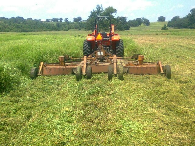

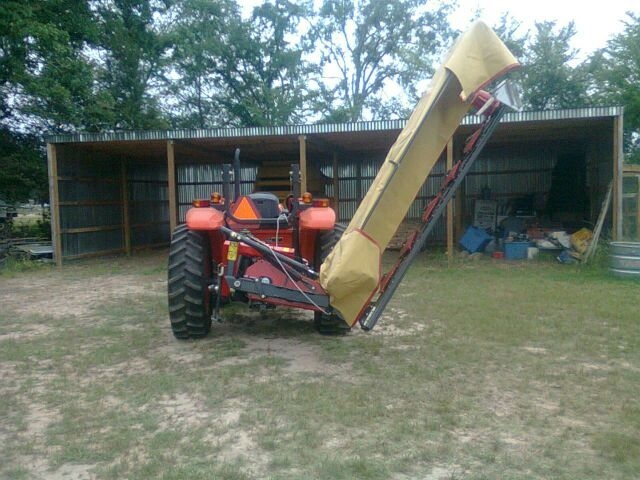

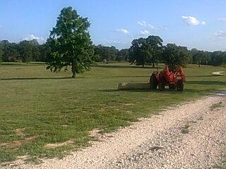

KUBOTA M5040 cutter up all the way.JPGcutting hay1.JPGVicon hay cutter=1170lbs and Landpride RCR3596=1360lbs the the lift model on shredder so question is your place pretty flat? I have moved hay bales that weighted more than that shredder all daytractor1.jpg. The things is I wouldnt wonna pull that mower 3pt version on slopes or threw ditches and stuff like that very much,just dont think would have the versitility as a lighter model or a lighter 7FT cutter. You have the power for the cutter no issue theremwing bottum 3.JPG.
