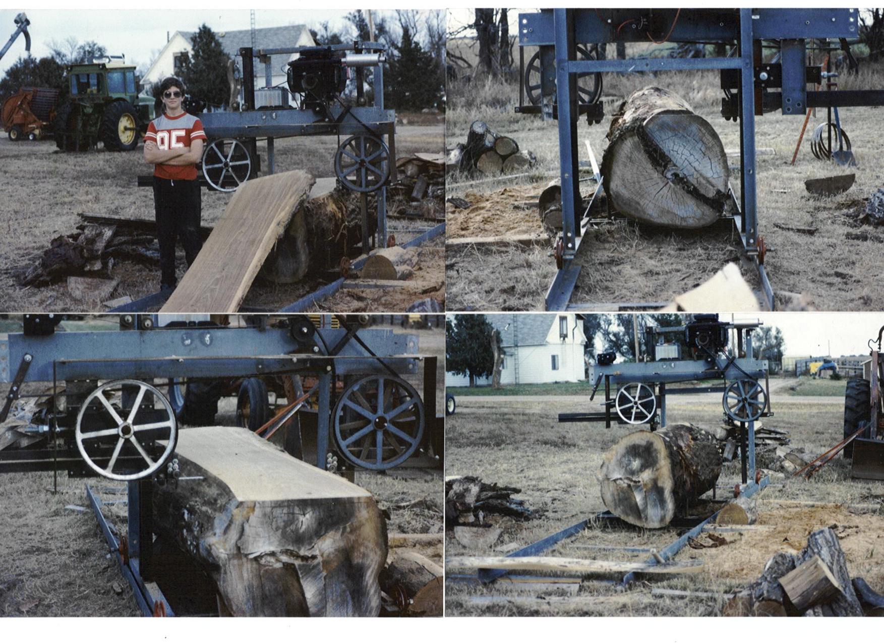

I have a 218 Ohan engine on my home made band saw mill, I really wish I had used a magnet clutch instead of the hand unit I came up with, off the engine I used a double pulley about 4" in diameter,

It's good to hear from someone who's actually built his own mill and I may PM you when I begin my band mill. After reading your message, I think I need to quit planning and begin building. If I end up with several pulleys that don't work, my wife can sell them at that estate auction when I die. I may even get the cheaper spot welded pulleys to begin with, to work out the best ratio and upgrade if they don't hold up. Here are links to a couple of Surplus Center pulleys that I'm interested in, 3.95 O.D. 1 BORE 2 GROOVE PULLEY
