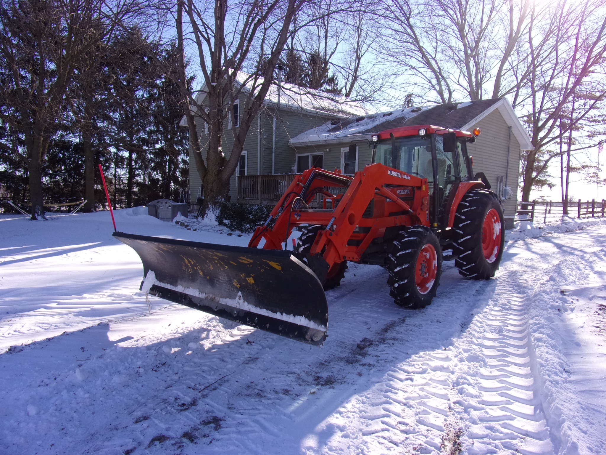

I currently run a Kubota M6800 to use a 7' land pride brush cutter and 7' snowblower. 68 hp. Even with sharp blades, some real thick grasses makes tractor work harder than i'd like. I usually mow in first to get it all. Would 90hp give me the umph I'm looking for and perhaps give me enough to maybe go to a single batwing 10 footer. Some mowing is also red brush and tag alders. If I can drive over it it gets cut. Would not use the 10' for heavy brush. Thoughts?
90HP would turn a 15ft batwing mower. would be a bit of overkill for a 7 footer

I have a wild area filled with grasses, weeds, brush and saplings that I mow once a year with my 60hp L6060 using a 7' medium duty Bush Hog brush cutter. By the time I mow the weeds and brush they are usually around 4' high. I generally run my tractor at 2000 RPM in mid-range (hydro with 3-speed gearbox) and don't have any issues. When I first got my L6060 I had not mowed the area for several years and there were dozens of 1"-2" thick saplings which did not pose a challenge, although I did have to slow down some. On occasion I have even cut down 3" trees, which is about all the mower is capable of. It does not seem likely to me that power is an issue, which make me wonder whether you might have bought a light duty brush cutter. Have you checked the HP rating of the one you have?

A cutter will bog down if you stuff too much through it too quickly, regardless of how much engine power there is. Slowing down to first gear is sometimes needed just so the cutter has enough time to shred the material fed into it. I have to do this if I am cutting blackberry thickets next to the fence lines, if I go faster than that it bogs and slips the slip clutch. You have more than plenty of power for a 7' cutter, you should be slipping the slip clutch or shearing bolts well before you bog down the tractor engine, assuming everything is set up properly. If not, you should check your slip clutch to make sure it isn't seized or over-tightened or that somebody didn't put a Grade 8 bolt in for a shear bolt. A 68 HP tractor should be able to run a 10-12' cutter, and even a 15'er if you are doing something lighter duty like pasture clipping. A 90 HP should run a 15'er in most conditions.
