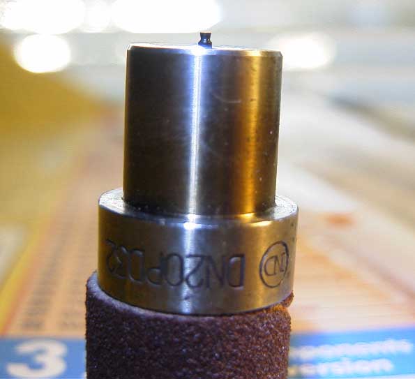

The simplest way to increase the torque and horsepower of a Kubtoa diesel engine with a NipponDenso inline mechanical pump is to provide more fuel within the narrow crank angle of injection. To accomplish that, you either increase the injection pressure at the pump, or simply increase the diameter of the pintle orifice at the injector nozzle, both result in more fuel being delivered into the combustion chamber within the critical crank angle window of injection.

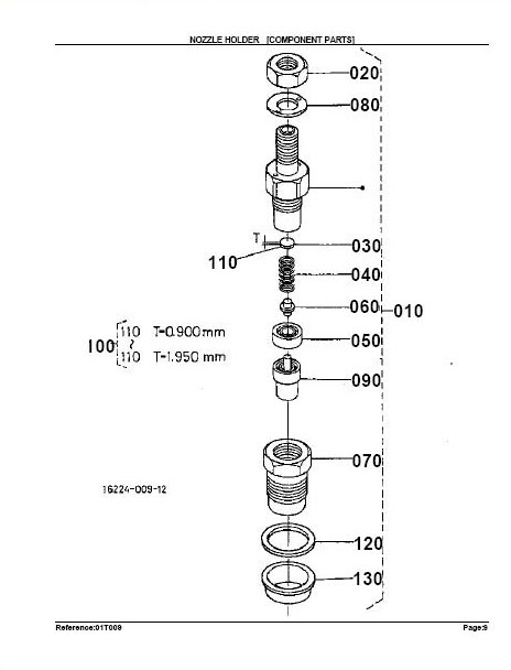

The plunger and barrel of an inline injection pump is capable of producing 10,000psi. The injector pops at about 2000 psi. Of course you need it to pop at a certain pressure to ensure proper timing. The only way to change the pressure is adding shims to the spring in the injector. But if you increase pressure, it'll take longer for that pressure to build and it'll delay the timing. So you must advance the timing, of course since the injection pump is metering fuel, you still get the same shot. If you want more fuel, you turn up the injection pump.
So Skypup, if the fuel is regulated by the injector. how does the engine change speeds (idle to WOT). And pressure is an incorrect answer. The plunger and barrel of the pump is a positive displacement pump.

skypup, im sorry but you are wrong, it is the injector pump which contols the fuel andd thus HP. the injector is only a thing which sprays the fuel at a set pressure, return to tank is internal by pass of injector,
inside the pump is a pistom in a bore, the bore has a hole in the side, fuel enters as piston is down, as piston travels up it blocks the hole and pressurises the fuel, starting injection. in the side of the piston is a slot at an angle which is linked to the top of the piston, so this slot is pressuresed with fuel as the piston goes up, once the piston travels up far enough, this slot opens up the inlet hole and pressuised fuel exits back through the inlet hole, dropping the pressure and stopping injection. because the slot is at an angle, if you move the position of the hole around in regards to the slot in the piston, the piston travels futher up before injection stops, which gives more fuel. i hope i didnt confuse matters futher with that description.
