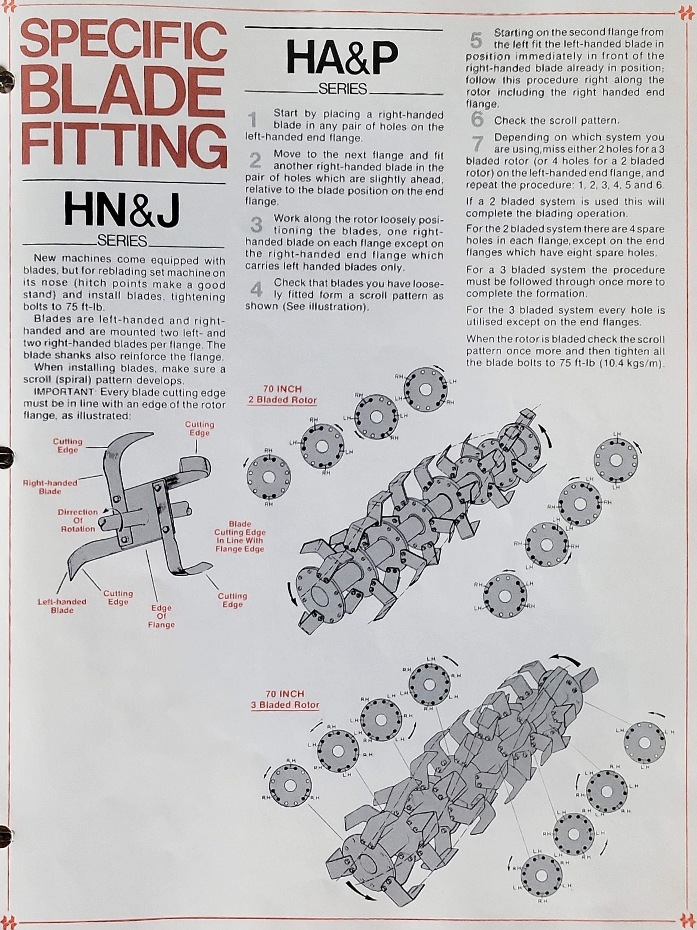

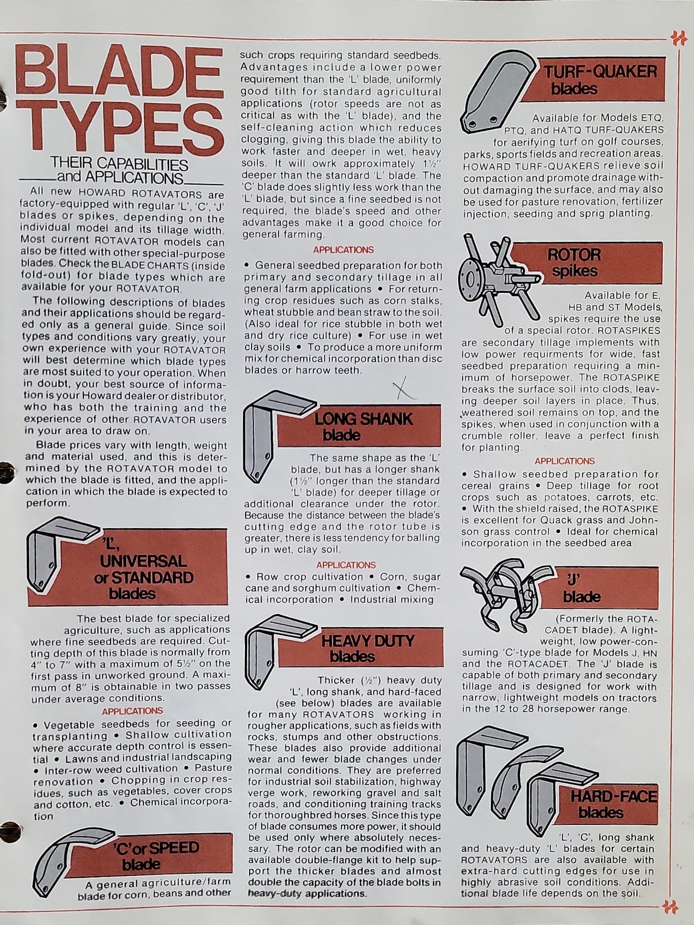

Just looking through an old Howard book. The Rotocadet, J and HN used J blades
