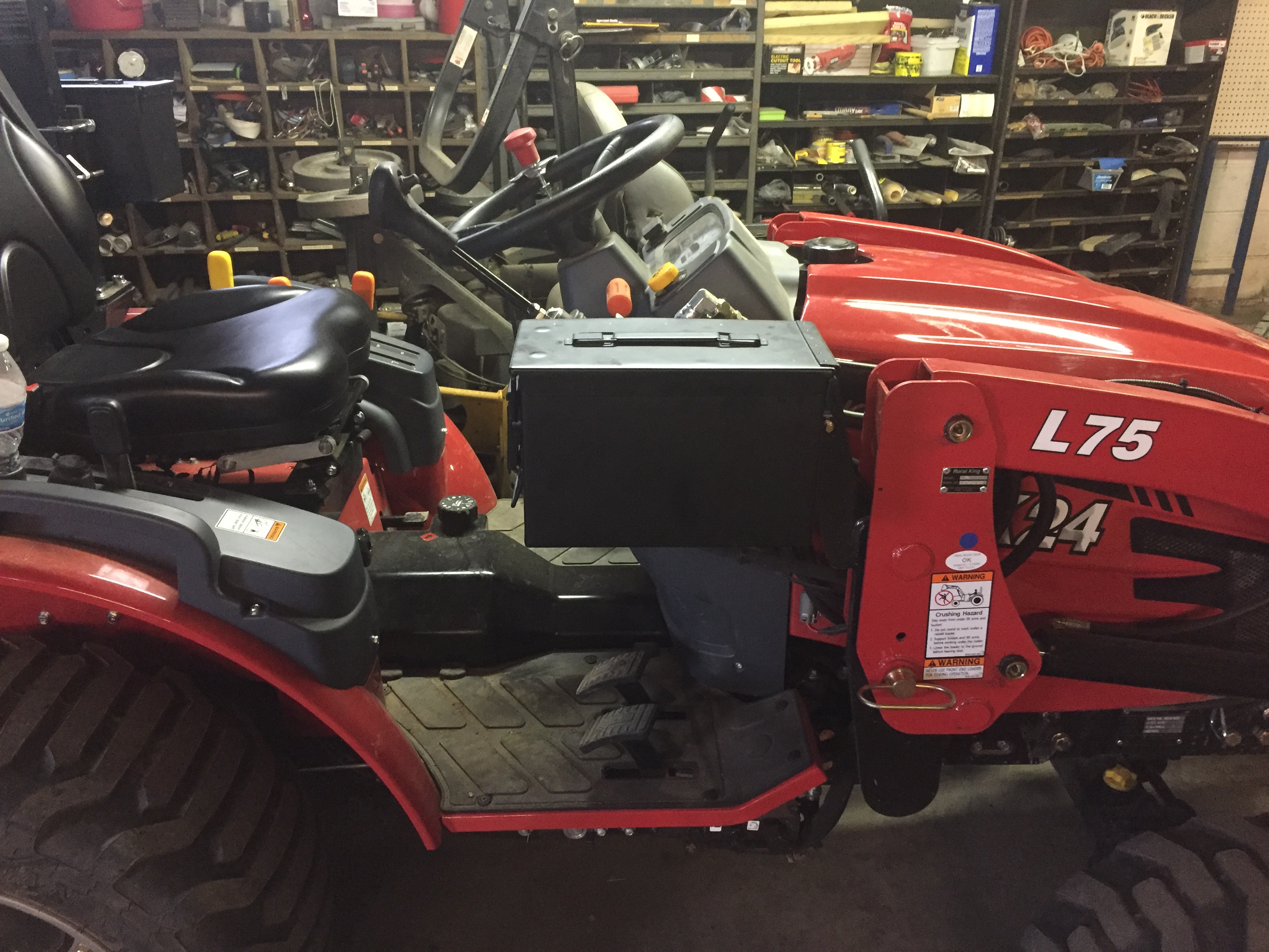

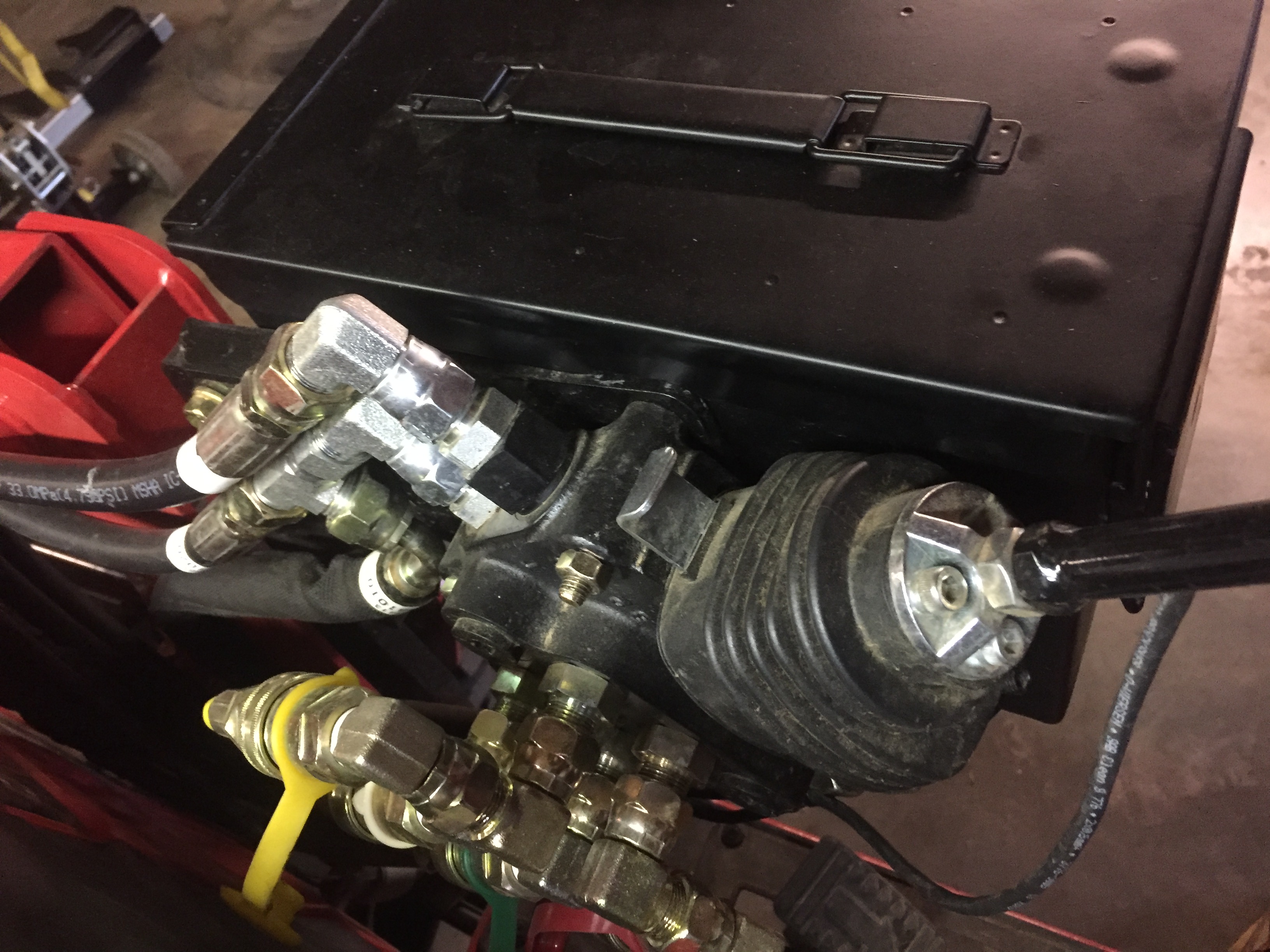

This is the first one. This is the easiest one to do. It is a 50 cal ammo box (metal). It is very inexpensive most places. No extra bolts needed. If you notice in the picture, I used the existing bolts that hold on the loader controls. They are plenty long enough and you only have to drill three holes. I have my chain in that one.

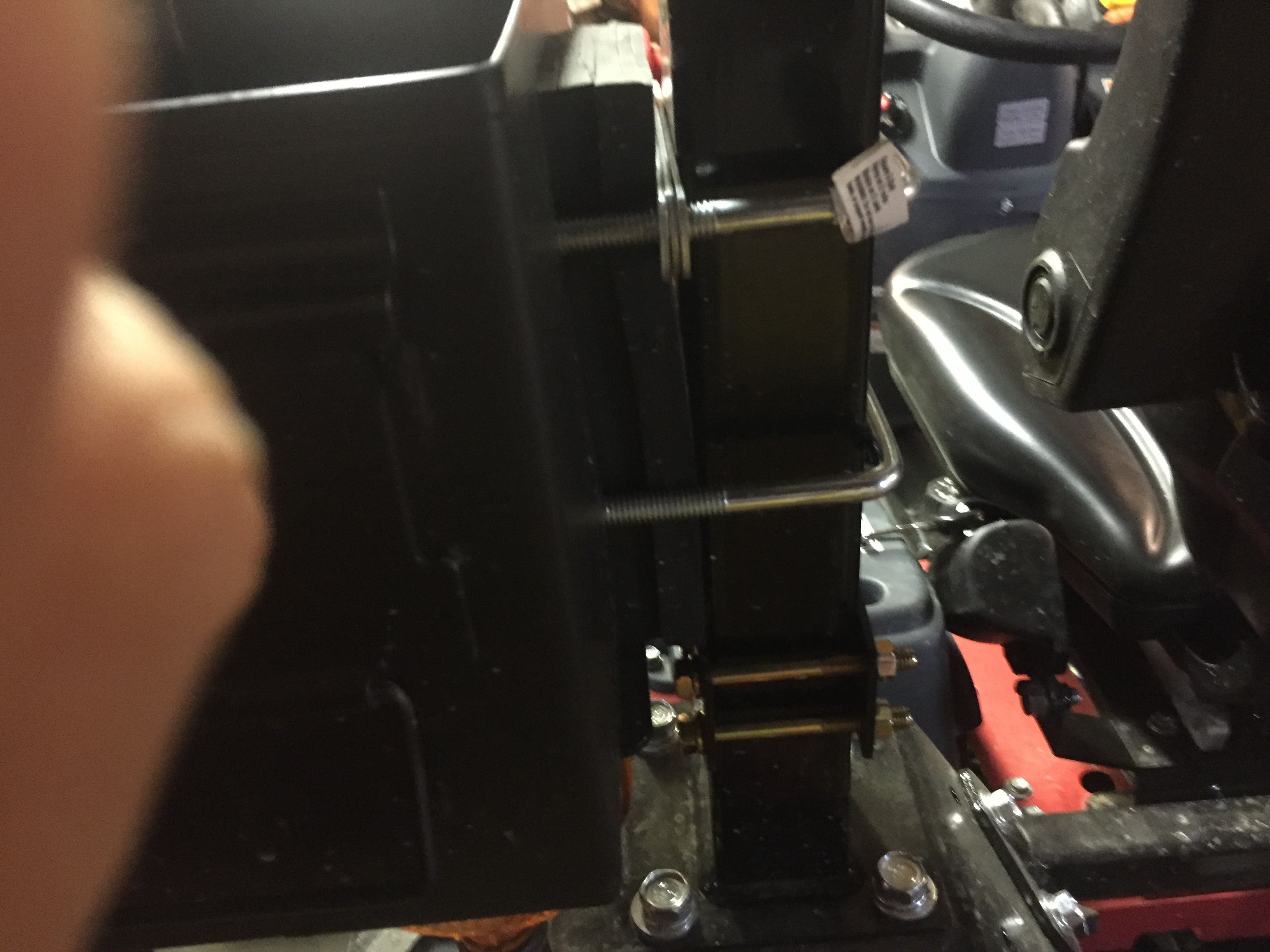

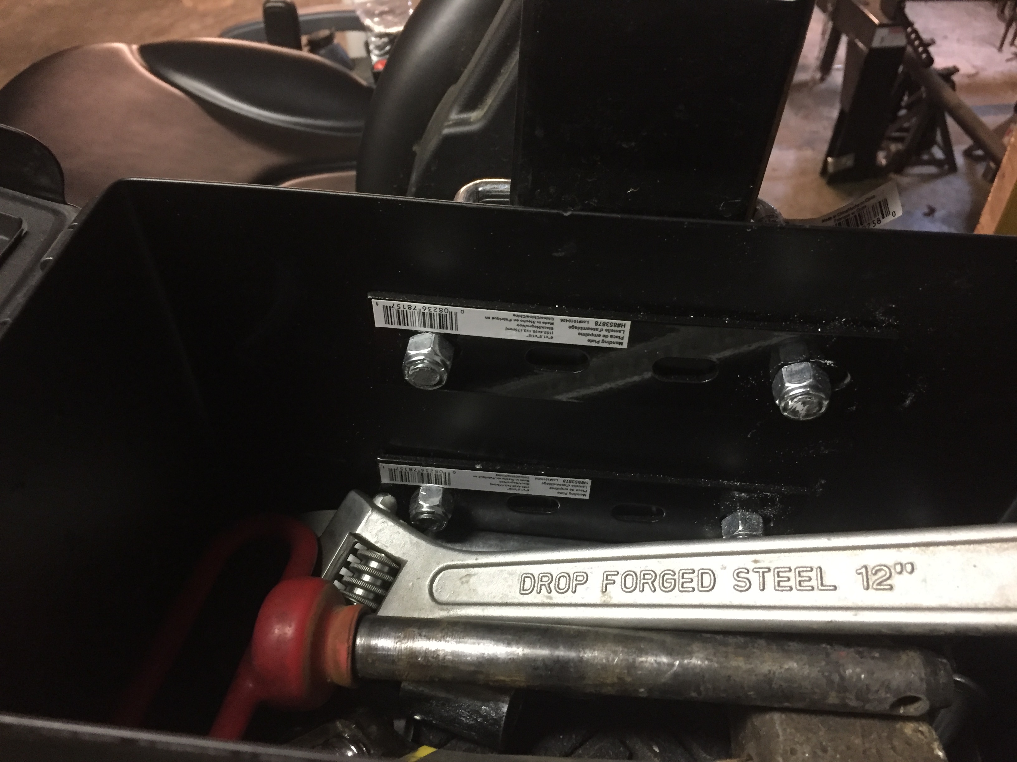

This is the second one I did and it is attached to the rops via ubolts. There are many ways of doing this. I normally try to use stuff I have laying around. I had to fer it out some with rubber in order to miss the big bolts on the rops from when the ammo box lid opens. I used some flat bar on the inside where the nuts are for more rigidity. As you can see, the old tool box mount is still there. It is underneath the ammo box for added support. I could have bolted the ammo box to it also but it is plenty sturdy without it.

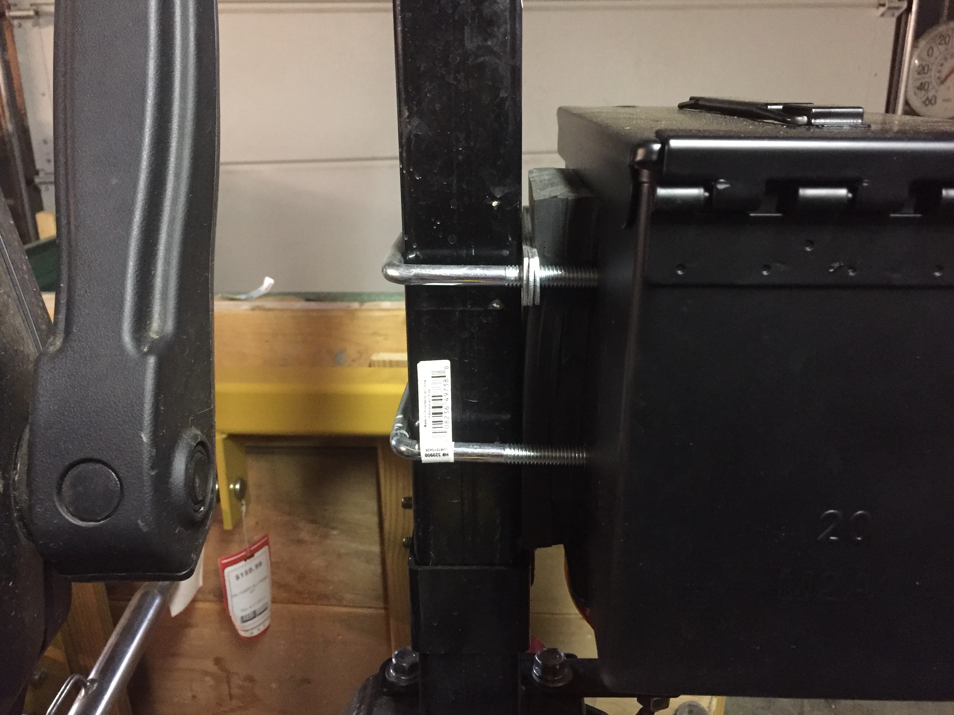

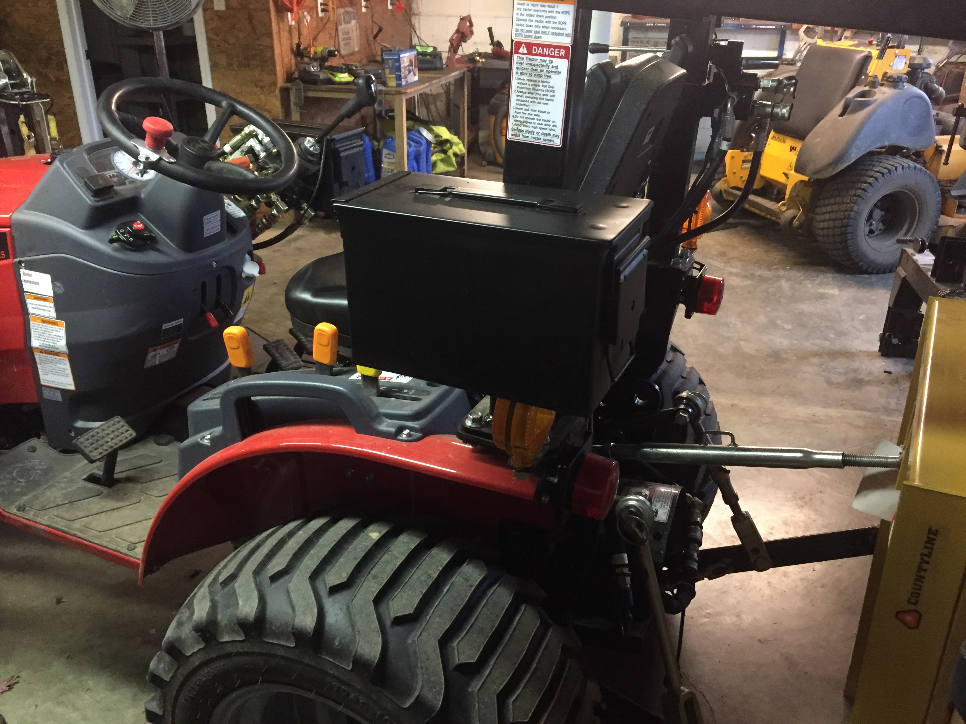

The third one I did required a little more work. It is ubolted to the left loader bracket (if you are sitting on the tractor). I could not get the ubolts in that size so I had to make them from round 3/8 blank stock. I used 3/8 bolts and stop nuts. I used rubber stock from Rural King to fer it out enough so that the ammo box lid would miss the grease fitting on the loader arm. I lined the bottom of the boxes with a piece of outdoor carpet from a damaged piece I had. I hope this post will help some that are dealing with the same problem.
   / how your RK 24's doing? #27
Exactly how I installed mine last year. Looks good. Make sure you put a plate or big heavy washers inside or it'll start to pull and rip out with heavy chains in it.

Thanks. The one for the chain has a plate and the other two have oversized washers.
