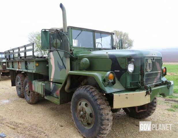

Yesterday as I was throwing trash in dumpsters a guy drove in on this, only his was a tandem dually. I bet that would pull it down! His even had a huge PTO winch. 2505063_10_0_0001.jpg

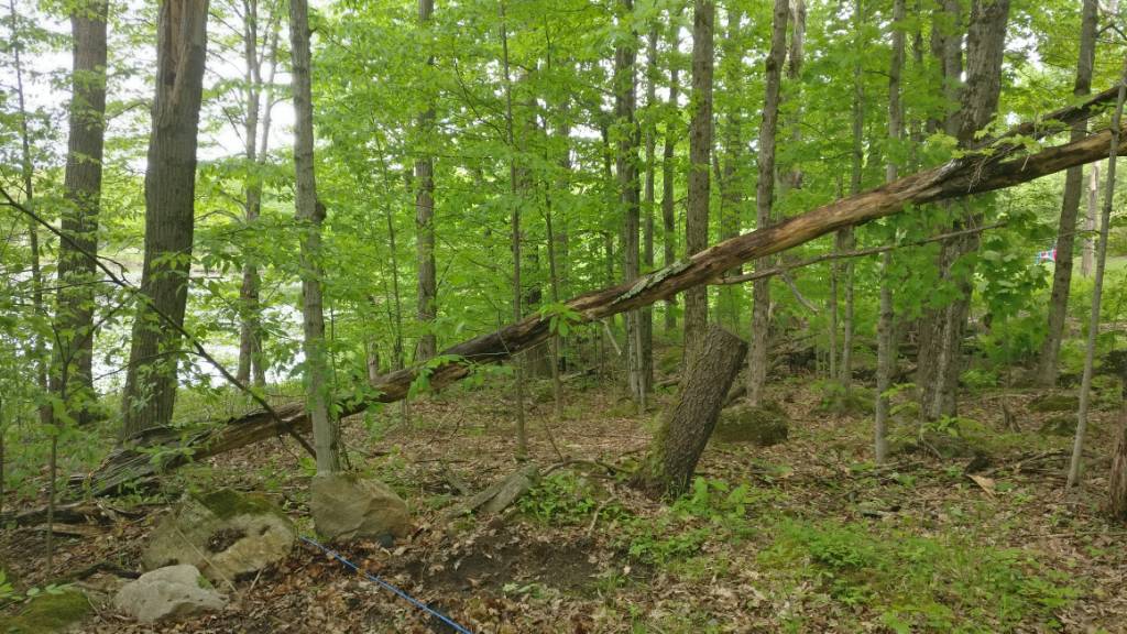

I need to start clearing some land, but the first thing I need to tackle is this wind damaged tree that has been hanging out like this for about 5 years.
Any suggestions on a safe way to get it down?View attachment 655037
As we look at that picture, ultimately how many of the trees we are looking at will be taken out? If that entire area will be cleared it would change the way I would tackle it.
Doug in SW IA
Good point, Doug. I missed that he would be clearing some land. If that's the case, tackling that tree would not be "the first thing" I did. I'd clear some of the area around it. Sometimes other options present themselves once the clutter is cleared. You'd certainly have a better chance of dropping it perpendicular to the broken limb.

I would just pull it horizontally with a long rope tied to 1 end. I doubt it would resist with a reasonably heavy machine.
You mentioned where it broke off...if there is a bottom 1/2 you are also going to cut down, you might weaken it a bit with the chainsaw. However I would not fell it with the weight at the top like that.

Looks like one could throw a rope over it and yank it down by hand from a safe distance away.
