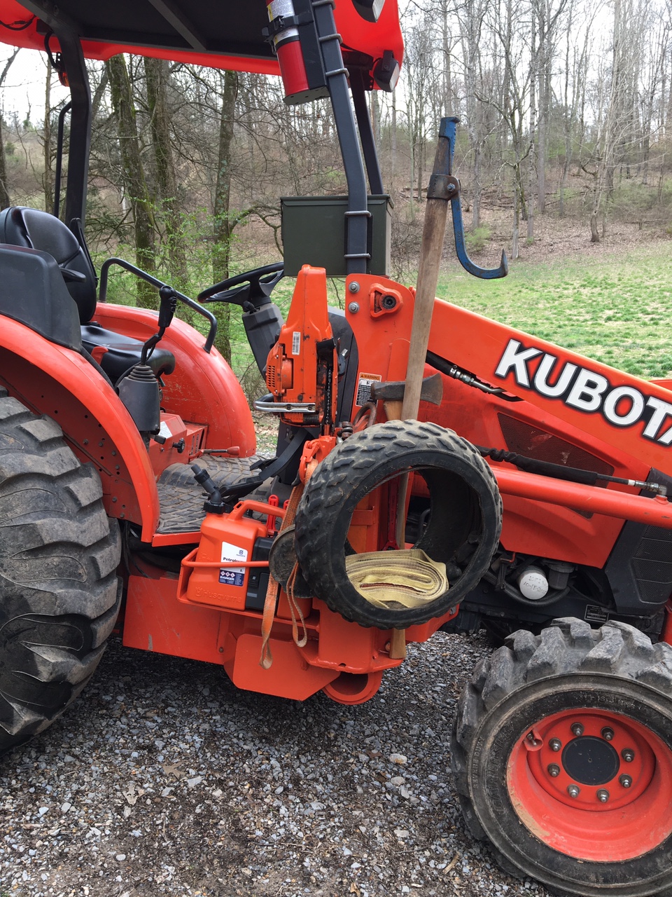

Using the tractor as a anchor and pulling with the come along was safer than pulling with the tractor with that rigging. You might consider 50-100’ of 3/8” winch cable to have on hand for the next time. Easy to handle/store in an old tire with one side wheel bead cut out. Distance is sometimes your friend.
That's a great idea! I'd like to get some longer cable, as the chain only adds up to 50 ft, and I don't want to put around anything longer than that. I've got a lot of trees down in our woods that are inaccesible with anything shorter than 100 -150'. I can't justify a logging winch for what would amount to removing 3-5 trees per year (after the initial cleanup). I had balked at the idea of buying cable because of the challenge of storing it in a neat and easy manner. Problem solved! Thanks.

That's a great idea. I badly kinked the cable on my logging winch last fall. 230' of swaged 3/8" cable with a nasty kink at about the 100' mark. I put a new cable on the winch. I've been meaning to cut out the kink and put hooks on the cable ends, but hadn't figured out how to store it. I'll try that tire idea. What size tire did you use? it looks smaller than a typical automotive tire.
Is there a Murphy's law that says, if you damage a winch cable it will be in the middle? I had a bird nest in my cable (don't ask) and only lost 5' to the angle grinder, right in the middle!
