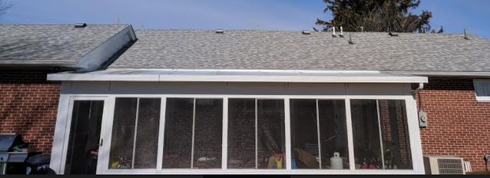

I feel the need for a little more space and this sunroom is not cutting it. It sits on a slab of cold concrete and it is more like a 2-season room.
I want to tear it off and turn it into a greenhouse and build a real 4 season room that is easy to heat. The pic of the white sunroom that comes straight off the roof is what I have and want gone. It also obstucts the view of my entire back yard because it sits about 2.5 feet lower than my dining room and kitchen windows.
The new room would be even with the main floor living area so I could see out my back windows again.
I don't know how to handle the roof line with the garage roof. I'm thinking of getting estimates just to have them do the roof and rough framing and I do the rest.

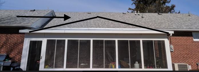

I have attached what I would like to do but not sure how easy or costly that will be and should I look at another method.
The existing sunroom is about 9 x 20. Long and narrow. I'm thinking the new room would be more like 12 x16 going out from the house more but not as long. I am not sure how I would connect the garage to the new room though.

I like the looks of what you want to do. Do you plan to wall it off from your main house and have something like French doors leading to it? Just thinking it would be nice to close it off while not in use during the winter months.
Being I only heat with wood, I always think of winter first and if it will be warm or not. :)
Vaulted ceiling? Ceiling fan(s)?
With your house roof having two tiers, it will be interesting to see how the new roof will connect. If it is like the picture of what you want it to look like, I suspect you will have to have it further to the right of your existing one to keep runoff ans snow from hitting the taller teir of your house roof. I think a updated flat roof coming off of your main house would be good along with a couple skylights. Maybe start the new roof further up your existing roof with less of an angle so that you can raise the overall elevation of the sun room?

I would probably extend the raised portion to meet the side of the new roof.

Yes, that is exactly the plan to have it closed off and turn the existing kitchen window into french doors. vaulted ceiling with ceiling fan.
I also thought about coming straight off at a higher elevation too. I am not even sure what just tying into the garage roof and bringing it straight across would do and would that cause my roof to leak in the valley.
I guess I need to get a contractor or two out to my house. I don't do roofs but I can do most everything else.

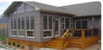

Love the look of the gray addition pic. Windows get very expensive very quickly, so a sun room is not a cheap project. But you can save a chunk of change if you design the room to use standard windows instead of custom sizes. When I replaced the windows in my log home, replacing with the exact same size window was like $500 a piece. But if I could go 2 inches taller, I could get them for $300. I went with the larger stock windows. I had to get new interior and exterior trim, but I didn't like the old trim, so that was no issue.

I would plan for a 'reroof' of that entire side of the house roof, trying to patch one into existing shingles almost begs for a leak.

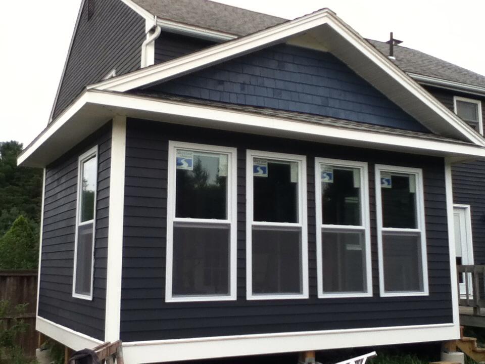

Glyford I really like the look of that. I am now deciding to put this project out about 3 years. Instead for now I am doing a garage extention for the extra space. I am still going to do the 4 seasons room though; just not this year.

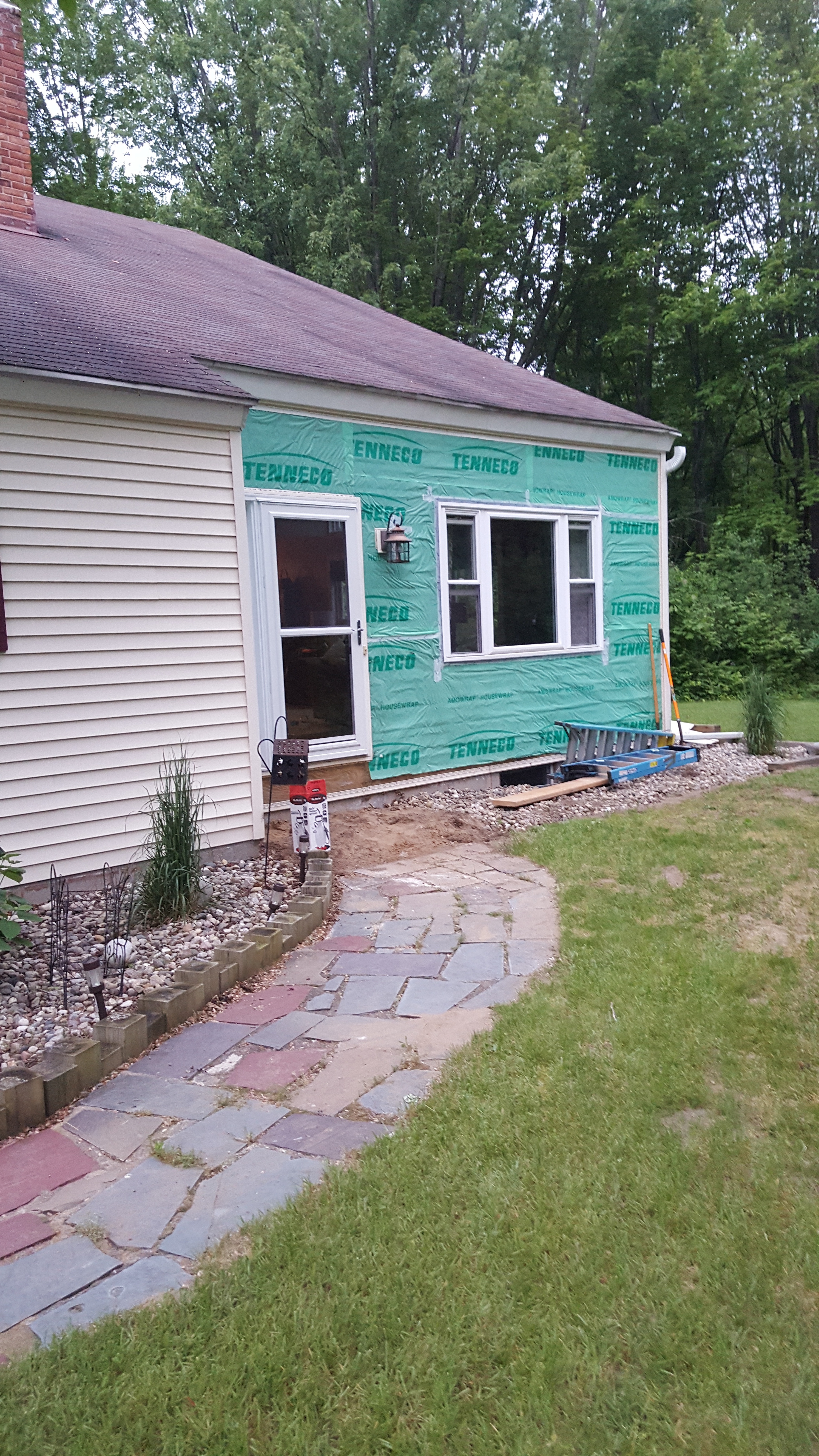

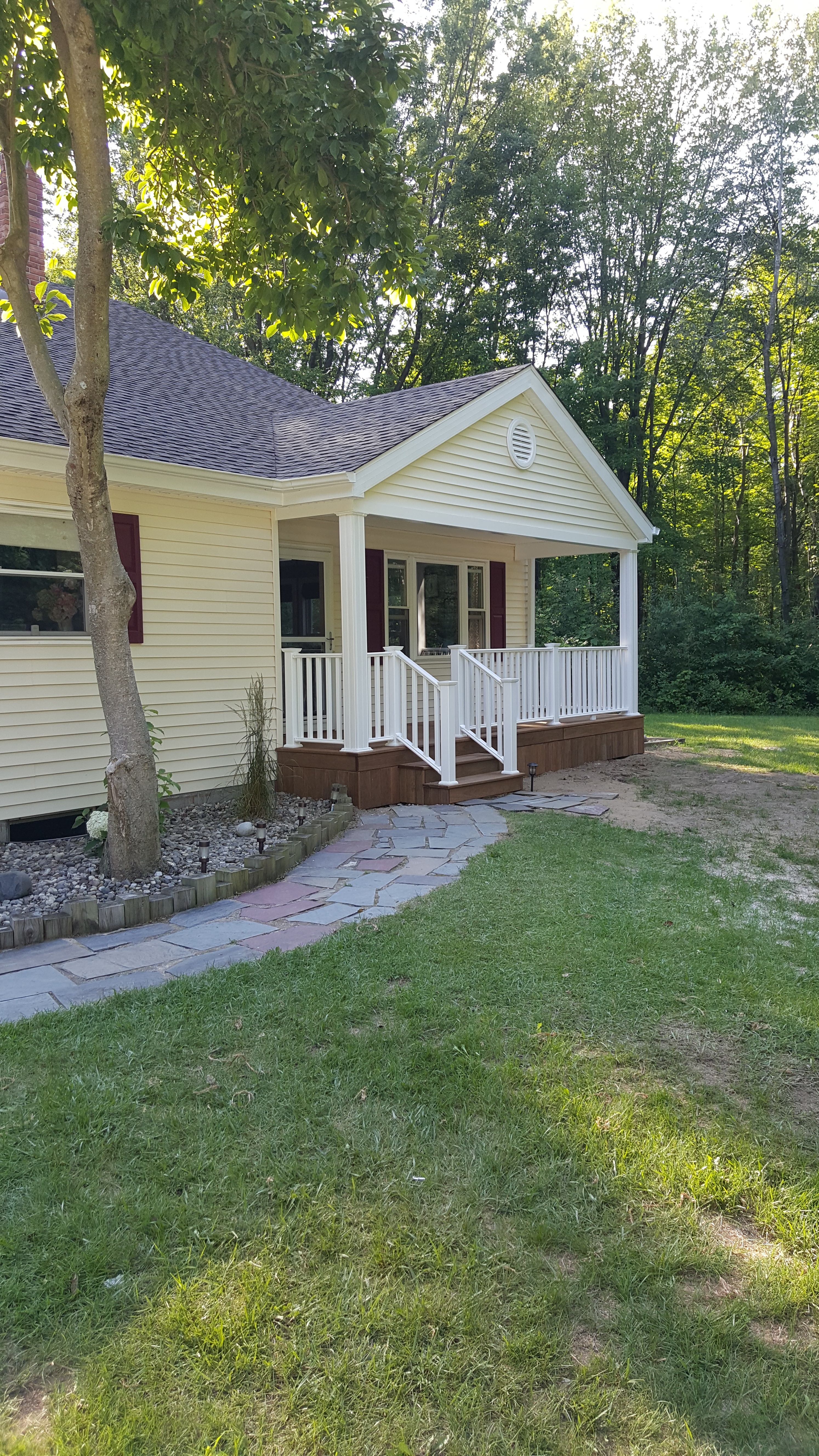

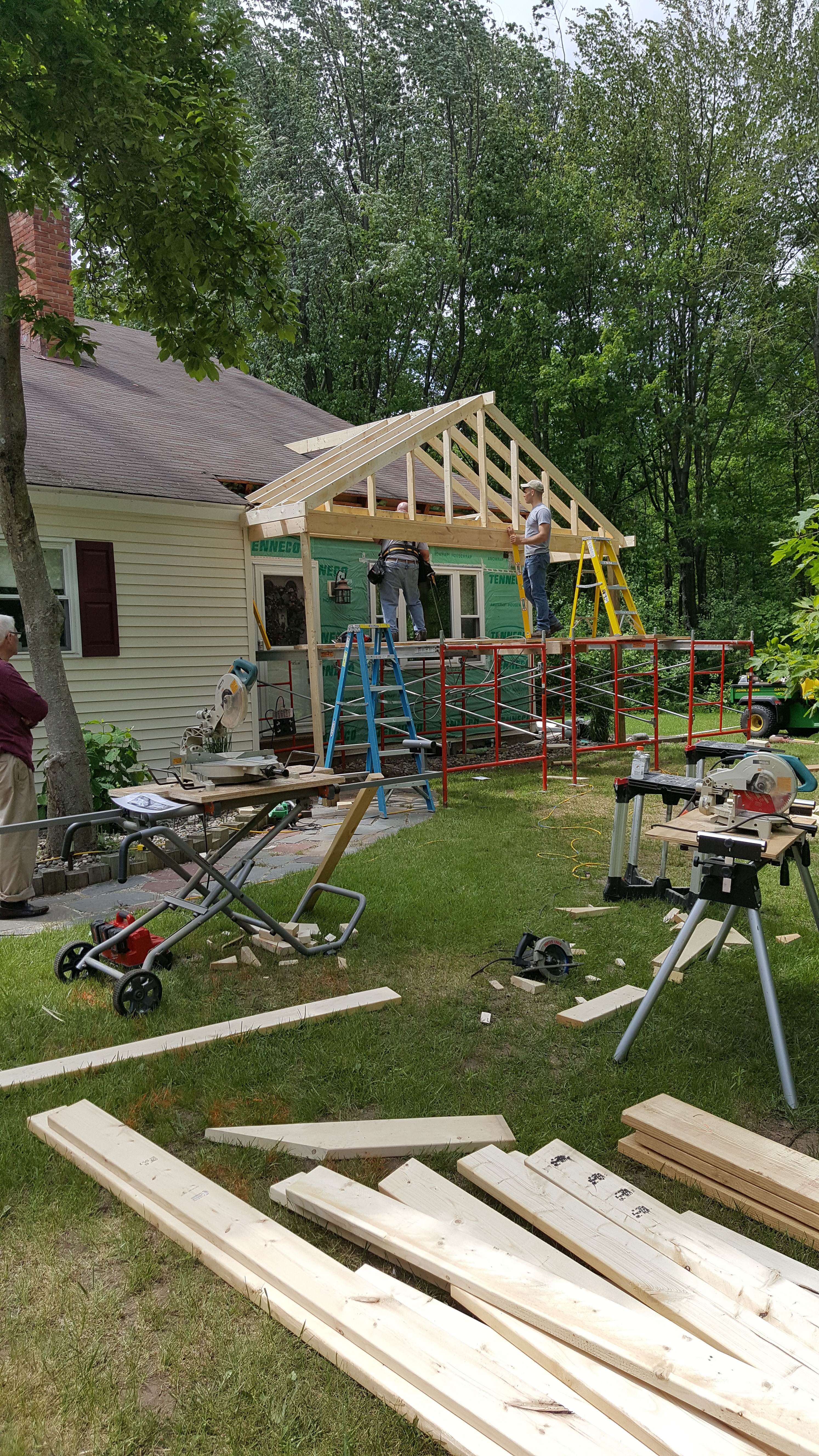

The wife wanted a front porch put on the house - see before and after pictures. I was roofing the house anyways - made the job much easier. We had the roof for the porch framed in a day.
