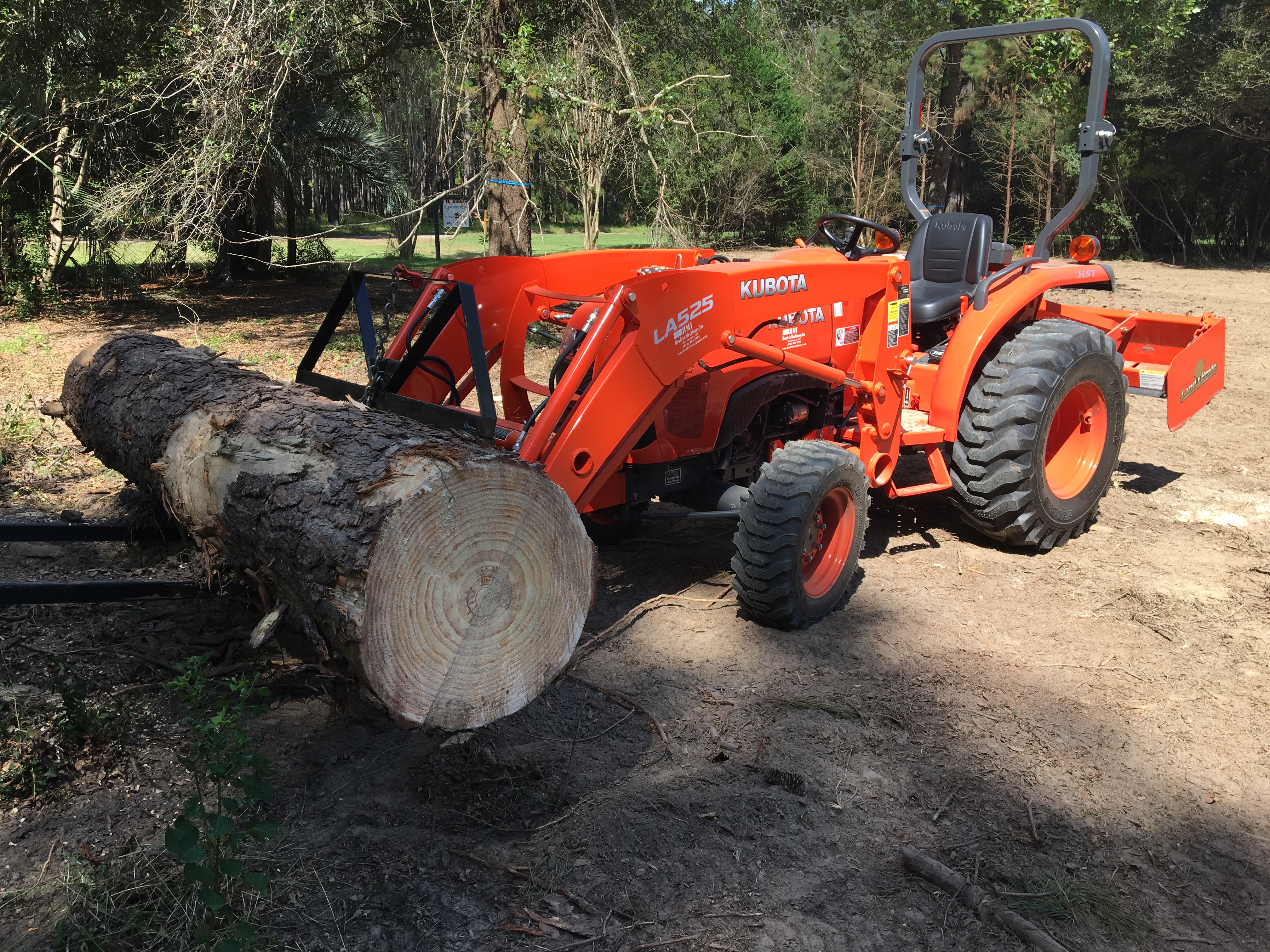

Properly counterbalanced it should be fine. It shouldn't be operated without a proper counterbalance as tempting as it may be. Not only is it dangerous, but it puts a lot of stress on the front axle components.

Economy Ls are very unsafe without proper ballast on the 3pt when using the loader. My former L3200 (same frame & weight as a L2501, L3301 or L3901) could pull the back end off the ground with loaded tires & heavy 3pt ballast. Fine machine, but the loader is stronger than the machine can readily be ballasted.

R4 tires, loaded, 670 lb box blade, maxed out load of wet dirt in the bucket (would only lift to grille height), and I have never noticed any additional steering effort.
The thought never crossed my mind.
Of course I did not try to turn the wheels while sitting still because that is not a normal operation.
I was moving dirt half mile down a logging road.

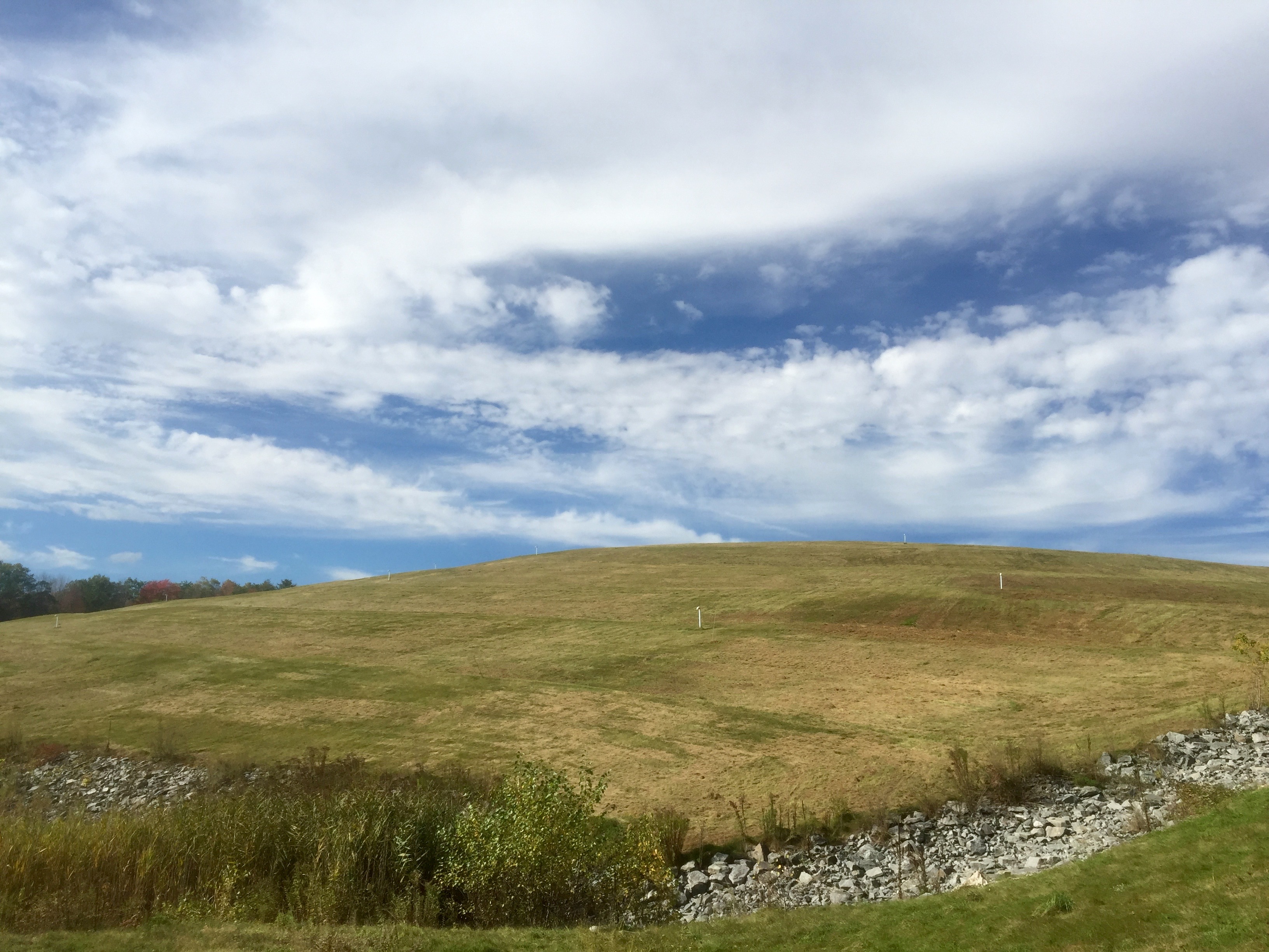

With R1/ag tires you will not be able to mow over turf without rutting. I realize you have not mentioned mowing turf as a need.
Really? Geez, somehow I manged to mow this 30 acre capped landfill on R1 ag tires and it doesn't look rutted up to me.
   / How well does the L2501 steer with a load on the loader? #20
Pretty sure he is talking about a weekly finish mow around the homestead.
Fields and pastures rough mowed once a quarter would not be an issue.
Driving over manicured turf once a week, you would definitely notice the aggressive tread lugs on the soil.
