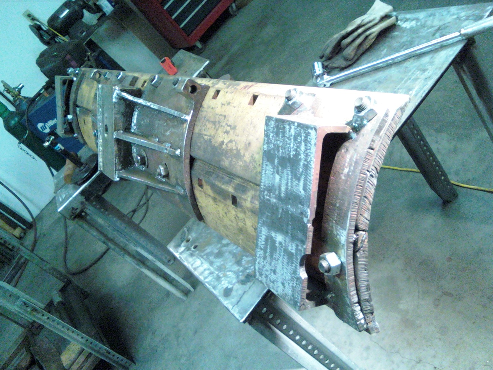

Thanks for the latest 2 cents worth - it is way more valuable than that. I am in the process of constructing a rear blade. That choice allowed me to justify a Hypertherm Powermax 45 plasma cutter to my wife :laughing: - wow - is all I can say about that.
JoeL4330 sent me a picture of his Landpride with all the bells and whistles and once I saw that, I was hard pressed to be satisfied with the most basic blade. That's probably a mistake on my part but it's in my nature.

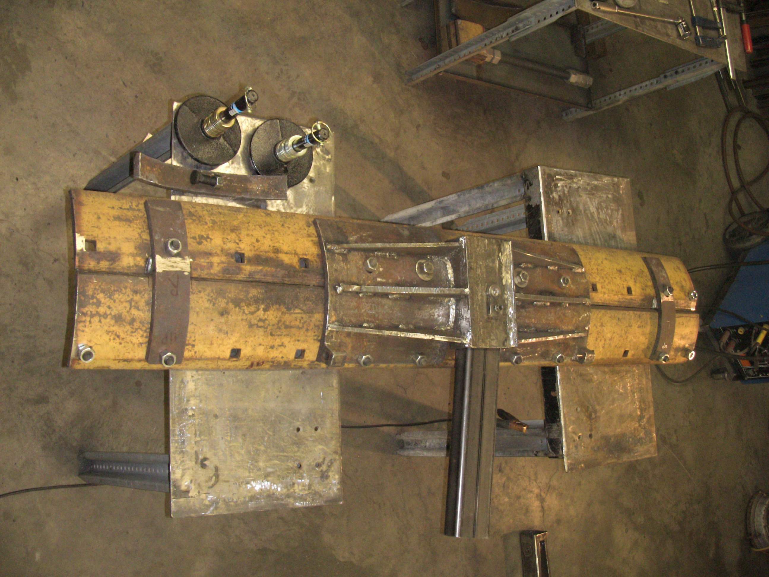

So here's what I'm doing. I'm kind of following the Landpride format with the option of adding hydraulics later. I have fastened two 7 foot x 3/4" thick blades (cut back to 6'-3" for my JD 2320, about 14" tall) together using 5/8" thick 23" diameter pipe cut appropriately as backing. Welded into this backing is a rectangular channel that allows the main rectangular vertical support tube to pivot, thus providing about 8 degrees of tilt either way. The blade can be inverted top to bottom to give me the choice of a very sharp edge or the flat worn edge. I have rightly or wrongly assumed that I can benefit from floating tilt with skids at either end of the blade and a guage wheel in the middle. It's too late to turn back on the tilt so we'll see (of course I can always just lock it at level - 0 degrees). All this is going to be over build and heavy but I have been assured that heavy is good.

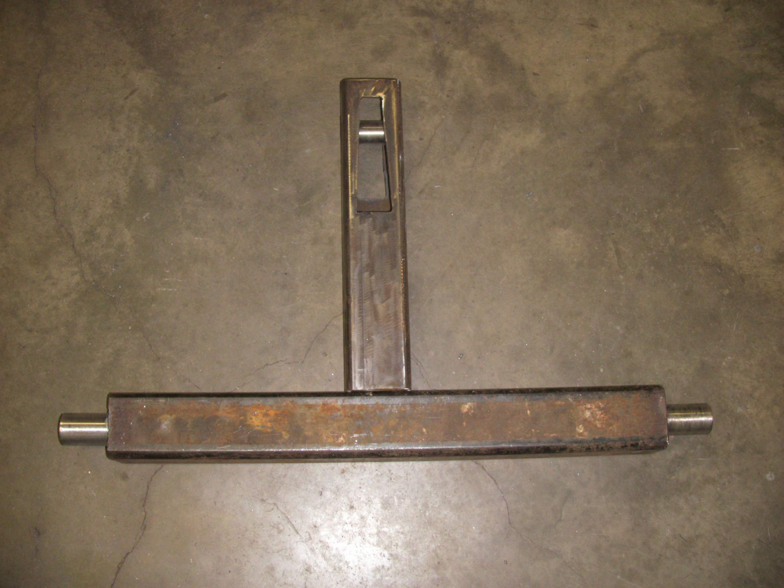

I also am constructing the main member that goes from the iMatch out to the blade so it can swing to offset the blade. To do this I will be creating taller pivot points for rigidity. The blade itself will also angle via a pivot point. The square tubing I am using is 3x3x1/4 beefed up when necessary.
After typing here for a few minutes I think it makes more sense to include the pic of Joe's Landpride because it, in scaled down form is my guide. And my daughter has just taken 3 pics of this grungy looking project (my camera is fried). Two are of the blade proper and one is the piece that attaches to my iMatch 3-point.
I am not a mechanical engineer, machinist of mechanic so can't claim what I am doing is particularly great but those of you that build things will appreciate that there is a small sense of pride involved (very humble pride of course :eek:) Caviat: 90+ % scrap material, including 23" D. heavy pipe pulled from my fire pit after 25 years of burning, grader blades found in county ditch etc.
Jack

Nick, I looked at the blade with the dual gauge wheels. They are not set up as "casters" but look like they do the trick nicely. I imagine you can't back up while they are down but that probably doesn't matter since you can raise the blade. I am just in the process of mounting the two skids on the outer ends of my blade and now I'm wondering if wheels wouldn't be better. For dirt or gravel they would be for sure. I had originally thought of one wheel in the center only. Do you use the wheels in snow?
Any comments??
Jack

Nick, Thanks for that - it seems "sensible" and it gives me more confidence going forward. Due to health issues, my progress is slow but determined. Because I don't want to have to revisit this in the future I'd like to get it right the first time.
Yes, isn't Joe's blade a dandy!!
My problem is obviously that in spite of having some "common sense", I've never done anything using a 3-point hitch with dirt or snow. Since posting the pics you viewed, I have completed two mounting plates that can be utilized to place either skids or wheels, and based on your comments, I will mount the skids I bought, but plan on removing them and placing wheels in the summer. I will drill and tap holes in the plates for the appropriate bolt-on mechanism. Perhaps the pair of wheels could be smaller ones with a larger caster in the center that is potentially hydraulic for adjustment on the go. On the other hand maybe three is ridiculous??
Any other readers have a sense of where this should go?
Jack
