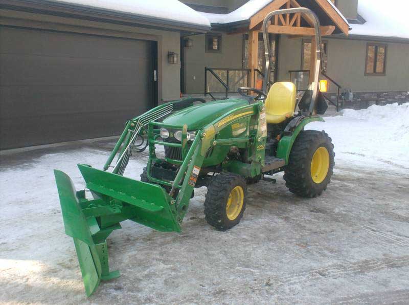

Here is a pic of a front blade made locally - $1200
I did come across a post making reference to Princess Auto and I have been a fairly frequent customer (in August a 20 HP, $550 discontinued gas engine went into my old Craftsman lawn tractor and saved my day - had to machine and fab a second shaft drive and go to a 1" shaft from 1 1/4") but haven't been there since getting into this CUT purchase etc. So that's one step I'll take, to start watching their flier adds and visiting sections of the store I wasn't typically visiting (and not always being in such a hurry).
