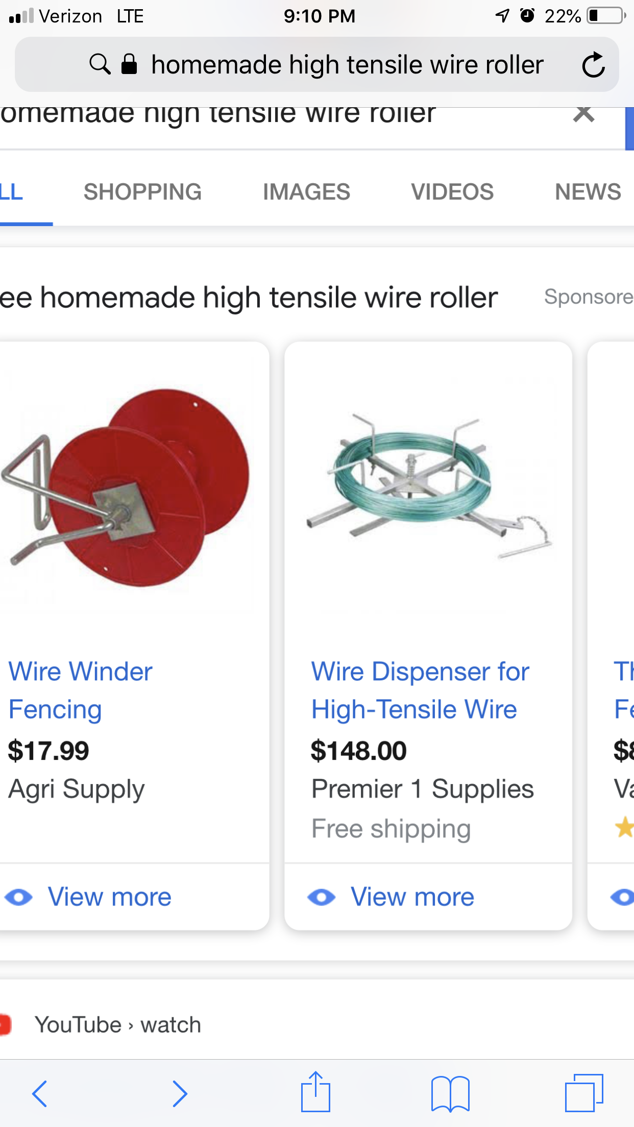

We used to do it by hand by making a loop and rolling it on the ground like a wobbly wheel. But you could make something like the one with green pictured or get a style like that. We used it for moving hot fence wire and it works great. It should work good for barb wire too. 26D7C54C-CBDC-4914-8D3C-EEB54B307A96.png
