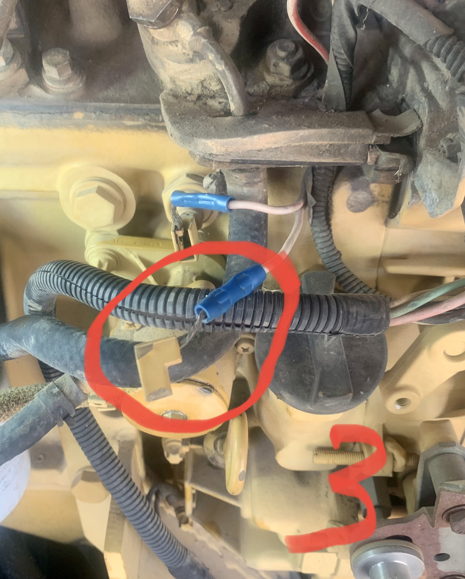

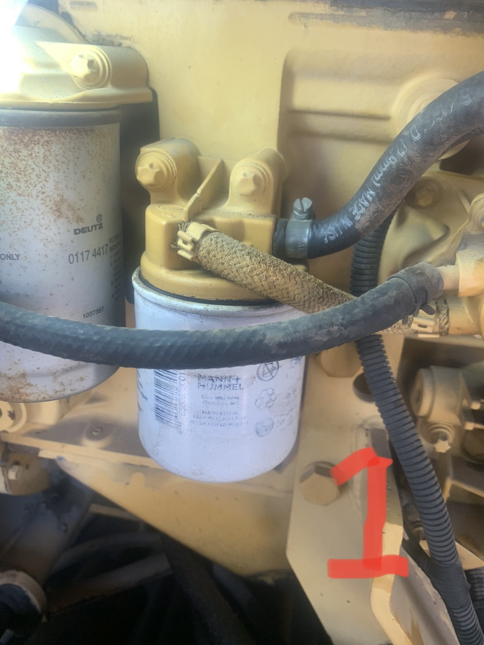

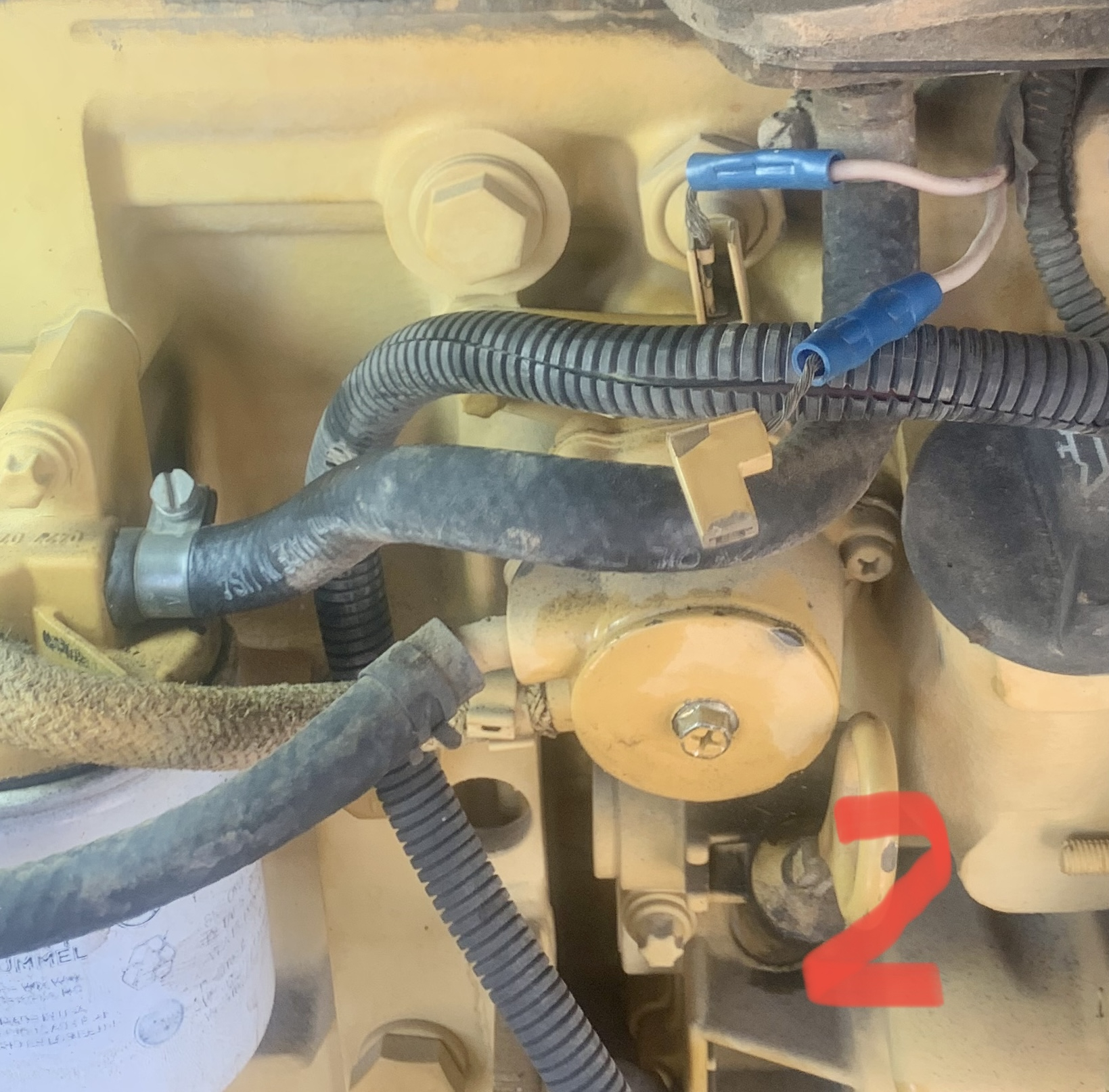

I have included pictures of the fuel filter, fuel pump and unknown wire that’s not connected.
I removed the output house from the fuel filter housing (pic 1) and turned over the engine about 60 seconds. Nothing is going to the injectors. Removed the rubber cover from what I assume is the the fuel solenoid (pic 2) and it was full of fuel. I can’t see any electrical connections on the solenoid?? It’s easy to get to and I’ve looked at it very close. There’s an orphaned wire (pic 3) and I can’t find anywhere to connect. It doesn’t appear to be factory based on the crimp. It’s short so there’s only a very limited area where it can be used.
The solution is probably in front of my face but no matter how hard I look I can’t figure it out.

I don't know if your Deutz is like mine, but I think a little to the right of picture three is the oil pressure sensor, that's takes a wire terminated much like the one you show. Does the wire have 5V or 12V on it when the key is turned to on?

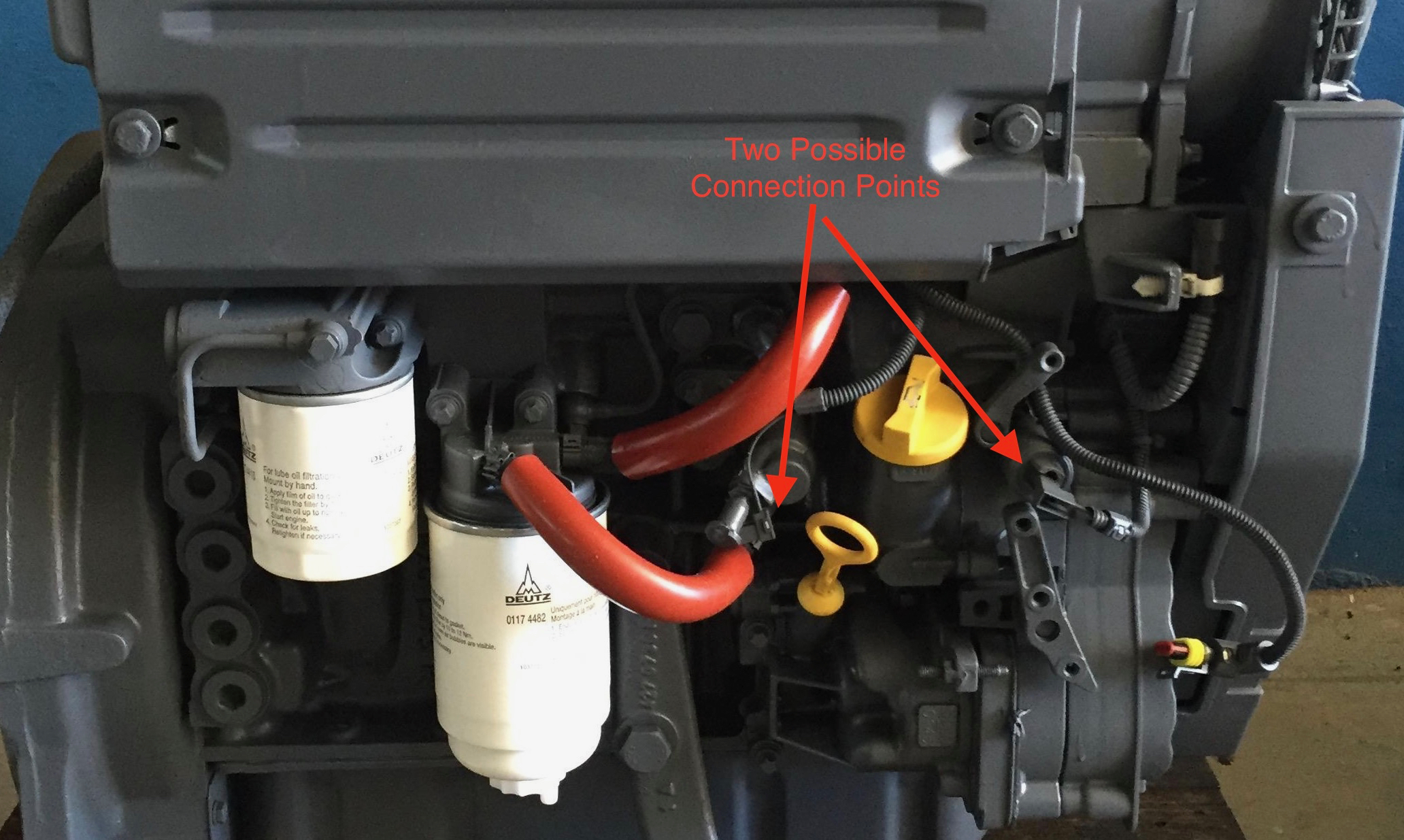

If you aren't getting fuel out of the fuel pump, (#2), when the engine is turning over, then check to see if fuel is going in. If you do have fuel going in, and no fuel out, then you need to service or replace the fuel pump. It is a mechanical fuel pump. It doesn't look like you have a prefilter.
I believe that the fuel shutoff solenoid is around the corner, nearer the fan belt, I think. The "L" shaped lever to the right in figure 3 is the manual fuel shutoff/emergency shutdown.

Your engine looks almost identical to mine other than the color. What’s your Deutz powering??
