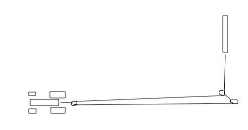

We have been using a cable and snatch block to pull trees down a hill and cut into firewood, so much nicer than falling and cutting into firewood where they fall. Actually with all the rain and mud we get we usally do firewood in summer. (new to this tractor thing, not sure how I got by without one). We have now logged all the trees that we have room to back tractor up from block. How do we connect cable to tractor once we have gone as far as we can and then driven back to block.. Is there sometype of connector that can be placed in middle of cable? Thanks

When you reach the end of the pull, back up to where you started, put another block on the tractor, tie off the end of the cable and pull again. The log will move twice as far with the same length pull. Slow down, as the log will also move twice as fast at the same tractor speed.
Or do this from the beginning if you don't need full power.
