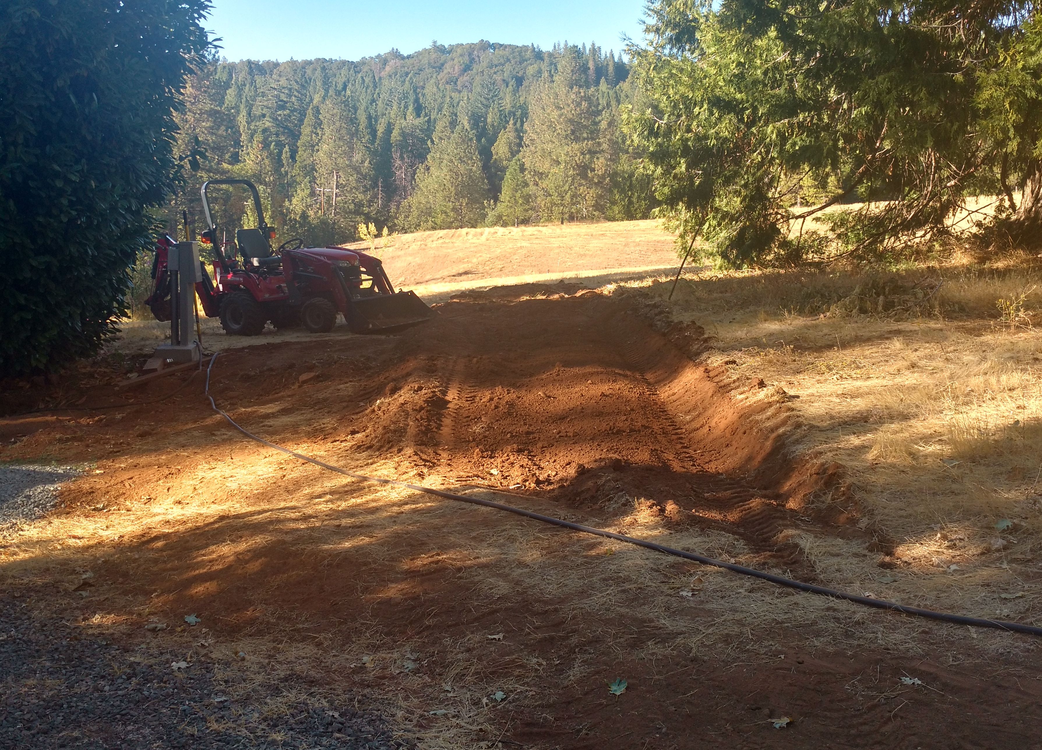

I want to create a level RV parking pad. The area has a slight side slope from right to left, and a slight upslope as you pull forward. I need to level both of those. I have a 40hp tractor, 6 foot box blade, landscape rake, and top n tilt.
I started by tipping the right side of the box down, then lowering the box and slowly moving forward. It cut into the side slope as expected. But it is not moving the dirt from right to left as much as expected-- either that are I am too impatient? Also, I only worked in one direction, back to forth, which I think might be a mistake.

What are your thoughts on moving a good portion of the dirt on the high side with your backhoe? I think you could get to grade pretty easily doing it that way. Otherwise, I'd just keep at it with your box blade.
   / How to use Box Blade on a side slope?
I never even considered that-- thanks! That's my little Massey SCUT in the picture and it does have a backhoe.
I'll try gently digging out the high side tomorrow with the backhoe, then bring the box blade into use. I think that will work well ... at least hoping so!

The side slope is gentle but (in person) looks a little steeper than how the picture appears.

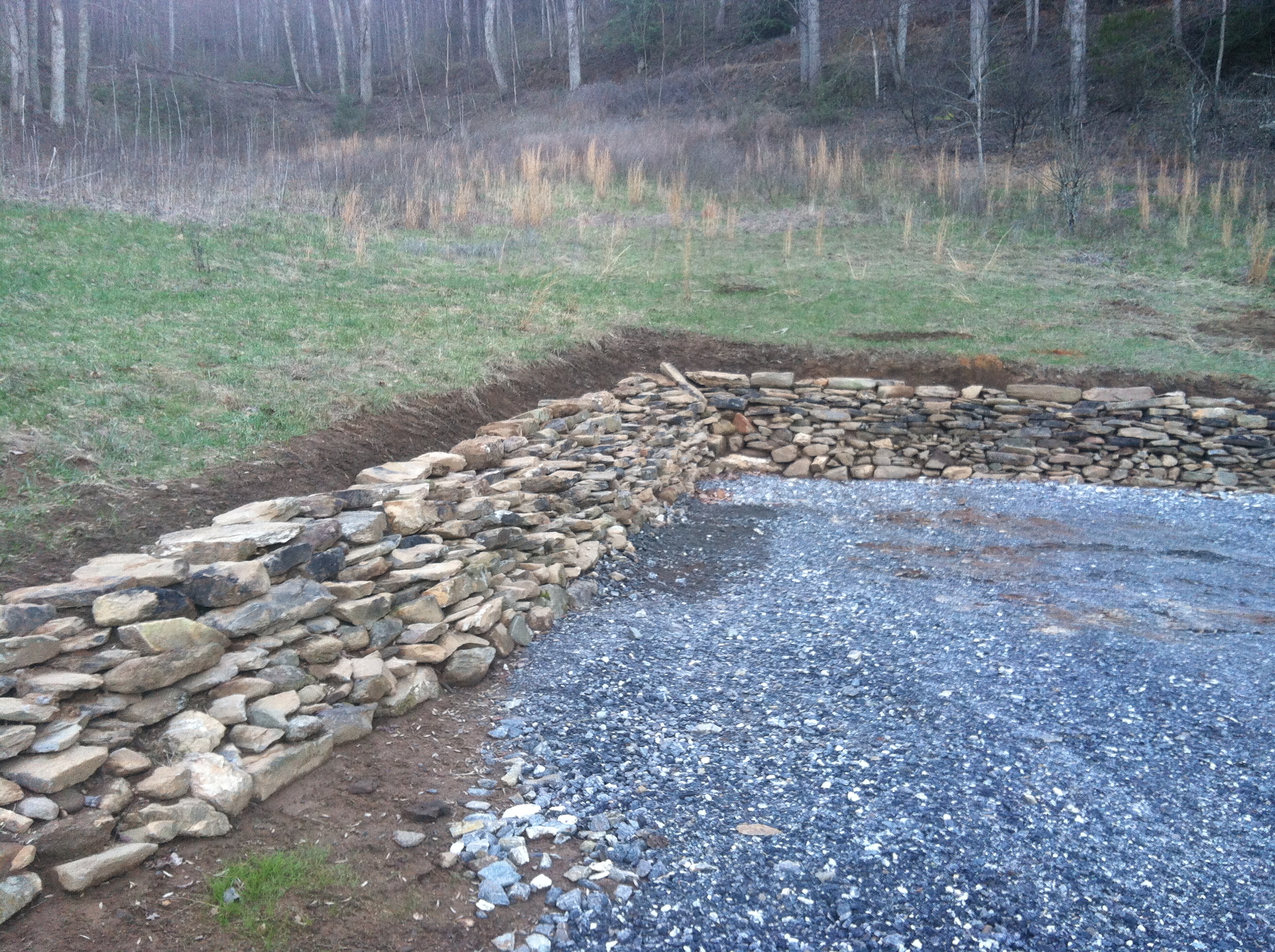

C3ECD8DF-CCEA-4942-98E6-BE9AA431B889.jpeg I did something very similar as my fist tractor project. I used my box blade with the teeth down and started on the high corner and cut the hill with the box tilted to the high side. I moved a lot of dirt and put it as far as I could from where I was cutting. I would periodically have to move or spread the piles with the loader. The base just kept getting wider until I had it leveled out. Then the wife and I stacked stones against the bank I had cut. No drainage behind the wall, but our soil is nice topsoil with some rocks already mixed in. We could still use a few more rocks... I expect they will show up eventually!
