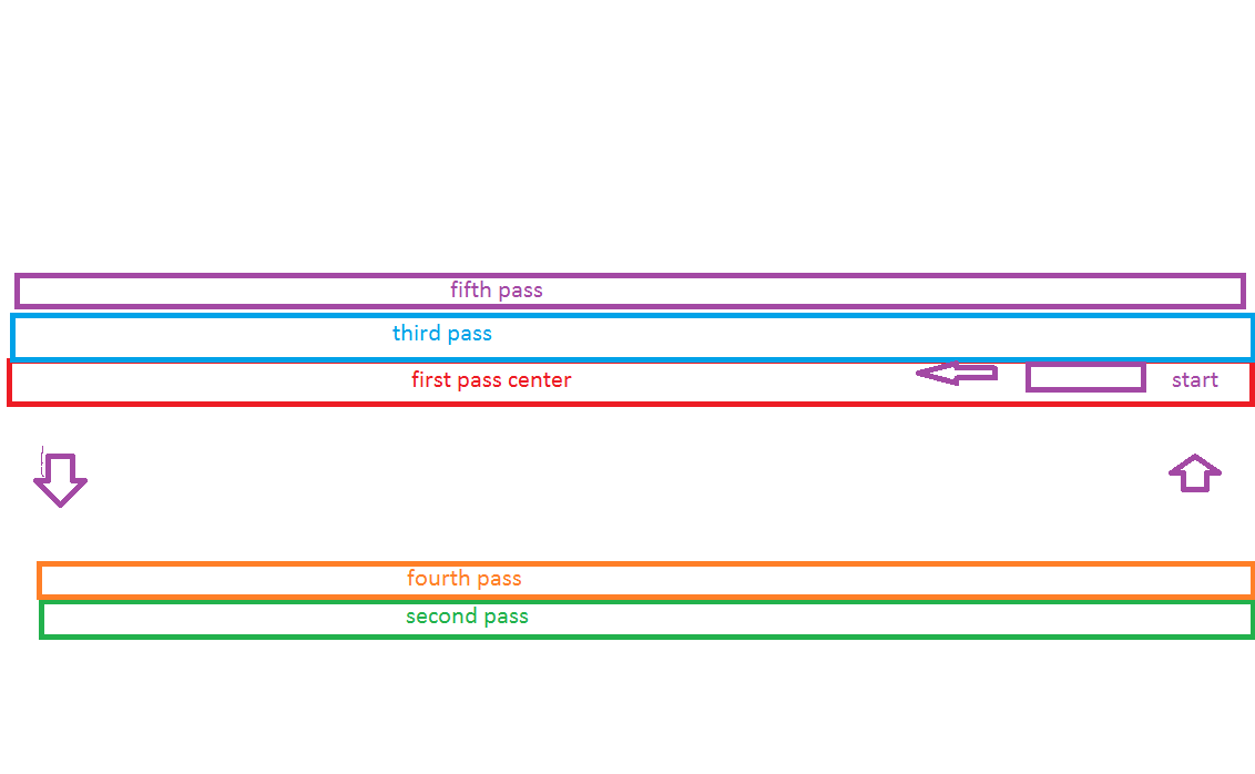

The way we work a field;make your first pass up the center and turn left,hit the out-side of the field always turning left,back to the left of your first pass in the center.This way you have maximum turning ability and cover the whole field.

Here is the way we were taught.Of course you have to plant the ends.Just continue until completed.This gives equal and maximum turn around area.We have some long and narrow food plots so this doesn't help there.
