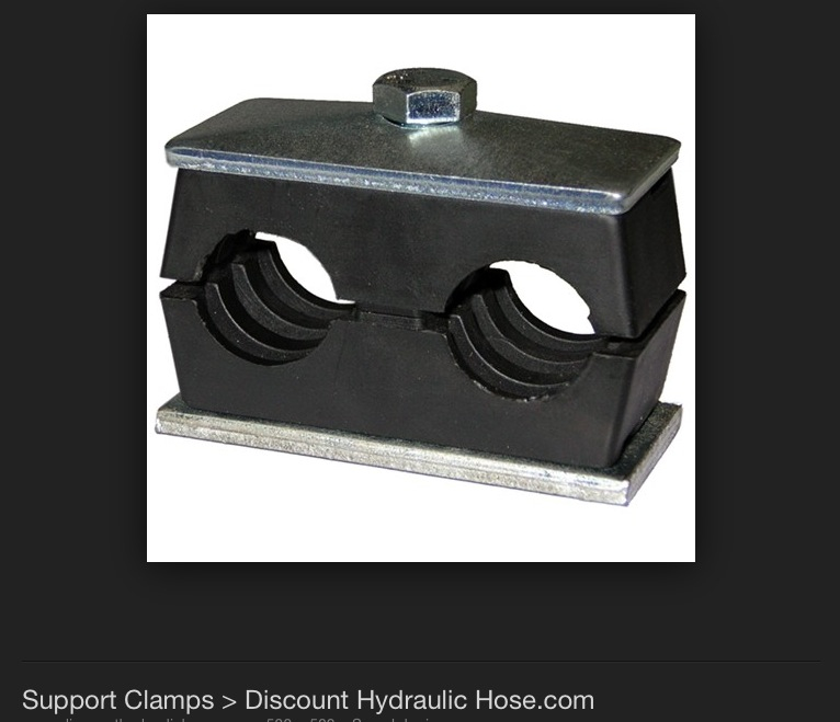

Buy some of these hose clamps and mount on top of the factory ones along the loader arm with longer bolts. Works out nice,
That's a good idea. Not sure I can mount them on the factory mounts, mine are hard line mounts, but will see if that works. If not I may use these anyways and mount right to the loader arm

I'm running a set of lines from my existing ports on the rear for now. I plan to use the hose block like Countrybumpkin suggested. I'm getting mine from Surplus Center. I believe I will only need to remove one of the existing bolts on the current hard line block and install this over and use a longer bolt???

I believe I will only need to remove one of the existing bolts on the current hard line block and install this over and use a longer bolt??? !
that is what I have in mind to mount my hoses. The fittings for the loader valve and the rear remote block should be here in the morning for my setup and I have the mount built for the solenoid valve to set on.

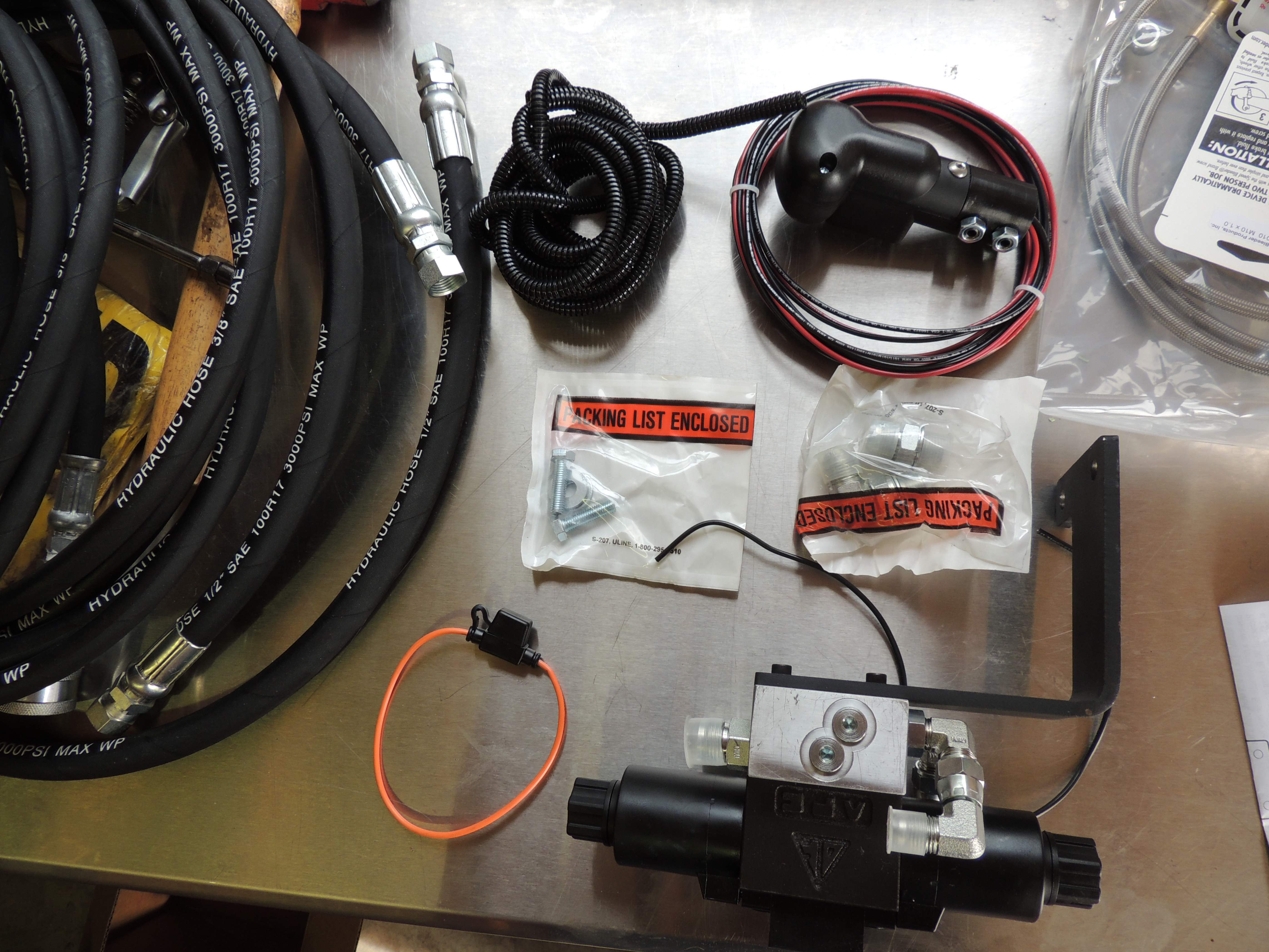

Here is the kit:
Started installing it today and have already ran into 2 problems.
1) The bracket with the 3rd function valve on it doesn't seem to be correct, seems it doesn't have enough drop to it causing the 1/2 lines to hit the underbody of the tractor.
You can see there is no way I would have had room to get those lines on if I mounted the valve first. You can see the bracket isn't flush with the rear mounting surface of the tractor.
I put the hoses on the valve first given there isn't much room in there to get a wrench on the hoses once you mount the valve.
2) Not sure how to get the current handle off the control lever for the FEL, seems to be glued on or something, no screw to loosen and I tried just unscrewing the handle thinking it may be threaded. No luck. Anyone know how those handles are mounted on there?

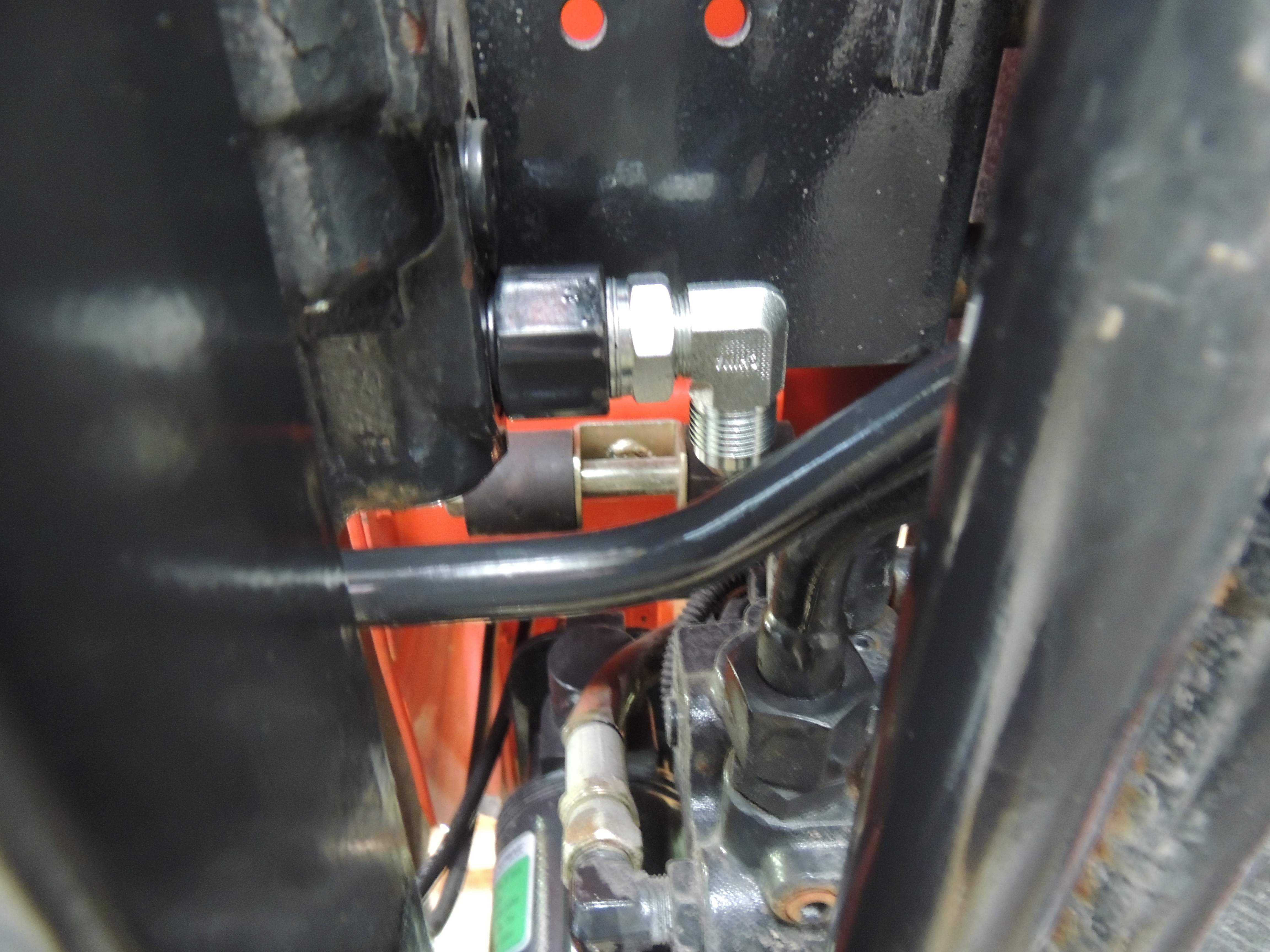

What I thought would be the hardest part, getting the old solid line off and new lines on the loader vavle was actually pretty easy. Here is the 90 degree adapter they give you mounted to the loader valve.

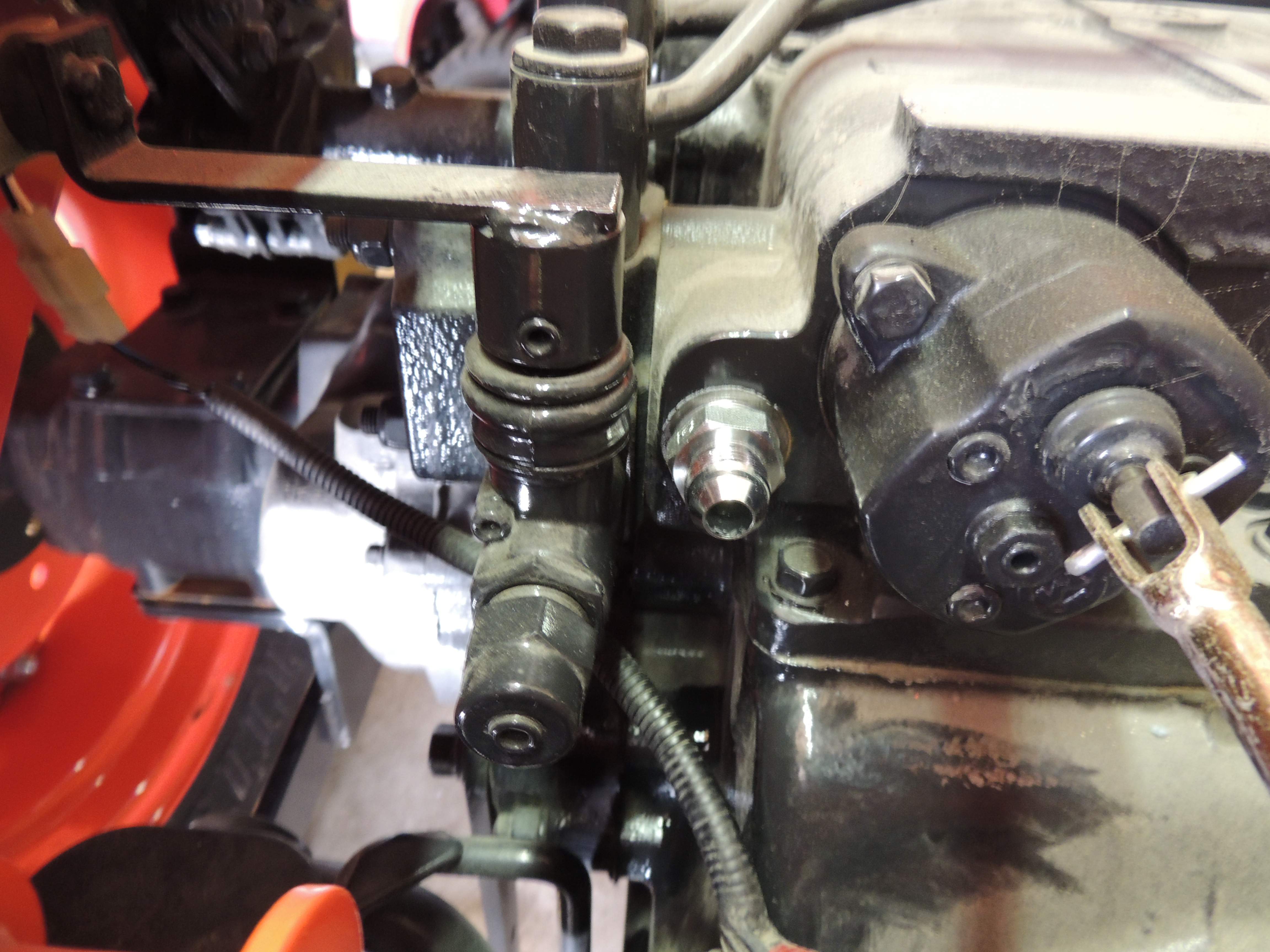

Here is the adapter on the rear hydro unit (this is where the power beyond line went).
These two pictures explain exactly what I wasn't sure of, thanks!
