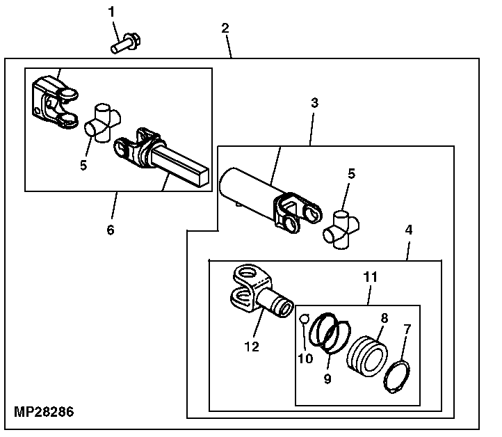

well, so far so good.. but.. not far enough...i can't find the '' sliding locking collar''...it eludes me...is the collar near the gear box on the mowing bed, or on the power transmission...??
is it best reached from the right o r left side? do i slide it toward the front or the back??
sorry to bother you again, but i need your help..
iowacorn.
/ how to remove the x744 62'' deck #8
i reach in from the left side of the tractor, where the
pto shaft connects to the output shaft on
the transmission, there is a universal joint, then
the coupler. the coupler has an outer collar that will slide
back from the pto (towards the front of the tractor) and
that will allow the rest of the shaft to slide off the pto.
if it hasn't been off in a while, it could be a little stuck.
sometimes a light tap on that collar might help it start
to slide, best maybe to get under with a light and look
straight up at it if you can get the tractor up on a block
safely
part #8 on the diagram

HAH................ GOT IT OFF!!!!
the video doesn't show the gear box coming off with the lawn mower deck.... my son-in-law came over and we figured out that we had to pull two pins on it to get it to release so's it could slide to the rear...took us a while, but we got it..working in 83 temp.. sweat like a stuck hog.. but the removal brought a grin to this 71 year old man..
again, thank you... might need ya for the reinstalling of it.. but at least i can eyeball it .
had to jack up the front end, tho...the gearbox on the mower deck wouldn't clear it out of the right side...
gotta go clean the deck.. again, thanks, dutch!!

no......... the pins we had to remove were on what i think are called the '' adjusting arms''......under the mower itself..we had to remove the pull pins to get the deck itself out on the right side..then we had to jack it up so's the gear box would clear the top of the bottom mower..
remember yer talking to a neophyte in regard to these machines.
we pulled nothing off the top of the deck...
