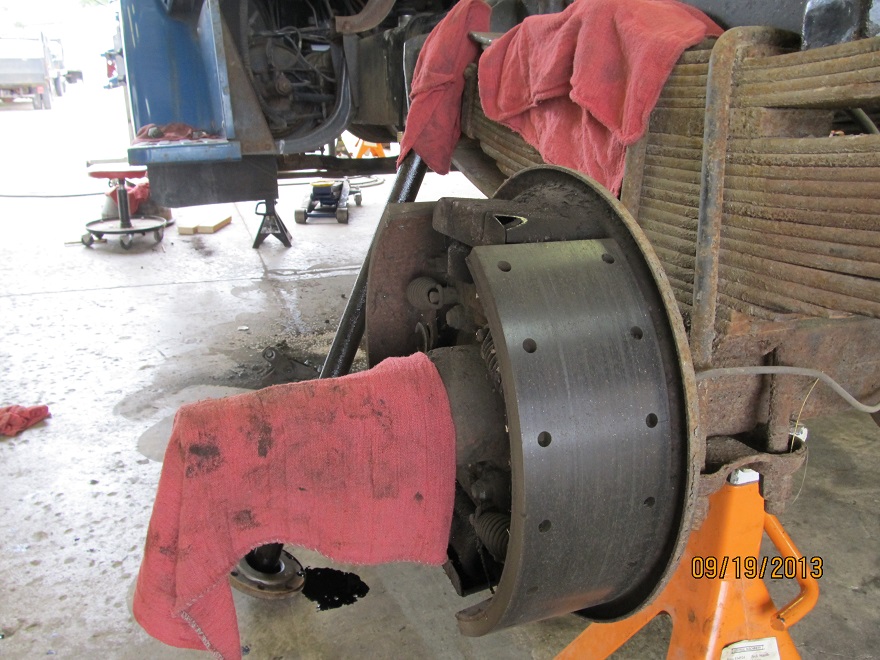

Look at the original 1967 brakes on it.

Thanks, OldMc, I needed a compliment right now. The truck should have been drivable this afternoon but there is a problem in the brake line right front. I replaced everything in the brakes and lines but could not find front brake hoses. Since they were in great shape I decided to leave them and find a pair over the winter. The parts are out there but not easy to find.
Anyway, one line doesn't work right and I might as well replace both fronts now. I have had to search brake lines individually on the internet tonight and there must be be 100,000 sizes and types. I've been at it for a few hours and maybe have found the right parts. That's the kind of stuff you do with older vehicles.

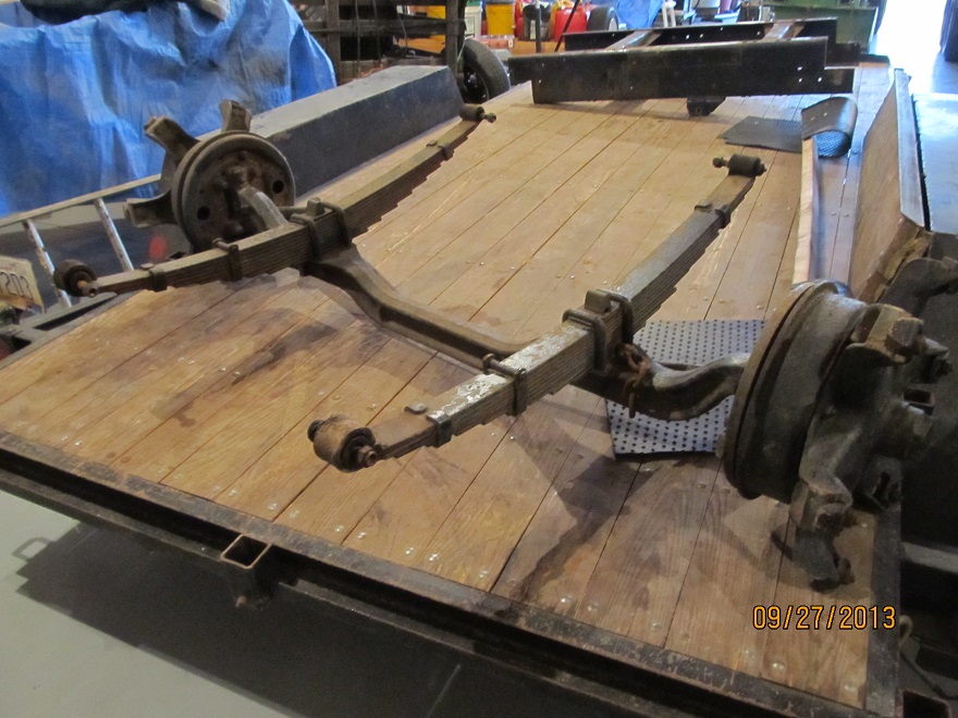

Forgot --duh--to take a picture of the "fishplate" that's welded to the inside of the frame. It's a frame within a frame and done right. The plates cost me $150 to have made and bent. It will get bolted as well but I need to get it home for that since I can drill a hole as good as the next guy. That frame isn't going anywhere.
EDIT---The piece of frame I took out is in the background of this photo. In the front is the "tag" axle that was on the truck and is now for sale with tires and wheels. It would also make one heck of a trailer.
