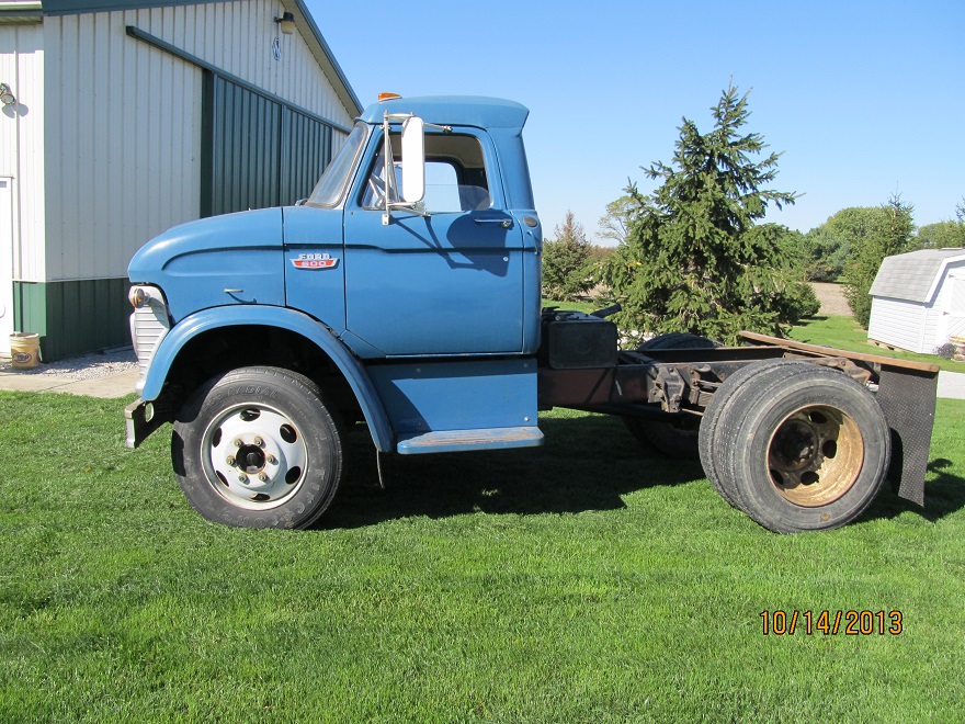

Yesterday I was on crags list and found an old farm truck , looks like yours, 69 Ford N600 with an 18ft dump box, it has been stored inside and covered with dust.I was thinking it would make a cool car hauler.
Dave
Yes, plan B for me was to get the correct ends on the hose and then a universal and correct length hose in the middle. One of the problems was the inside diameter of the hoses was not the same as OEM for the truck.
If you can buy an N600 that's in good shape for an honest price, buy it. There seems to be a cult following for these trucks and, unless you grossly overpay is hard to lose money.

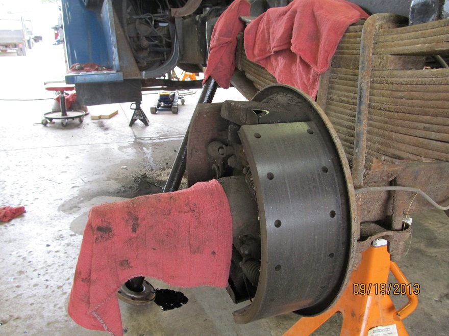

Look at the original 1967 brakes on it.
Good Mornin sixdogs,
WOW, those brakes look like brand new, the shoes need nothing, are you going to change out or rebuild all the wheel cylinders ? Maybe some new springs ?
Thanks for posting...:)

All new wheel cylinders, rebuilt Hydrovac, new master cylinder and all new lines. New brake hoses. Clean up the brakes, shoes and springs and lube underneath correctly. Now I feel better.

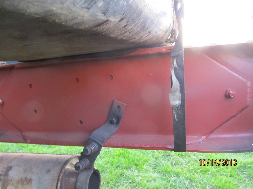

Here's a photo of the "fishplate" inner frame piece I had welded to the inside of the frame. It's a frame within a frame. The holes are for bolts and I had 10 holes--maybe 12--punched in each side and I'll drill the other half of the holes ASAP. The plate is maybe 2 1/2' to 3' long and it's not going anywhere.
This is a more complex project that I first thought because all the parts are interrelated and it's difficult logistically. One thing leads to another sort of thing. Plus, it's hard to find four friends at the same time to fit the pickup bed to the body. Actually it's hard to find four real friends in life but that's another story.
Anyway, here's the fishplate.
