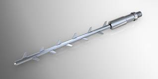

Look up a tool called 'pipe dawg'. Theres one on ebay. Looks easy to fab yourself. If you have access to the open pipe, make a cone shaped 'pulling grip' tool. Google Images search will get you some images. Essential when I dabbled in old farm windmills. Use a laser pointer to try to view the top section.

I haven't read the thread, but here is what I'd do to recover the pump.
1) $80 for a Chinese inspection camera with a long wand (I already own one).
2) Weight the camera wand so that it wants to stay in position while looking at your sunken pump.
3) Make or weld a hook/loop out of a muffler/pipe/U-clamp big enough to slide under the pump, yet small enough to hook under the pump that tries to keep the U part on horizontal for easier nabbing.
4) Go fishing. Patience as though the well company would charge you $500 per hour to do the very same thing you are doing.
5) After hooking under the pump, winch the pump back up.
6) Tie the pump off and secure it from falling back into the 6" casing before doing anything else to it.
