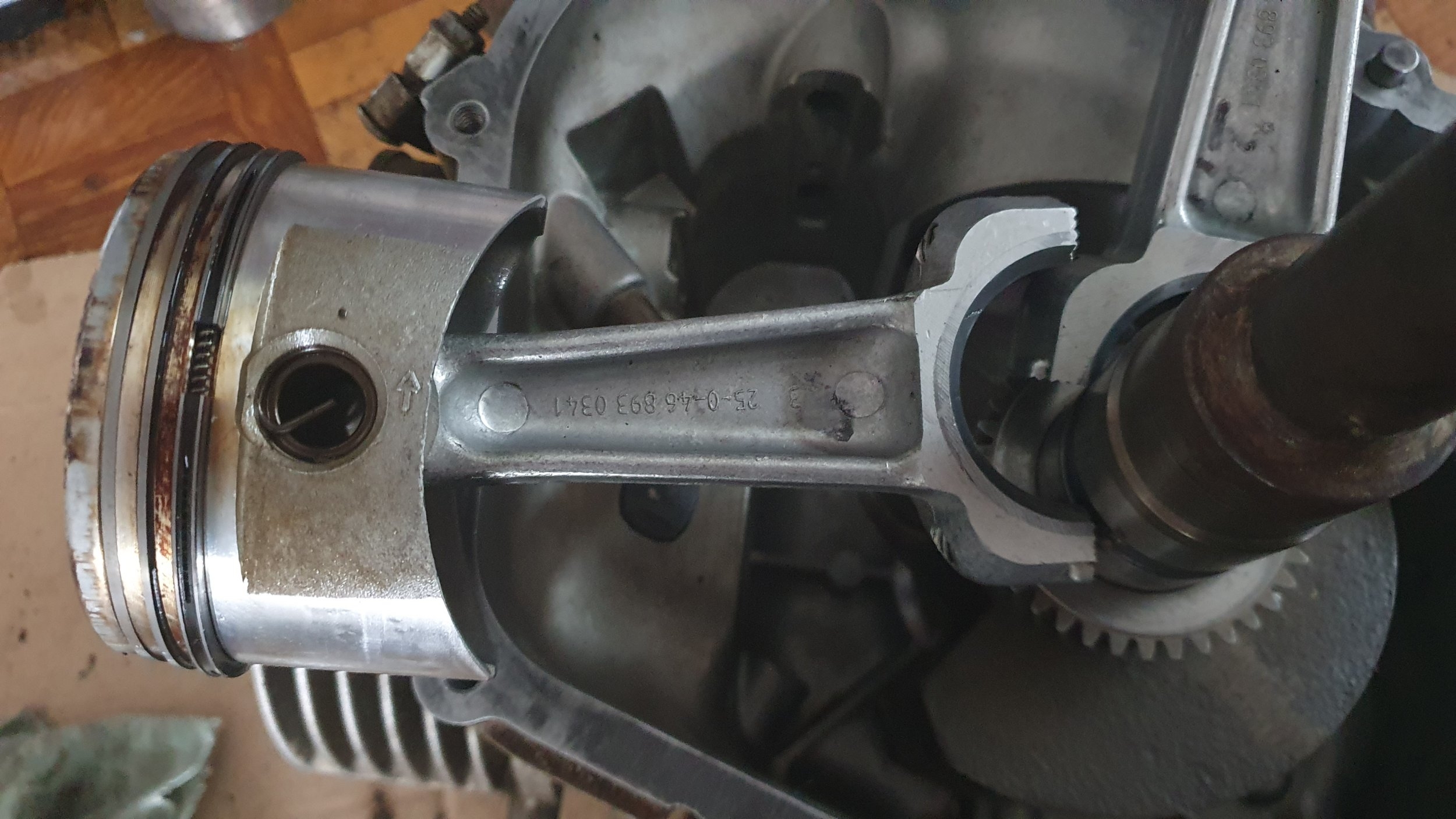

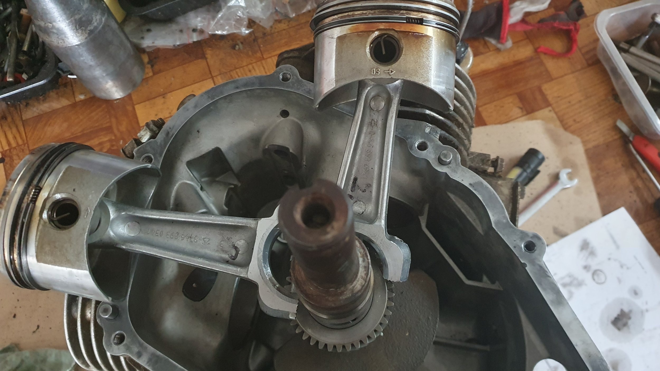

I greet everyone, I am asking for advice. How to properly install connecting rods and pistons on an engine tecumseh OV691AE.
where should the arrows on the pistons and the marks on the connecting rods point?
have I placed them correctly? on this picture
thanks you

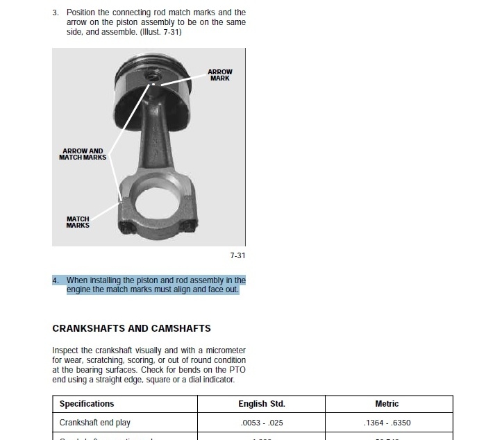

   / How to properly install connecting rods and pistons on an engine TECUMSEH V-TWIN #4
Here's one from another Tecumpseh OHV manual...

I found a service manual for this engine but I don't understand this sentence.
what does it mean FACE OUT?
not to push rods?
not to push rods?
I'm not a mechanic mattock, but my "guess" would be away from the main engine mass and towards the outside of the engine. Based on Flyerdans posted picture. Good luck with assembly!
   / How to properly install connecting rods and pistons on an engine TECUMSEH V-TWIN #7
I think if you match the index marks on the rods with the piston arrows, and install the pistons with the arrow facing correctly it will sort itself. I would peruse the book and see if there is something regarding the pistons having one arrow only --> and the other with OS-->, that might be critical.
   / How to properly install connecting rods and pistons on an engine TECUMSEH V-TWIN #8
I would guess they are to be oriented towards the outside, not towards each other.
Ak by to niekto v budúcnosti hľadal, je to vyriešené. Rozobral som ďalší motor Tecumseh a obe šípky by mali ukazovať doprava. Ďakujem za všetky rady, pretože to nie je jasne napísané ani v servisnom manuáli.
