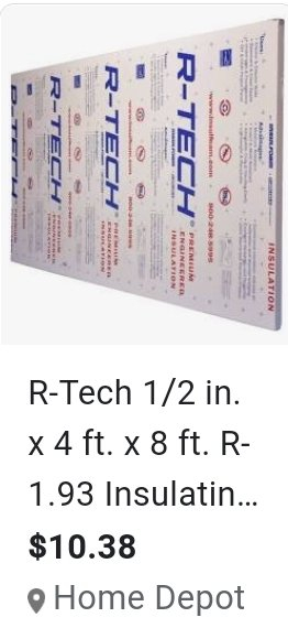

Do you have a well house? We do and I discovered a solution it will help you or someone else since I had years of frozen pipes. Get some reflective foam insulation panels, one side is mirror-shiny. I put a light socket in well house with 60 Watt incandescent bulb. Panel cut to fit, mine is cinder block, top tilts up. Panels reflective side down. This morning I checked and lifting a panel it was toasty warm, I'm guessing 60°F and 9°F outside.View attachment 776278
Buddy of mine had his mother call him because she lost water pressure. He figured the light had burned out, like it had, once before, but no. The light was still on, then he noticed that his mom had replaced it with a LED light, you know, to save power...... Same mother that put paper bags over the phone, because the local radio station had put out a warning that the phone company was going to blow out the lines, on April 1st.

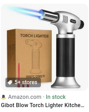

Good to know about the butane lighters. I always carry a box of wooden matches in my truck, which usually gets the lock unfrozen.
Went to check the camp on Christmas Eve and turn the heat up. Gate lock was frozen solid after 1.5 inches of rain, then a flash freeze. Match did not work. Wrapped some post it notes around some match sticks and tied them together with some dental floss. Still did not work so I just decided to walk to the camp.
The lock has been on that gate 25 years. That was the first time I could not get it unlocked. I figured I would buy a butane lighter, but after reading this thread I guess that is not a good idea.

The lamp would even work better with fuddyduddys suggestion about the reflective panels.
