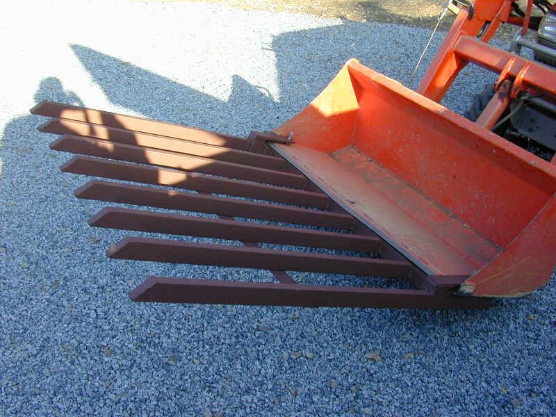

Couple of things, attached is a pic of my brush forks. I don't have needles but they work great on moving raked and piled native grass cuttings.
Second, as with a manure shovel, if you have deadman to ram the shovel into, usually you can get a full load. Sometimes I drop my box scraper at the pile and push into the back of it.

HomeBrew2,
I like your brush forks. Did you make them and do you have any construction details?
Unfortunately, I can't get to all sides of my pile and there is nothing to push against.
/ How to pick up pine needles? #9
Well, I thought I had a dwg file of the forks, but I'll be darned if I can find it now. Theyre about 3' long and made of 1" x 2" x .0625 tube. Yep, pretty light but they take a beating and I have a small machine. Feel free to PM me if I can help any further. Many other folks have made brush forks posts as well.

I agree. Homebrew2 that looks like a very useful setup. Hmmmmm, some future project for my welding machine I think.

HomeBrew2, I sort of copied your design and made myself a set of brush forks. I have a friend who has a MIG welder and he showed me how to weld with it. I've only done Oxy-Acetylene before and I'm not very good at that. It turned out pretty well for my first such project. I used .092 1x2 tubes the steel cost $75. I also bought my friend a refill on his gas tank for $20.
Here are some pictures.
