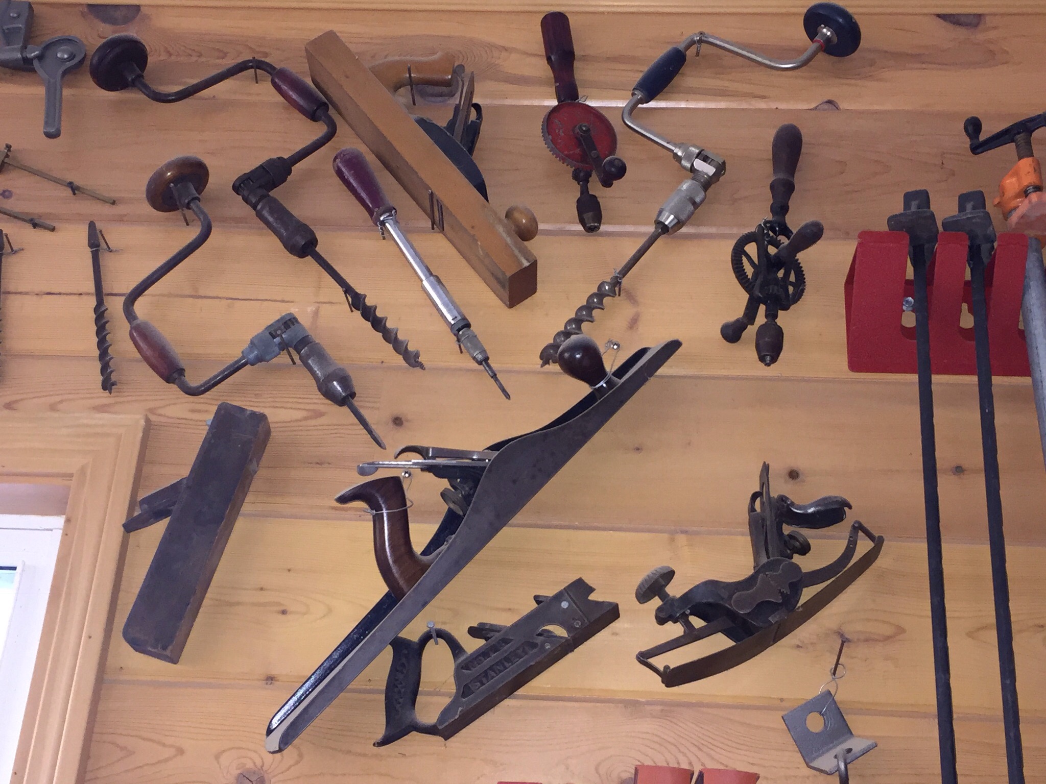

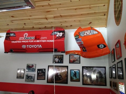

I finished off one of the ceilings in my shop with t & g knotty pine, 1 x 6. The boards I was using were 18' long. I set up aluminum pick planks through good stepladders to span the length of the ceiling, which was 36' I could walk along the planks and do about 3-4' of width before moving the setup. 15 gauge finish nailer worked well, nailing through the male tongues on an angle. I had to cut out around multiple outlets. I used my hand held jig saw. The area I did was 28' x 36', cathedral ceiling, 15' high in the center. Started at the lower edges and worked up to the center. Measured every so many rows to make sure I wasn't running off. Keep a wood chisel handy, some of the boards will be bowed a little. Set the board in place, drive the chisel into the joist where it's bowed and lever it into place, chisel in one hand, nailer in the other. It's actually a fun type job. Here's a couple pics, one is the ceiling in my auto shop, other is the walls in my wood shop.
