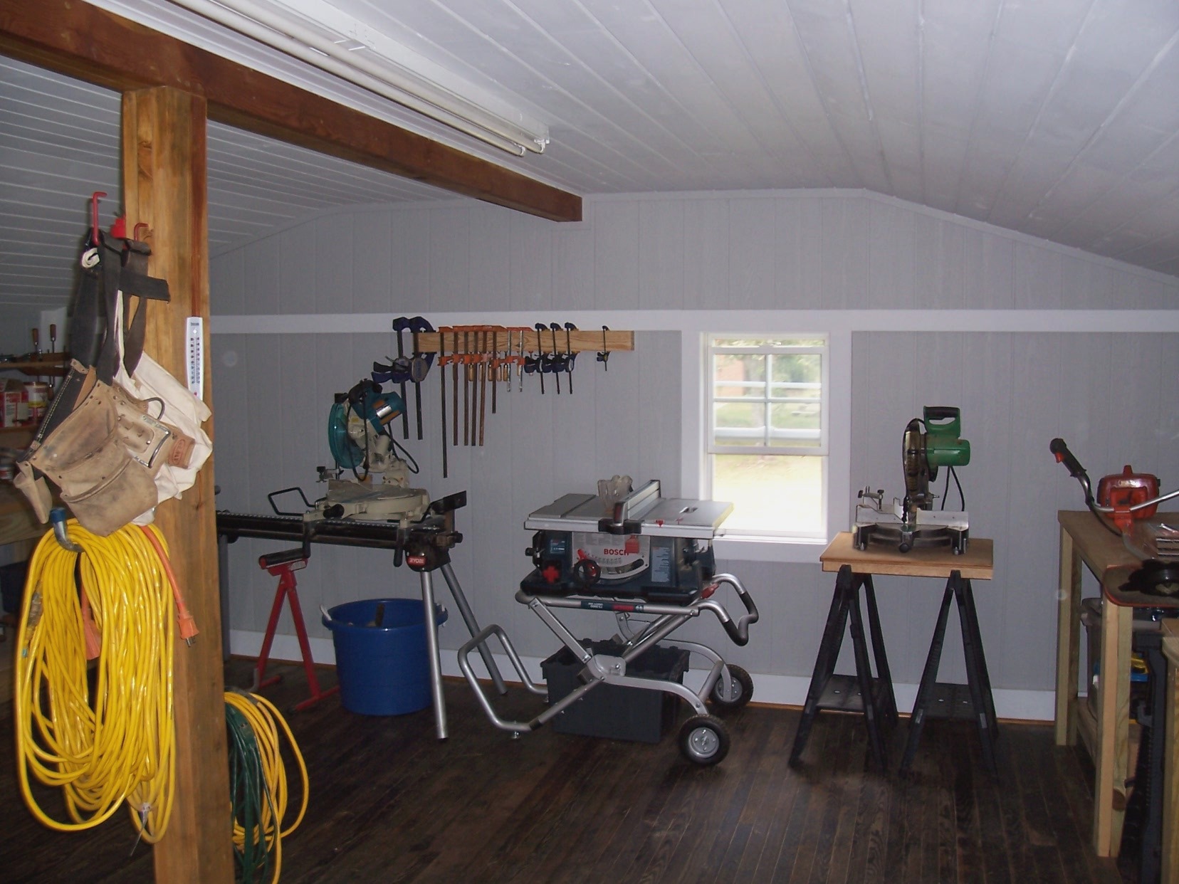

I used T&G pine for the ceiling of my shop (the second floor of an old farm outbuilding that I rehabilitated). I used a Paslode finish nailer to face nail the 6" boards to the rafters and collar ties, 18" on center. The attached photo is from 2009. There have been no sagging problems to date.

smstonypoint - that looks very nice and the white paint job helps with the illumination. OH, MY - I just noticed - is that a solid oak floor. I do like that and the dark stain you used on it. I don't ever remember a shop being so clean - I think that's cleaner than my kitchen.
