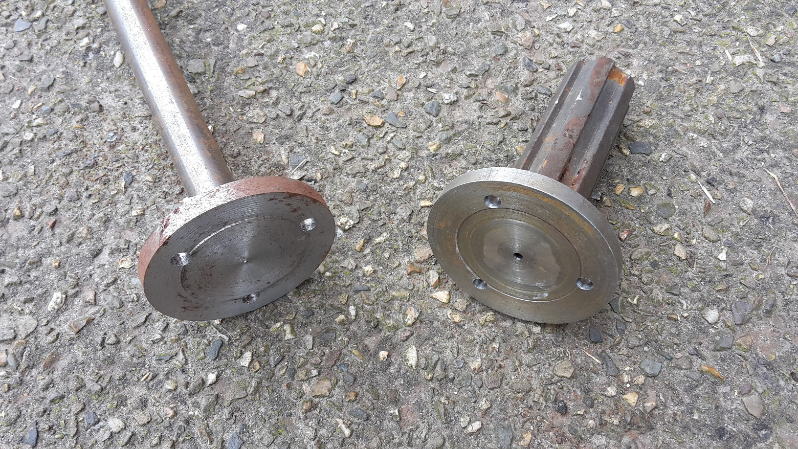

Hi,
I want to weld this piece of pto axle to a smaller rod (0.63 inch). Is there a technique to line out the axles of the pieces so they are lined up ?
I have no lathe.
Suggestions are welcome

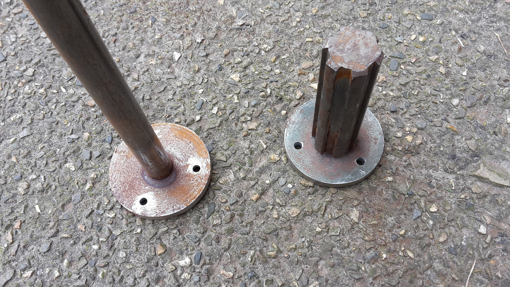

Ok it has been a while but someone I know (who has a lathe) was so kind to jump in and help out.
He even replaced my S235JR bar with some C45 shaft bar without any charges !
I think he did a perfect job, I am very satisfied with the result !
