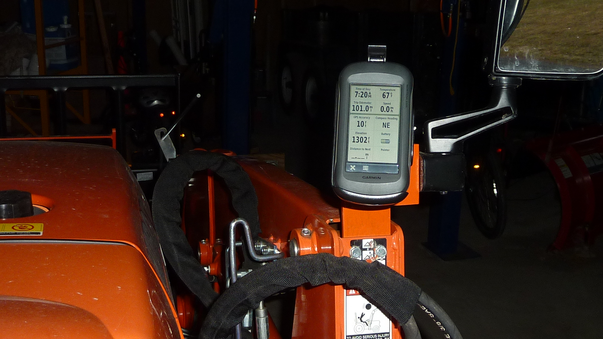

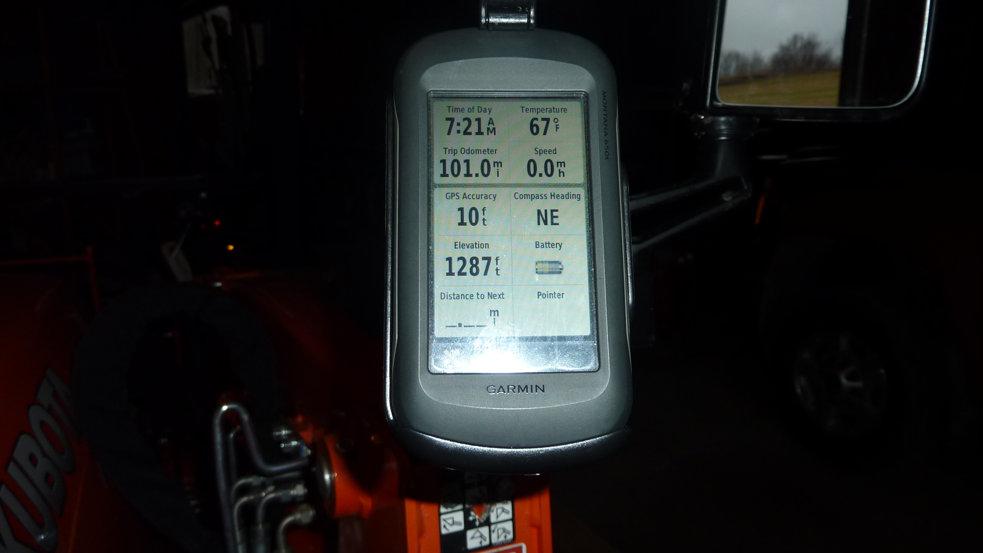

I use my handheld Garmin GPS for this purpose and made a tractor mount to hold the device. It reads speed to a tenth of a MPH and distance to within 10 feet depending on tree cover. The GPS also provides other useful information such as time and temperature.

I have a plug-in NUVI-57 Garmin for the truck. Suppose that has the same info?
   / How to know MPH travel speed with B7800 hydro? #7
I haven't had much luck with the vehicle gps with speed accuracy, when I tried my garmin it was somtimes a couple mph off, not bad when driving but too much for low speed imo.
   / How to know MPH travel speed with B7800 hydro? #8
The Nuvi-57 is mainly an automotive unit. Although it will help, as TMGT says, the speed accuracy isn't that good. You would also have to rig up a power outlet for it. You are better off with a handheld unit which has better slow speed accuracy and the ability to customize the display. These units are designed for slow speed hiking use. You don't need an expensive model, you can get a basic hiking or biking model for less than $100. On eBay, used ones are going for much less. With a handheld, you don't need to wire up a power outlet. Just use rechargeable batteries which in my case, last for a couple of weeks on the tractor.
