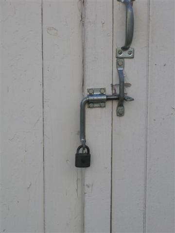

first let me post a couple of pics. First one is of the main barn door. It shows the catch I need to open from the inside.♠
Second pic is the side door which opens right across from the shop. ( on left in third picture)
As you can see, i go from the shop to the main barn threw the side door all the time, and I can not open the main door from inside. I need to come back out and go around to the fount to open the latch.:( Surely there is a way to open this latch from inside. Remember the doors slide, so there can be nothing that sticks in to the barn as sliding it would tear it off, or the door wouldn't open.
Iron Horse's idea is good, but I am not sure that I could unlock this one from inside either, and I don't think it would modify well to 3/4in barn siding. :(
Ken's idea is a good one for the other doors that I need to keep from blowing and only open occasionally, but again needs to be done from inside, and couldn't open from outside. :(
Qrtrhrs idea is excellent and I used these on the rears door which i only open in rare events, and they work great. :)
I am kind of in Knute's situation as I do have to walk back around thoughthe side door to get out to open latch.
As for the side door latch, in the picture it shows a lock in the hole for the ♦unlocked position. I keep it there so it doesn't get lost, and it is there if I need to move it to the other hole in the latch to lock the barn. Granted not much protection, but works in my situation.
Thanks for all the ideas, and keep em coming.

put a latch like you have on your second picture on the inside of your double sliding door and take off the hook on the outside . Then add the latches like qrtrhrs showed in his pic to the ends of both doors . That's how I did ours anyway .

Wouldn't I have the same problem with that type of latch only from the outside? I wouldn't be able to open from the outside to get truck out. Or am I missing something?
Don't have to keep the hook and eye, just need something that I can latch and unlatch from both inside and outside.
thanks.
/ How to keep barn door fastened #11
Drill a hole an inch or so above the hook,run a string through it to the hook,pull the string, the hook lifts.

I like this idea since it's kind of how I think - cheap, easy & quick.

Good idea, and will certainly work. Like Frog said-Cheap-easy-quick. Thanks.:D

dapper, I have a friend that "hides" in his shop by locking the door with an outside hook & eye. The pivot bolt for the hook is welded to the hook and extends thru the door. An elastic nut on the inside keeps the bolt tension and an attached knob turns the bolt raising the hook. The casual observer would think it impossible for anyone to be in the shop with the door locked on the outside.
My sliders lock from the inside with a hasp on the outer edge of each door and another where the two meet. I drop in bolts instead of locks. MikeD74T

Mike, Like that idea! Weld the hook to the eye, turn the eye. Think I can make that work. Cleaver. Don't think it will fool many here, as I am in the next barn anyway, but it will sure keep the door closed, and latched, and allow me to open from either side. That is the whole point of this post. opening the door from either side.
