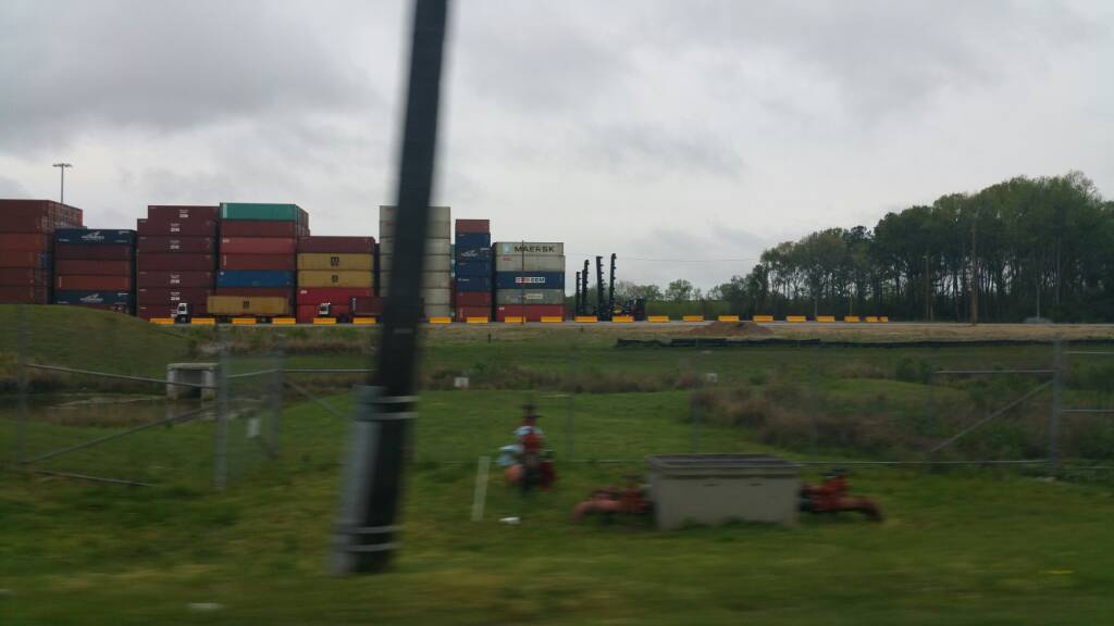

uploadfromtaptalk1459286953408.jpgThese are some containers at the local port. Sometimes they are stacked 9 high. And you thought your forklift was big. uploadfromtaptalk1459286999747.jpg
