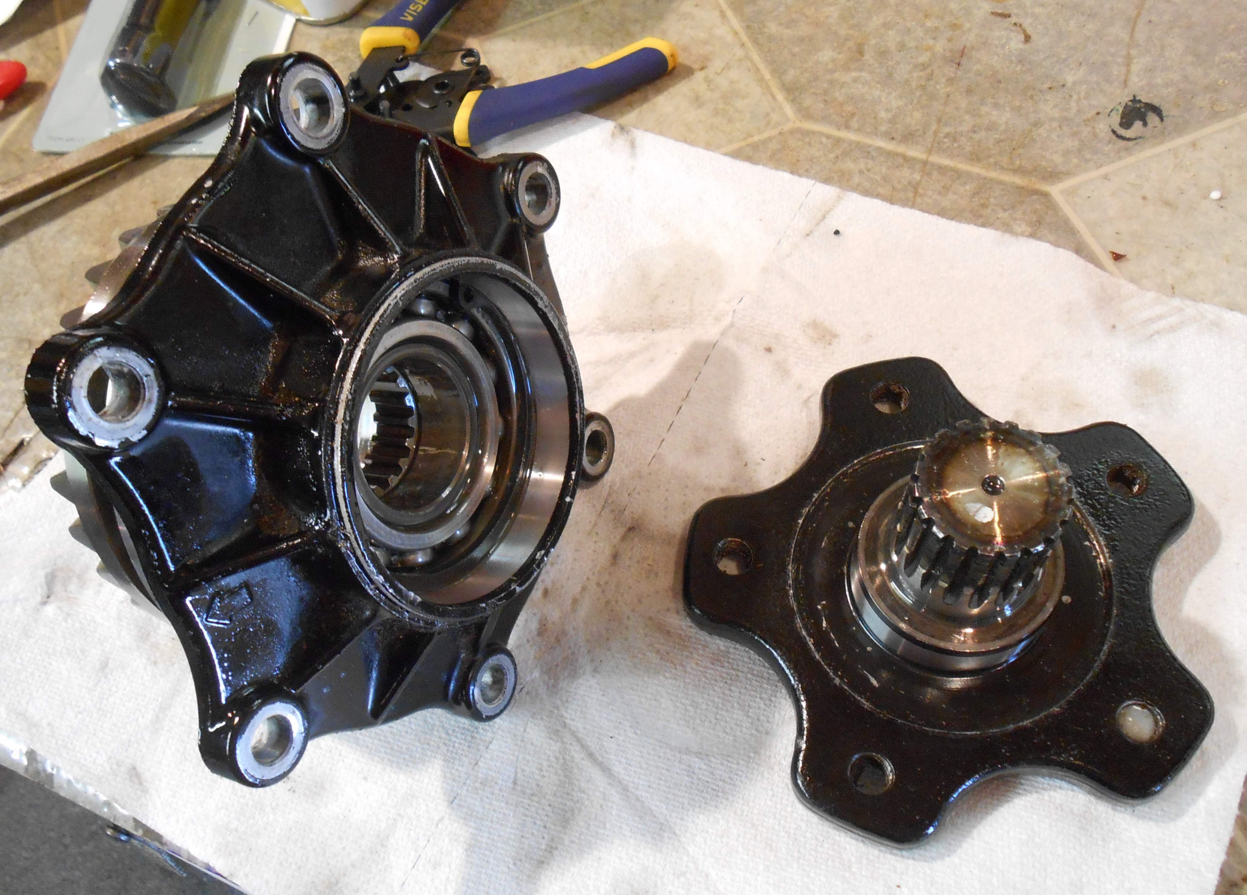

clean the area around case before removing the 6 bolts.
place a pan under the case to catch the oil that will drain after removing the case.
after removing the case pour the small amount of oil thats in the assembly into the pan.

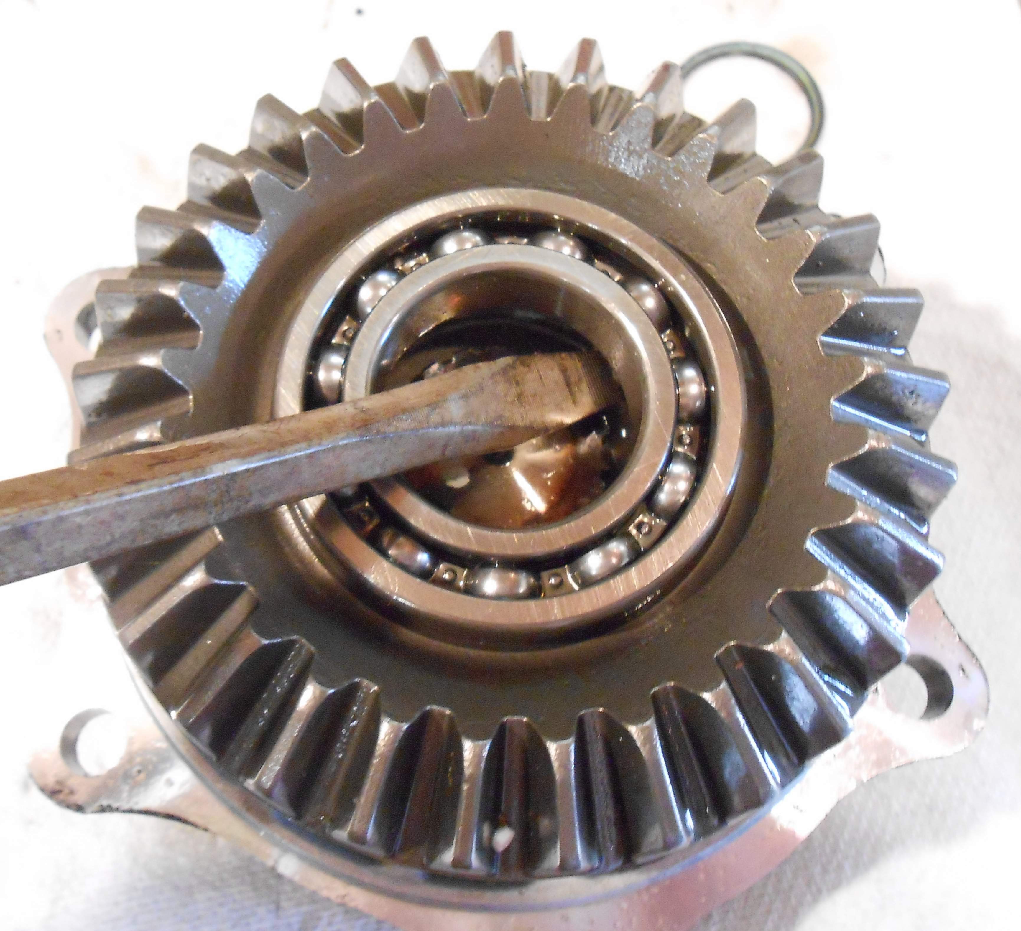

after 2 hours place it on the bench bearing upwards. use a large screwdriver and put the end on the shaft and twist it upwards so it comes in contact with the inner part of the bearing. keep rotating and twisting working the bearing out. its a snug fit.

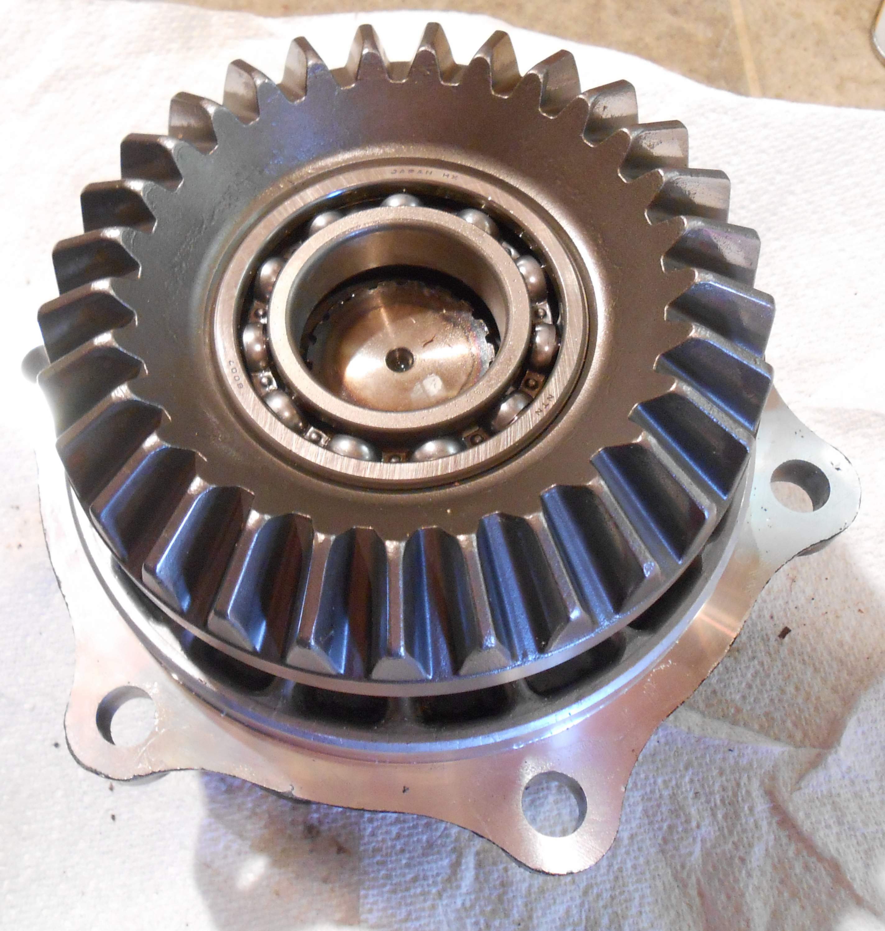

next remove the snap ring on the end of the shaft and push out the shaft with your fingers. Its a little tight.
Pry the sleeve off the spindle shaft with a screwdriver.

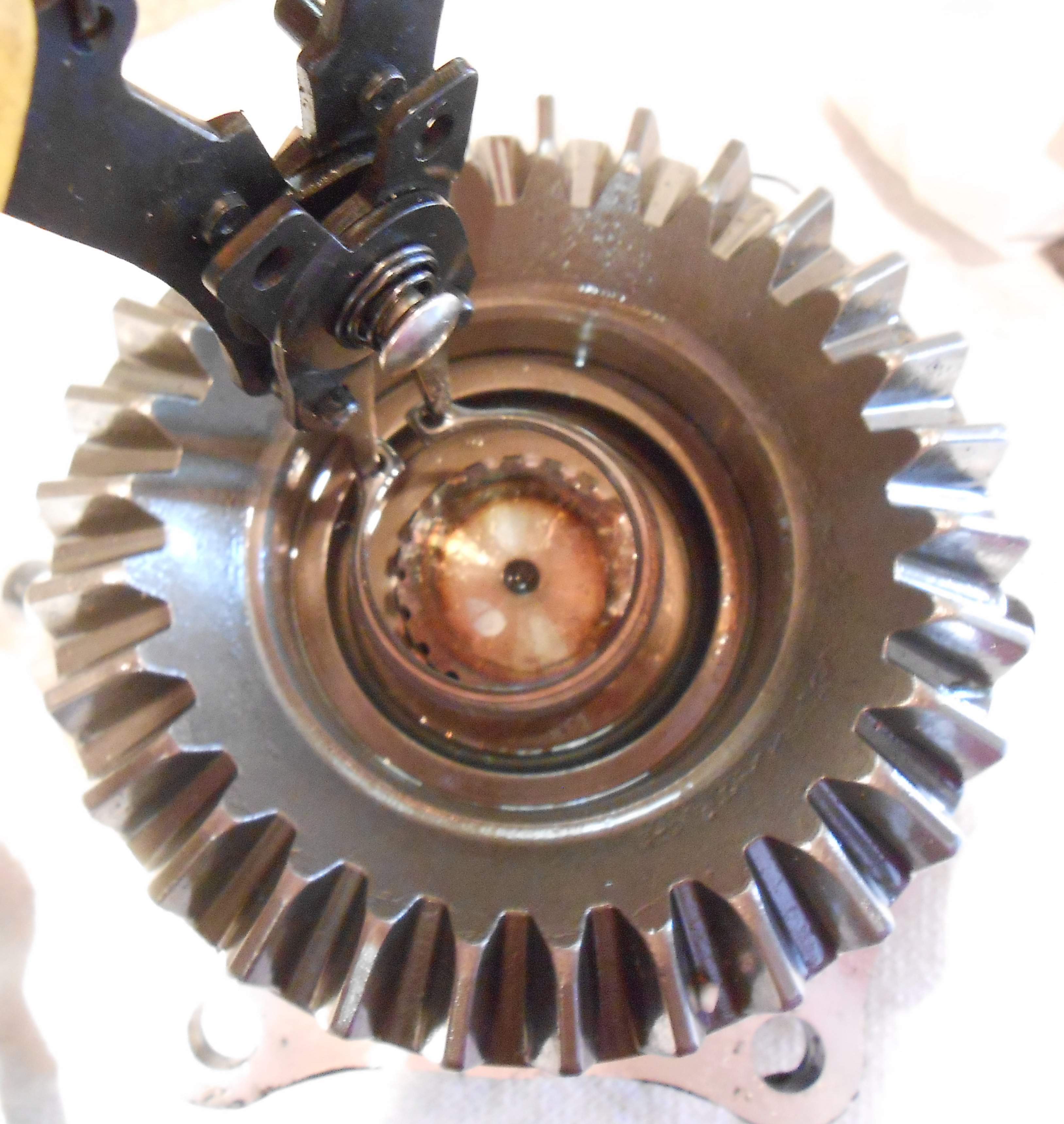

used channel locks to pull the seal out. you cannot drill it and put screws in it. metal under the rubber and the shavings will get into the bearing below.

put oil on the seal, with the spindle shaft facing upwards slide the case onto the spindle.

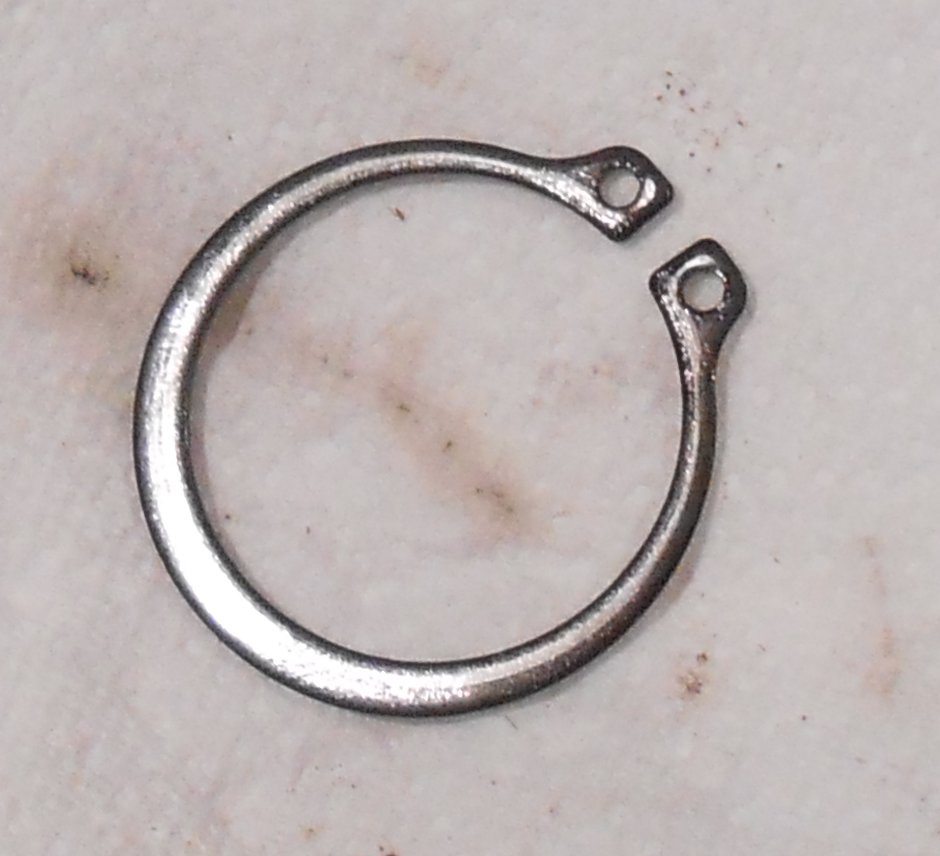

install snap ring. (note the the ring is larger on one side so it looks like its not all the way in)
get the bearing out of the freezer and it will drop right in.
