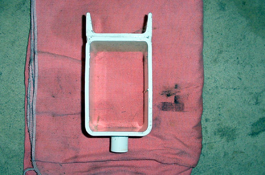

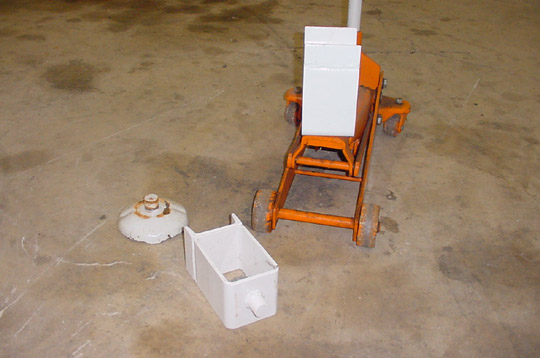

Those are interesting... what are those and where did they come from ?
The top is made from 4" channel. The center section is made from 4" x 6" tubing. The bottom is made from 1-1/4" bar stock, but you change this to suit your floor jack. All came from 'scrap' bin at work. Philip.
Nice work.....
