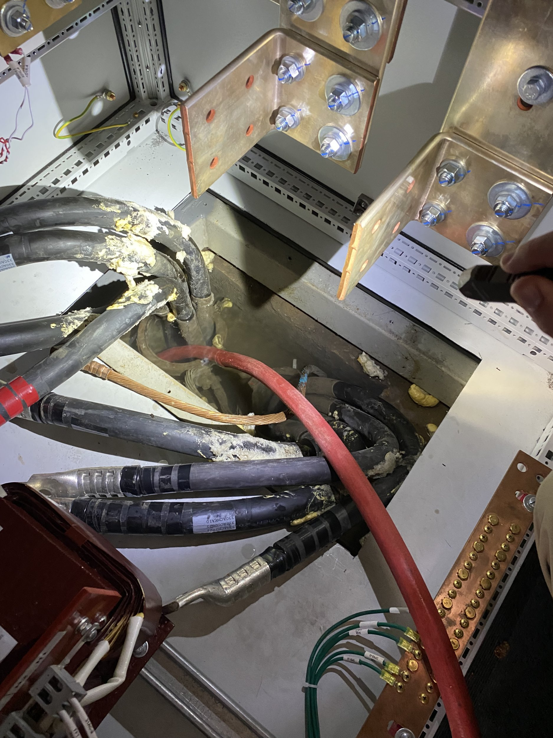

Here's a good way to ground.

It's hard to see the water but the red hose is to pump the water out with. Sorry. I had to post this since we just found it.
