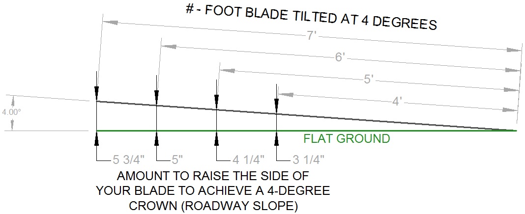

IIRC 4 degrees is a pretty standard road & driveway slope aka crown angle, which equates to tilting a 4' blade 3-1/4", 5' blade 4-1/4", a 6' blade 5" and a 7' blade 5-3/4".
Put your tractor on flat ground & tilt your blade until the high side is above the ground by the applicable amount I've shown.
attachment.php
In many cases the first time (few times) you grade with the blade tilted like this, only the lower corner of the blade will actually touch the ground, until eventually after a number of passes your crown fully develops to where the entire blade contacts the ground most of the time. This is where an angled blade also helps: It directs the material removed from the lower corner of the blade toward the middle of the road where you want it to be higher.

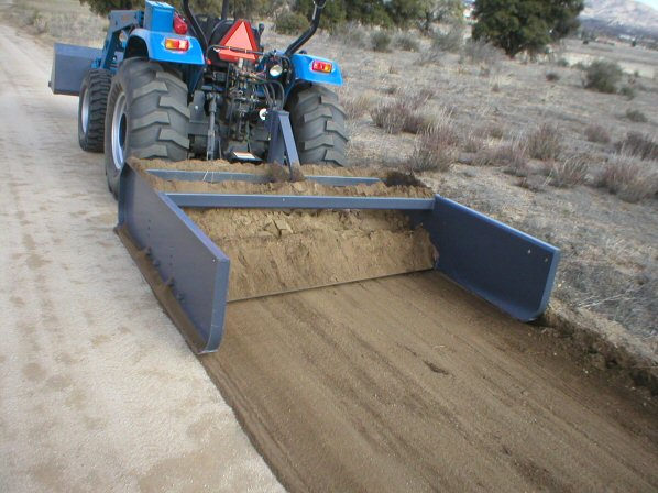

I have been researching a Land Plane and used ones are very hard to come by. The Frontier LP1160 runs 1290.00, I have also found a couple of nice 6' box scrapers for around 500.00 and could probably unload my rear blade pretty easily to help offset the price.
I would guess that's because they work great :thumbsup: It takes to search & find the right threads, but you can read about the satisfaction of other owners on here. Can't recall a single negative response. It levels dirt so well, I've thought there must be more required of me than just dropping the plane on the ground & driving.
No need for a box blade anymore for me. It doesn't do exactly what a box blade does, as far as moving one bigger pile of dirt at a time, but close enough that I just don't need a box blade.
It is longer, so takes up more room in storage & when turning.
Knowing my main goal is to keep my driveway smooth, which would be the best one impliment to have?
Except for getting an actual road grader, the land plane will definitely do the job better than a box blade. Set the tilt angle & go. "Grading for Dummies" (like me!)
The John Deere Dealer was pushing hard on the Box scraper over the Land Plane.
Could be that he's never used a land plane. My seemingly very knowledgeable, experienced tractor-repairman-turned-tractor-salesman (boss said he had to) said he never had used one or seen one used. He wanted to see mine in action but so far we've never met up.

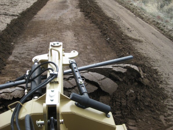

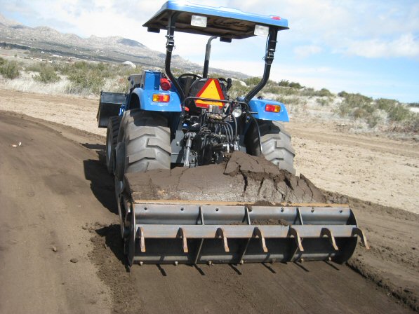

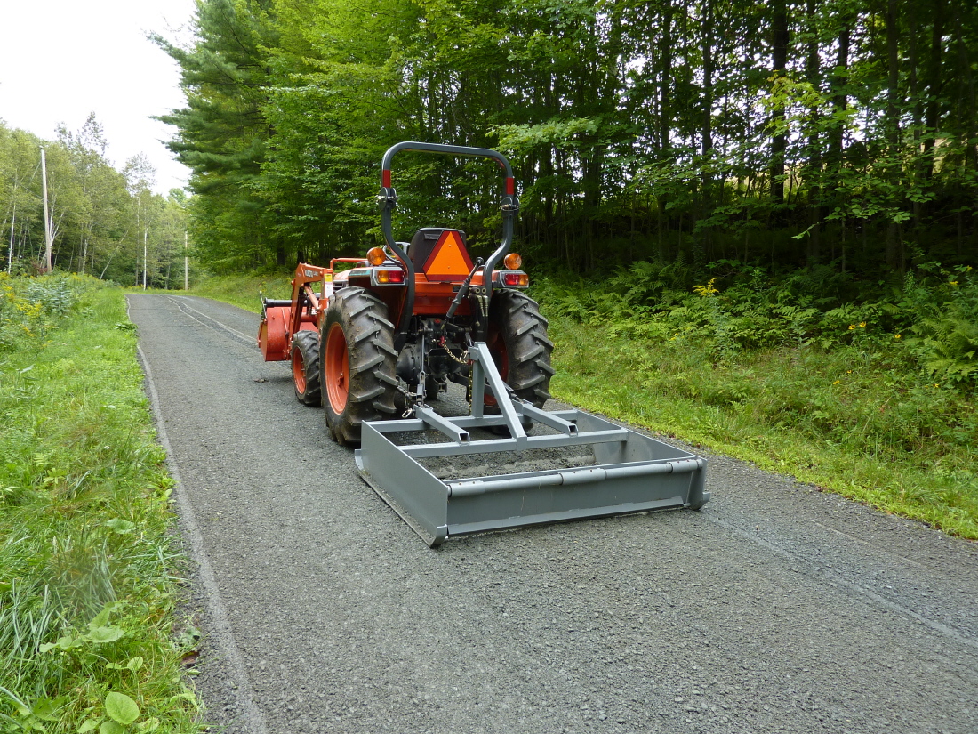

I believe this would be the next step up above a land plane (aka grading scraper), if you care to get more serious/ spendy:
   / How to grade a driveway? Need help please #39
I maintain over 2 miles of roads-drives. I have the 4 most common implements that people use on their roads. A box blade, a rear blade, a landscape rake and a land plane grader blade. IF I could only have one of these implements to maintain our roads with, it would be the LPGB hands down, no question what so ever. ;)

For me that is a hard question. For ten years I maintained my road with nothing but a rear blade. It did everything I needed. Then I built a land plane grading scraper. It is now by far my most used road tool and you can see it does a great job on all parts of my road which has a lot of variation in its make up along the way. But at times I still need or want to use the old rear blade to adjust the contours in the spring or after major storms.
