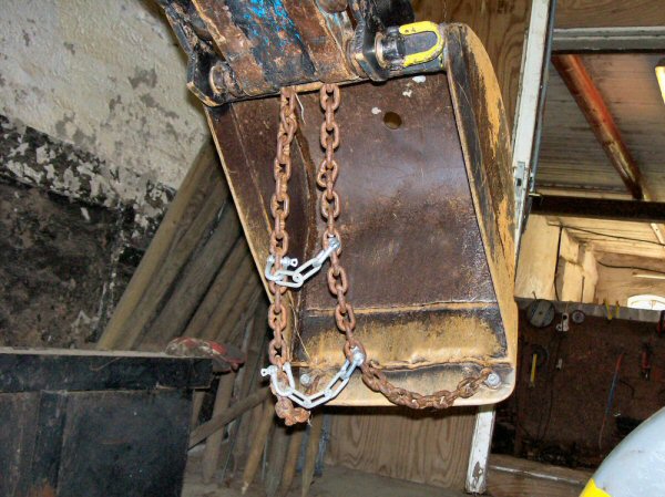

It seems like someone could invent something like a thumb that would set inside the bucket and then push the clay out when dumping.
This is the idea behind chain option in the above post.

I'm having trouble visualizing how the chain method is set up.
   / How to get clay out of backhoe bucket? #14
It seems like this would work well when you are digging up fairly dry clay, but my clay is so damp and gooey that it just sticks back together again.
This is from another thread.
   / How to get clay out of backhoe bucket? #15
It is something. I had saw before. I have never went through the trouble myself but it will bust out the clay when you extend the bucket all the way out by tightening the chains.
Here is a pdf with pictures and instructions from another member (fisherridge) 7 years ago;
