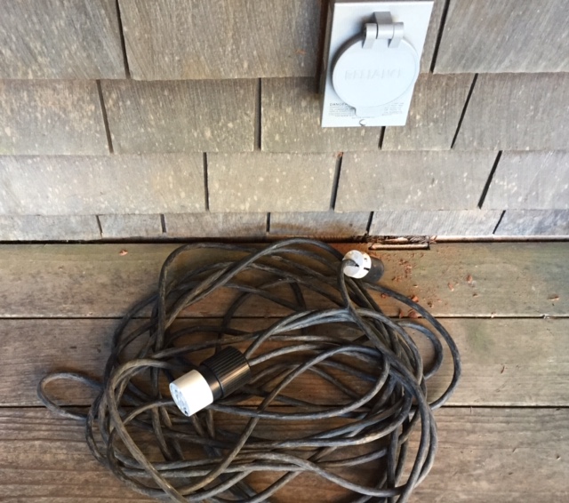

   / How to generator power pass through to inside the house. #5
I run a 2200w Honda during the night. The outside wall connection is a standard generator input plug. Inside on the other side of the wall is two duplex outlets. I run extension cords to the fridge, a couple lights, electronics, etc. Not very elegant but it works and the little generator will go 10 hours on a gallon.

   / How to generator power pass through to inside the house. #6
This the the way to do it. Unfortunately the suggestions above this post are either illegal, dangerous and or won’t work properly.
The next step above this involves some panel work and an interlock or transfer switch. All this sounds like more than you want to do.
