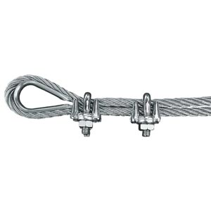

I have this choker cable that I would like to put a loop or something that I can hook a chain to but not sure how to fix it with a loop. Any ideas?
/ How to fix a choker cable? #4
If you use the wire clips... Remember, "Never put a saddle on a dead horse... " Meaning the u-bolts should be on the dead end of the wire rope loop.

Wire rope clips pictured earlier would work if you saddle them right.( use two spaced slightly appart from each other.
they are cheap
I have swagging tools to apply wire cable ends.
you can purchase threaded ends, sleves balls....
if you have a contractor in your area with swaging tools that will assist you I included links to a wide variety of end available(eyelet,threaded...)

I've used a cable thimble with a couple wire rope clips. View attachment 289438 A picture from farmtek.com
If you work with cable or wire rope it's good to have several of the wire rope clips and thimbles around. I view them as useful as clevis pins, linch pins, lock pins etc. I've used them and reused them, effectively adjusting the link of cable needed.

I agree, but for somethings I need to bind chain doesn't get small and flexible enough. You do need the thimbles to make sure there are no sharp bends.

These gys are right! If that cable fails, it can cut you in two faster than a Ginsu knife through a piece of cheese.
"OSHA" would not approve of the jimmy rig setup, but more importantly, your life and and the of yur workers are at stake.
When our winch cables fail, we buy new, AND make sure there are at least 5 wraps on the drum!
