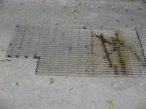

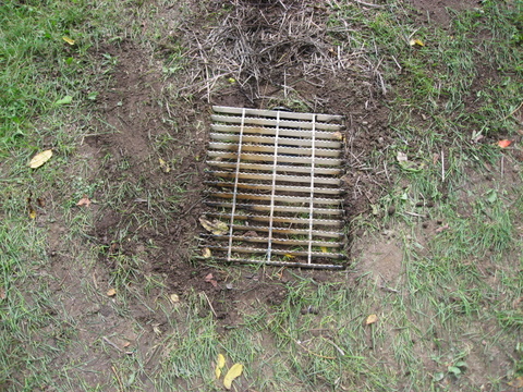

UPDATE
OP here. Thanks for all the great suggestions and comments.
I decided not to run the surface drain through the french drain pipe. Instead I ran a second pipe in the same trench then tied them together with a Y fitting just before the exit. I was warned that the surface drain would distribute water through the perforated pipe exactly where I am trying to eliminate it. Made sense, so two pipes most of the way.
I went to my favorite scrap yard looking for a ready made grate and spied a nice piece of catwalk. It has a grippy surface. So I cut a rectangle and laid it over the cut down plastic pipe in a recess in the soil. I did not stake it, but will if the grass growing through it doesn't hold it tightly. Last picture is before I cut down the pipe.
