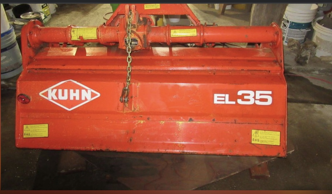

Thanks guys. Here’s a pic. Seller says it’s only got about 20 hours on it. But I believe it’s a discontinued model from the manufacturer.

Kuhn is a reportable brand. They even make implements for JD repainted green... Look at the tines to see if the seller is being straight up or not. Worn tines equal lots of hours.

Like others said Kuhn is a great brand. If the tines are good I'd buy it

As others have said Kuhn is a know, reputable brand. Check gearbox oil for the amount and color (water contamination) and tines - although they can easily be replaced. If worn doesn't always mean lots of hours, could have been used in dry hard soil; my experience. But the picture looks like it's a good machine to bet on.

Check the 2 tines on each side that are closest to the depth skid shoes. If the ends of those 2 tines come to a point, it has a lot of acres on it.
Check the slop in the chain by holding the pto still with one hand and rock the tines forward and backward. If the tines move 4 inches or more, the drive chain needs tightened or replaced. If you feel or hear something in the gear box while doing that, it's not a good thing.
That's about it, other than cosmetics.

Just by looking at it you can tell it doesn't have a lot of hours, and it wasn't abused, the paint is barely flaked off on the flap, all the warnings are still there even the reflector on the left is there... most tiller only operate a few hours a year so its pretty hard to go wrong... nice find ... it be worth changing the oil in the gear box and remember to grease the CV's joint every time you uses it.

I've had the same one for about 20 years that I bought used. It was lightly used on sandy soil.
Gets maybe 5 hours a year with me.
They do a great job with few problems.
Grease the U joints and the grease zerk on the side, check the oil in the gear box. You know, the regular maintenance stuff.
Most of my tines are still good but two need replacement after hitting rocks.
Happy tilling.
